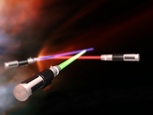

I was a bit inspired by Episode II, so here's a quick model I did the other
night..It's supposed to look like Yodas saber, which I found some pictures
of on the net.
I got the media ideas for the blade by looking at a scene file (sabre.pov by
Kenyon Banks) I found in the newsgroups.
So far all the sabers are the same..likely to change if I get the time. The
background is some hubble picture I came across..
-Peter
Download 'lightsaber.yoda.jpg' (14 KB)
Preview of image 'lightsaber.yoda.jpg'

cool
how did u do the blade?

> cool
Glad you like it!
One small cylinder in the middle filled with media (I_Blade2) and a large
cylinder also with media (I_Blade).
I'm not satified with it yet..I'd like the places where the lightsabers
cross to bercome white, not a blend of the two colors. But I haven't used
media much, so I don't have a clue on how to achive that.. something to do
with absorption?
Here's the messy code:

>             color_map{
>             [0 rgb CLR transmit 1]
>             [1 rgb CLR transmit 0.8]
transmit doesn't do a thing in media.  You should use:
color_map {
    [0 rgb CLR*0]
    [1 rgb CLR*.2]
cu!
ZK AKA SaD
Wanna bet?  Try setting transmit to 1.5 or something...;)
Tim Cook
Must be a POV-Ray 3.5 thing then, cause it doesn't do anything in MegaPov
0.7
