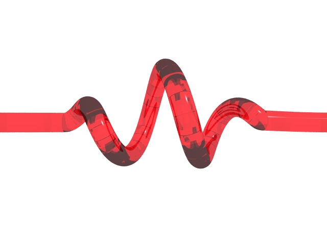

Cheap_Sweep.inc file should be posted to p.b.s-f by the time you read this.
Regarding this demo-pic. I have seen this type of knot before and was able
to figure out the function. I want to post this function for others to use
and would like to post it with the correct name. Does anyone know the name
of this function?
Feedback regarding the readability of my *.inc file would be *greatly*
appreciated. I spent literally 3x the amount of time commenting and cleaning
up this file as I did getting it to work. I have made the file very easy to
take a quick look at for any who would be willing to do so. There is a
sample file at the bottom, so there is no need to create macro input in
order to evaluate the macro.
It's should be worth downloading anyway, as it is a cool little macro.
Thank you,
 -Shay

I found a mistake.
line 92
#write (Sweep_Out, " cylinder {", Previous_Vx, ",", Next_Vx, ",", RADIUS,
"}\n")
should read:
<snip> Prev_Vx <snip>
If the macro seems to be posted twice in p.b.s-f, it is because I am
canceling my original post and replacing it with the corrected file.
 =Shay

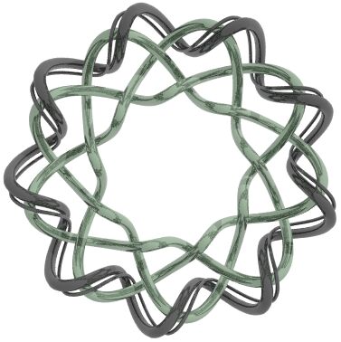

Well, to be annoyingly honest, I think I will leave macro writing and
maintenance to those of you who can understand it.  My brain barely
generates enough power to keep my mouth flapping, lord knows what would
happen if I had to think as well...
I'm just going to use it to make pretty pictures and let you know if
something doesn't seem right.  So far it seems wonderful :-)

If the black banding in your spiral is not desired, using merge and placing
a sphere where each piece meets another will solve the problem.
I thought about adding a switch for this. I also thought about adding a
No_File and No_Image switch, but I decided against these things, as I would
only be obscuring the algorithm.
Instead, I chose to break the code into sections and leave lots of notes so
that others can quickly add these things if they so desire.
Thank you for your interest.
 -Shay
