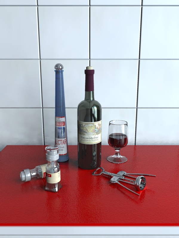

I'm trying to get the lighting right for my kitchen scene. This is an early test
render.
No lights were used, just pure radiosity. I couldn't use better settings for lack of
memory.
Render time (with MUCH swapping): about 7 hours.
The grainess of the red cupboard was enhanced by the jpeg compression.
I will probably use a warmer light for the final scene.
Cheers,
Jonathan.

well done.  good sense of realism here.  you could increase max trace level
maybe to get rid of blackness around the glass.  of course it wouldnt
exactly help your render time.
and just swap the wine for a bottle of the finest macallan scotch whisky. oh
aye :)
john

in news:3ca4a9b0@news.povray.org JRG wrote:
> This is an early test render.
Looks very good,
although it is a test run a few minor comments, the finish of the red
stuff on the top of the wine bottle doesn't look good, too dull. The
cork is too bright, unless it's one of those cork faking plastic corks.
The colors on the wine bottels lable look a bit washed out, as if a
gamma correction is applied twice. It's not in harmony with the rest of
the scene. For the wine glass have you scaled the wine smaller than the
glass? If so, try scale it a bit bigger than the glass, it may look more
natural.
Couldn't resist what I usually do with photos, cover parts of them with
white paper to change / improve compostition. Result, cropped the image
to about 510X670 counting from the top right hand side. It chops of the
top of the bottle on its side and brings the left hand side of the wine
bottle to about 1/3 of the image.
Ingo

Great setup!  :o)  But two questions I have:  How could you render this so
quickly when there is blurred reflection and glass in the scene? I thought
it would be impossible. And how much memory is in your computer?
I think the light from the window is from a cloudy day. Because it's not
possible to have sunlight and pure radiosity - it will lack specular
highlights... Am I right?
Best regards,
Hugo
Thank you.
Actually that blackness is caused by radiosity. I find max_trace_level 20 adequate
for this scene.
> aye :)
De gustibus non est disputandum...
Jonathan.

"ingo" <ing### [at] homenl> wrote:
> Looks very good,
Thank you.
Yeah. It looked good with lights and highlights.
>The
> the scene.
I will de-correct (sp?) the original map.
> natural.
Yes. It's just a bit smaller than the glass. Does it look wrong?
This didn't mean to be a good composition. I just put together some of the objects
modelled to see how they looked with these specific light conditions.
Jonathan.

"Hugo" wrote:
> Great setup!  :o)
Thanks!
Huh, I don't know...
> I thought
Not much, too bad. Peak memory used: 126 MB. Memory available at the moment: only 128
MB. I will buy some more RAM next week.
Yes and no. You are right that it must be a cloudy day (or a cloud is temporarily
covering the sun). But that does not imply a lack of highlights: the sky is still
much brighter than anything around.
Jonathan.

From: JRG
Subject: Re: Radiosity test (~110 KB.)
Date: 30 Mar 2002 08:00:15
Message: <3ca5b6df$1@news.povray.org>
"George Pantazopoulos" wrote:
> Jonathan,
>     Incredible pic, you obviously put a lot of effort and care into your
> work. I can only hope to get as good as you are!
Thank you very much!
> Would you please let me
> know what you use for a modeler (if you use one), and any other relevant
> details for this pic?
> Thanks,
I normally do not use any modeller. If I have to, I go with Hamapatch.
There's not much to say about this scene:
-the ouzo bottle is simple CSG.
-the wine glass is a lathe object.
-the corkscrew is CSG+blob+isosurface.
-the body of the pepper jar was modelled in Hamapatch. The cap is CSG.
About the lighting: I indeed cheated here... but the trick isn't hidden that much.
You can figure it out yourself... ;-)
Jonathan.
Home: http://digilander.iol.it/jrgpov
From: ingo
Date: 30 Mar 2002 08:36:28
Message: <Xns91E194FE17C9Cseed7@povray.org>
The glass looks thicker than it probaly is, this is due too the air
between glass and wine. There are internal refelections in that air gap.
Scaling the wine bigger than the glass removes this phenomena.
Ingo
Date: 30 Mar 2002 20:01:22
Message: <slrnaacnbi.29c.steve@zero-pps.localdomain>
> render.
> memory.
Looks excelent, but the wine glass looks asthoug it's got a refletcive
coating on it just like the wine bottel.  This reflectiveness looks ok
on the bottel but not so much on the glass.
sphere{z*5,1pigment{rgb.5}finish{reflection.3specular.5}}box{<-50,-3,-50>
<50,-2,50>pigment{checker/*\__\\__/  * \_\\__*/scale 2}finish{ambient.7}}
light_source/*__\\__\\__\\__\\__\(    ~ )\__\\__\\__\\__\\*/{<2,5,1>*4,1}
/*\\__\\__\\__\\__\\__\\__\\__\\__\~  -/__\\__\\__\\__\\__\\*//* Steve */
