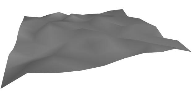

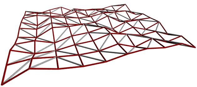

Two pictures here. The first is a wire frame showing how the different
vertices each have 2 to 8 triangles including them. The second is a picture
of the smoothed mesh.
 -Shay
Download 'Irregular_Mesh_WF.jpg' (33 KB) Download 'Irregular_Mesh.jpg' (7 KB)
Preview of image 'Irregular_Mesh_WF.jpg'
Preview of image 'Irregular_Mesh.jpg'
Wow, you did it!!  :o)  That's great!  I already had a look at the
sourcecode. It is well-documented and understandable. I like the long names
to variables. Your idea is a much better approch to the many different
states of a square (2 to 8 faces).
Now I'll try to implement it to my code. I create the faces prior to
deciding which case [/] [\] to use, so this shouldn't happen twice. The
output should be mesh2, but I think I'll easily solve these things.. I'll be
back after a closer look..
I have a working code now, it can't go fully wrong!  :o)
*Thanks!*
Hugo
names
Sometimes it just takes another set of eyes looking at a problem.
be
> *Thanks!*
Glad it helped. As far as converting to #mesh2. The vertices and normals are
already in arrays, so there will not be any problem writing it out as
#mesh2. I used #mesh because it is easier for another person to read.
I'm looking forward to using your final macro. I experimented last night
with dividing all of the squares with one or the other case, and it does
make a very big difference.
 -Shay

Well, you can check my investigation in
http://news.povray.org/f4sa5uomgj1v158rjs159ms75midq7qm52%404ax.com
that function is fastest way of calculations
> The method described by ABX is necessary only for non-square meshes.
I can be wrong becouse I not studied your sources enough but looking at
pictures on http://news.povray.org/3c84365e%40news.povray.org your triangles
are non-square. Only projection onto xz plane (considering y is up) are
square.
ABX
triangles
> square.
OH DAMN!!! I really screwed up. I was only thinking about elevating one
vertex in ... (well, not important what I was thinking).
I will implement the method you outlined ASAP. This is really going to slow
the macro down, but as long as you're writing out the results for possibly
hundreds of renders, you may as well get the best results possible.
 -Shay

Message: <3c867a5b@news.povray.org>
Very good. Let me just add that I'm going to turn the heightfield data
around lathes and let them follow the path of splines. I don't know if this
is going to break the non-square type of mesh. It's still a grid. But these
turns will, of course, happen before normal calculations.
