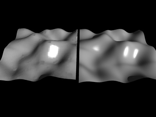

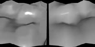

How does POV-Ray smooth height_fields?  The results aren't really good in
any case.
At the left is an ordinary smoothed height_field, at the right the same
shape using smooth_triangles.
Wouldn't it be possible to use a better way of smoothing height_fields?  As
it is now, the smooth-keyword in height_fields isn't really useful...
cu!
ZK AKA SaD
http://www.povplace.be.tf
"You know what they say: No good deed goes unpunished."
Download 'heightfield.jpg' (16 KB)
Preview of image 'heightfield.jpg'
I'm surprised the left result is so bad. But how did you make the right one?
Probably the difference is that more normals are averaged.
But you see, I'm really *fighting* with a macro to calc normals to a
triangle heightfield.. It's crazy, I code as "clean" as I can, and week
after week I return to my code to find the bugs, but ...argh... I know how
to calculate the normal of a triangle, but my macro construct the
heightfield in a (better) way that means, sometimes there are 3, 4, 5 or 6
faces connected to a vertex.
Any help will be appriciated!  It's a macro that I think would be generally
useful to many people.
Hugo
> any case.
I can't say for sure of course, but those two shapes really don't seem to
have the same geometry to me.
Believe me, they have :)
They're both the bozo-pattern on the xz-plane from x=0 to 1 and z=0 to 1.
cu!
ZK AKA SaD
"The only thing that helps me maintain my slender grip on reality is the
friendship I share with my collection of singing potatoes."
From: Zeger Knaepen
Subject: Re: smooth height_fields
Date: 2 Mar 2002 13:04:54
Message: <3c811446$1@news.povray.org>
so am I...
2 while loops.  The first one calculates a matrix of locations based on the
bozo-pattern, which is then used in the second loop to place triangles and
calculate normals.
maybe, but it almost looks like it just runs a smooth-filter on the final
image.  You can still see the edges of the triangles, but they're blurry.
Actually an interesting effect, but rather useless imho.

That's not what i meant, the triangle vertices need to be the same for
comparable results.

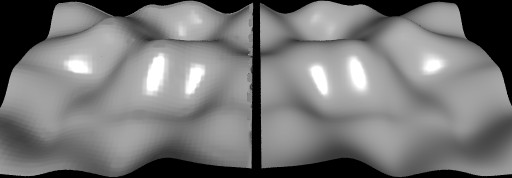

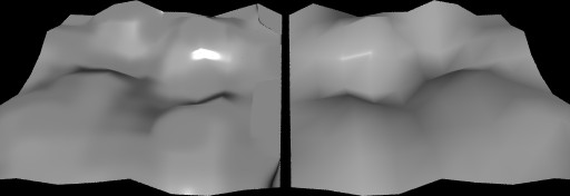

Maybe it's easier to compare this way: I mirrored one of them and moved the
light.
cu!
ZK AKA SaD
"we will make spears twice as long as a man, but some men are longer than
others"
Download 'heightfield2.jpg' (15 KB)
Preview of image 'heightfield2.jpg'

This obviously does not change anything, to really judge whether the
heightfield smoothing is broken would require perfectly identical
geometry.

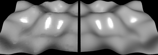

I really don't understand what you mean.  These two object have exactly the
same geometry, haven't they?  They are derived from the same pattern, they
have the same shape, the same height, and in this image the same shading,
only the way they are smoothed is different.  If you still don't believe me
this 2 objects have the same shape, maybe I should post an unsmoothed
version, then you'll see they are exactly the same (which they should be),
but with smoothing, they are not (which is not good of course :)
Hmmm, I just rendered this, and they are indeed not exactly the same :)
Oh, I see, I forgot the hf_gray_16 in the height_field.  Here is the
smoothed version *with* the hf_gray_16.  Still rather ugly compared to the
right one, I think.  But this time the unsmoothed version seems to be
exactly the same!
cu!
ZK AKA SaD
"Brace yourself for a bit of a shock, Lister, but I just saw you die."
Download 'heightfield3.jpg' (15 KB)
Preview of image 'heightfield3.jpg'

if that is true, the geometry of my own height_field-like object still isn't
the same as the real height_field.
But, Christoph: *if* it's true what Hugo says here, the results of the real
height_fields should be *better* than those of my own version, which it
clearly isn't.

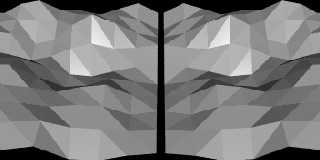

From: Zeger Knaepen
Date: 2 Mar 2002 14:51:07
Message: <3c812d2b@news.povray.org>
> I would suggest you render a lower resolution version without smoothing so
> you can see the single triangles and compare the results.
Ok, they are not 100% the same.  But close enough.  The smoothed versions
should not be that different.
I made a mistake in my scene.  The height_field had a resolution of 1 less
than the other version.  I fixed it, and now they *really* have the same
geometry, as you can see in the first attached image...  But still, the
smoothed height_field doesn't look as good as it should, as you can see in
the seconde attached image...
cu!
ZK AKA SaD
"I want my baby back, baby back, baby back ribs"
Download 'heightfield4.jpg' (19 KB) Download 'heightfield5.jpg' (12 KB)
Preview of image 'heightfield4.jpg'
Preview of image 'heightfield5.jpg'
Date: 2 Mar 2002 15:18:26
Message: <3C813380.CE5FC730@gmx.de>
All right, this seems suited for comparison, it's surely worth having a
look at the heightfield normal calculation code.
Last updated 21 Feb. 2002 _____./\/^>_*_<^\/\.______
