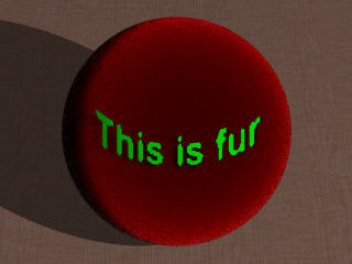

I used an IOR of -1 together with scattering media type 5 to create this fur
effect but I can't jugde if it is worth the rendering time compared to a fur
texture, so what do you think?

From: Slime
Subject: Re: media fur
Date: 7 Feb 2002 10:52:02
Message: <3c62a2a2$1@news.povray.org>
Looks like a very soft, fine, red fur. I want to run my fingers over it =)
The shading is realistic. Then again, I'm not sure if I'd know it was fur if
I wasn't told so. I think it's pretty good though.

From: oliWood
Date: 7 Feb 2002 11:11:23
Message: <3C62A729.8AEE1321@durham.ac.uk>
Looks like velvet to me.  Did it take ages to render ?
From: Zeger Knaepen
Date: 7 Feb 2002 11:35:16
Message: <3c62acc4$1@news.povray.org>
Looks good!
What's the rendertime?
cu!
From: bob h
Date: 7 Feb 2002 11:36:56
Message: <3c62ad28@news.povray.org>
"oliWood" <O.E### [at] durhamacuk> wrote in message
news:3C62A729.8AEE1321@durham.ac.uk...
Yeah gee, tell how long it took at least.  Not just "not sure worth the
time"  :-)
Looks fuzzy anyway, even if not exactly fur-like.  Nice idea.
bob h
From: Simon Adameit
Date: 7 Feb 2002 12:41:56
Message: <3c62bc64@news.povray.org>
if
> I wasn't told so.
Then perhaps you like this one more:
Thanks.

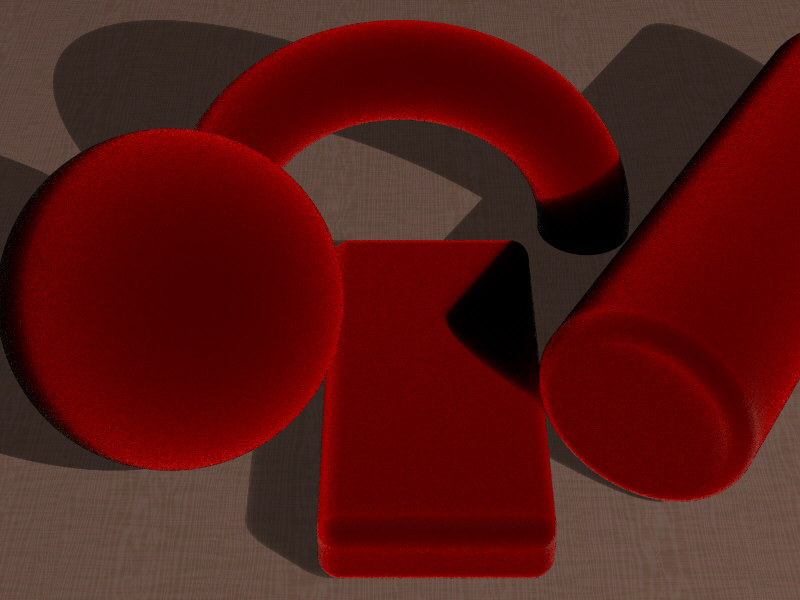

Download 'for slime.jpg' (11 KB)
Preview of image 'for slime.jpg'
From: Shay
Date: 7 Feb 2002 12:42:02
Message: <3c62bc6a@news.povray.org>
That would make a perfect jewelry box. Can't tell without a pic, but this
may look better in a close up than other fur textures.
 -Shay

From: Shay
Date: 7 Feb 2002 13:33:26
Message: <3c62c876@news.povray.org>
Since the render time is only a few minutes, I believe that this method is
worth the time in some cases. Your fur has a distinct look from other fur
methods.
The only problem I can see is on the csg items. If you used union, then
merge would probably correct the problem. If you are using merge already,
then the method has a definite flaw.
 -Shay

From: Simon Adameit
Date: 7 Feb 2002 13:41:21
Message: <3c62ca51$1@news.povray.org>
> methods.
Sorry, but I can't see the problem. Could you please point me to it.
From: Shay
Date: 7 Feb 2002 13:52:55
Message: <3c62cd07@news.povray.org>
Simon Adameit <gom### [at] gmxde> wrote in message
news:3c62ca51$1@news.povray.org...
On your rounded box and rounded cyl I can see the outine of the individual
CSG objects. Might just be an illusion or compression. I'm not sure. I
wonder if a superellipsoid would show the same effect.
 -Shay
From: Simon Adameit
Date: 7 Feb 2002 14:08:42
Message: <3c62d0ba$1@news.povray.org>
I've used merge so I think a superellipsoid would give the same effect.
From: Grey Knight
Date: 7 Feb 2002 15:08:56
Message: <3C62DED0.19AB857A@namtar.qub.ac.uk>
It really is more velvet than fur; you can tell straightaway.
Incidentally, that edging effect on the rounded objects I think occurs
in real life too. Should check that...
Excellent stuff!

From: Simon Adameit
Date: 7 Feb 2002 15:13:51
Message: <3c62dfff@news.povray.org>
Hey, I didn't even know what fur means. I just saw that all the others were
calling this fur and thought that it would be the right word but now where
I've looked it up I agree with you that it really looks more like velvet and
not fur.

From: andrel linnenbank
Date: 7 Feb 2002 17:26:00
Message: <3C62FE97.F02251B2@amc.uva.nl>
Looks great either as short haired fur or velvet.
I would never have thought of using a negative IOR.
To quote Vroomfondel on this: 'I think our brains must be
to highly trained, Majikthise'
But if the POV developers allows fysically impossible
values, who am I to complain.
    Andrel

From: Lawrence Winstead
Date: 7 Feb 2002 17:32:38
Message: <3C630072.638885C1@duratechindustries.net>
If I were you, I'd market your texture as -the- definitive velvet of Povray.
This is really a great texture!

Sponge like or soft rubber covered by the mouse pad covering material...??
From: Sven Heinzel
Date: 20 Feb 2002 06:41:42
Message: <Xns91BB810D6F3A1Sirius666atgmxnet@sirius666.de>
Very nice image, but could you please post the complete source for
this scene?
Thanks
Sven
From: Apache
Date: 20 Feb 2002 09:33:15
Message: <3c73b3ab$1@news.povray.org>
Yes, please!
I'll render it on a falling piece of fabric that i've got here. (It's
triangle mesh but it should be possible.)
