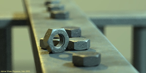

Using the scene from the last "brazil challenge" for testing my lighting
macro (code posted on p.b.s-f.). There are 3 warm-white 15w fluorescents at
the far left,  and 1 incandescent 60w lamp at the right/background.
  This time I've not used radiosity, and the focal_blur uses less samples.
Also, I added some nuts to make it a bit different. Render time was almost
2h (with area_lights).

Amazing.  I'm curious about the lighting because I know that often makes the
scene.  Your lights have specific wattage and real world types.  How do you
define this in a scene?  Is the type of light (i.e. incandescent,
fluorescent) based on the rgb value and the intensity is the watts?  How do
you control it so precisely?

Absolutely amazing!
Although: on the second look it looks a tiny little bit like made of clay,
don't you think so? Maybe due to the scratches? I don't know why. I had just
this feeling.
Anyway, it's more than excellent!

Skip Talbot wrote:
> Amazing.
  Thanks!
> the scene.  Your lights have specific wattage and real world types.  How
> do you define this in a scene?  Is the type of light (i.e. incandescent,
> do you control it so precisely?
  See my recent post on p.b.s-f., there is the code for the set of macros I
used to manage lights at that "high level", and a link to a web page
explaining the whole idea.
  I'm sure my implementation of the real data is not "physiscally correct",
but it gives nice results and make easy for me to manage known artificial
lights. I hope to get some comments if someone uses it, to make it more
handy and correct if possible.

Jürgen Scharfy wrote:
> Absolutely amazing!
  Thanks!
> just this feeling.
  You're right! I was not sure about it, but now that you mention it, seems
like the material is soft, too deformable... just like metal-painted clay!
And you're also right about what is causing it: the small normal pattern is
not very good for such metal, I must work on it.

  Very, very nice! My only concern is the 'pitting' on the surfaces, but
you've explained that already. The lighting IMO is excellent!
   Nice macro camera you have there.....   ;)

Your image looks quite photographic to me.  It is stunning to say the least.
May I ask how you created the texture for the bolts and nuts?  The small
dents and pits
look very nice, how did you accomplish it?
> least.
  Thanks!
> dents and pits
  Averaged normals: I used two patterns, one for the "microsurface" and
other for the dents or "macrosurface". I averaged several copies of them,
rotated and translated. Of course, it needs >40 samples on the focal blur
to give smooth results.
  Indeed, I noticed now that I forgot to post the code for this scene!
Willl post it latter on p.b.s-f.
