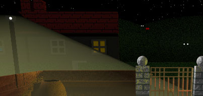

Hi,
     Using Steve's and others suggestion of a clear cone and media, I'm
somewhat closer to what I want to achieve, but if you look at the image
where the light crosses the illuminated window, you can see clearly a kind
of dark/black hue or line. It doesn't show so much in the darker areas, so
how do I remove it?  Also, I'm getting it wrong where it's supposed to start
fading, can anyone help me with this? I've tried fade_distance in the light
source but can't see any difference between a low setting and a high
setting, ie, I've tried .8 and 3.8.
     Thanks for any help.
      ~Steve~
     Here's the code...
   light_source { <-10.125, 5.83, 13> colour Yellow * 1.5
  area_light <4, 0, 0>, <0, 0, 4>, 4, 4
  adaptive 1.5
  jitter
   fade_distance 3.8
#declare Media =
media {
emission .028
      intervals 5
      samples 1, 10
      confidence .9999
            variance 1/1000
      density{
              gradient y
              ramp_wave
              turbulence 18 //0.3
              colour_map{
                        [0.0 colour <.6, .6, 0.3>]
              scale <1,1,1>
              translate <-10.6, 5.2, 14>
cone{<0,-7.5,0>20,
     <0,1.3,0>.05
     pigment{rgb Clear}
     interior{media{Media}}
     hollow
Download 'bb35.jpg' (38 KB)
Preview of image 'bb35.jpg'

try adding
fade_power 2 to the light source as well, this will really increase the
falloff rate
change Clear to rgbt 1  (Clear = rgbf 1 which comes out different fo some
reason)
Also, why are you using emitting media rather than scattering?
-tgq

      Aha! Good question Trevor! :) I used Steves code from his site as he
suggested and didn't change it. Thanks for your reply. I'll give it a go
right now.
   ~Steve~
Makes more sense to me to use emitting in this particular case. If he were
using scattering, then he shouldn't confine the media to the cone shape. It
may make sense to add fog to the scene to simulate the absorption part of
the media.
- Slime

    Also, when I was using emitting media, the whole scene was taking just 6
minutes to render, but now that I've changed it to scattering, it just
overheated my CPU at 90 deg c, (the alarm went off), on line 39 of
480........ wait for it....... 1 hour 27 minutes later!  :o(
  I'll try your suggestion Slime. Thanks.
