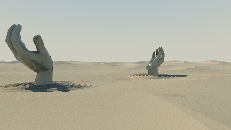

Hi all
Not much of an update but I've tried to address the criticisms so far.
Well hopefully there is now some more contrast in the image as I've darkened
the sand a bit.
The objects should now give a sense of direction for the light and I've
scaled down the effect of the normal on the sand.
This took 1hr to render with low quality aa and radiosity (only count of
50), hence the artifacts.
Comments and criticisms more than welcome
Kev
http://perso.libertysurf.co.uk/kevin.ellis
Download 'desert.jpg' (47 KB)
Preview of image 'desert.jpg'

Kevin Ellis wrote:
> Hi all
> the sand a bit.
Nice, the darker terrain looks very good.
I wonder if the hands would look better if they were not reflective.  With
the very smooth environment, the reflection does not look very convincing
IMO.

Kevin Ellis a écrit :
> Hi all
> the sand a bit.
I like the dunes at the far end of the image;  I like the hands,  too.
May be the concentric ripple shape surronding the hand could
have been less "regular"... I mean,  the sand waves could be done
more randomly,  less concentric,... A bit as a spalsh !
But it is my opinion.
Alex P
Thanks.
> IMO.
I did try a proper skin texture but that didn't look right, I was thinking
of going for stone, then gave up and just went for a nice easy shiny metal.
Would you recommend going back to a stone look, as I think I may.......
Kev
Yes, maybe.  You could also try glass or something with subsurface
scattering.

I agree with Alex with the ripples regularity, and i would like to add a
question.
How far is your main light source ? If the light source that generates the
hand's shadows is the "sun" of your image, i would say it should be farther
than it actually is.
Anyway, it looks great :-)
Just my 'dois centavos'
Will

"Wilson Reis" <wil### [at] ismcombr> wrote in message
news:3bd4a217@news.povray.org...
> question.
I've added some turbulence to the ripples now.
farther
The light source is actually 20000000 units away, and the scale of the hands
is about 5 units tall. I know why you're asking as the shadows seem to point
in different directions, my friend noticed that too, I may have to move the
light around a bit or add parallel.
Thanks.
Kev
> scattering.
Glass or subsurfscat, you must be mad ;-) It already renders at less then
4pps with the aa and rad settings turned up, I think I'll go for stone,
seems the more sensible option, at least to get it rendered this year anyway
Kev

"Kevin Ellis" <kev### [at] tiscalicouk> wrote in message
news:3bd4fe78@news.povray.org...
> > question.
> farther
I think if you replaced the hands with poles you'll see the shadows do go in the
same direction. It's just because the hands are showing it different directions
that it seems that way.

Wow!
Looks even better than Dali, IMO...
How about water falling out of the sky into the hands...
- Nekar

Ooops...
Now i see my mistake :-)
I will do some "realtime render simulation" this weekend, at the beach  and
see how the shadows look like
Will

This is really excellent work.
I agree with the suggestion that the hands should be stone, nicely chipped
and cracked, glass with caustics or subscat would be nice but...
The notion of water either falling from the sky or fountaining, dripping or
overflowing from the hands would give point to the picture, add to its
poetry and bump the render time up nicely!
ripples in sand are usually long and thin, like waves your texture is more
like that of a crowd stamping about in a wild frenzy! try
lengthening/scaling it in the z direction perhaps.
Look forward to the final result.

Kevin Ellis wrote:
> Hi all
> the sand a bit.
> Kev
From: Chris Jeppesen
Subject: Re: I may actually finish this one, part 2 (50kb bu)
Date: 23 Oct 2001 13:21:28
Message: <3bd5a718$1@news.povray.org>
if you add a caravan or something like people and camels walking between the
hands, you can give the "statues" a better sense of scale. You can make them
anything from just large to absolutely enormus.
Date: 23 Oct 2001 14:34:37
Message: <slrn9tbcsm.cts.steve@zero-pps.localdomain>
Looks finished to me.

From: Kevin Ellis
Date: 23 Oct 2001 15:17:21
Message: <3bd5c241@news.povray.org>
"Mick Hazelgrove" <mic### [at] mhazelgrovefsnetcouk> wrote in message
news:3bd52660@news.povray.org...
Thank you kindly.
Working on the stone as we speak, although it's hard to get it to look right
in the shade (Left Hand) with the blue tinge and out in the open (Right
Hand), then again why don't I just make two textures, one for each.
Sometimes the easiest solution is too easy to see.
or
I may try to add some water but I'll see how it goes.
Ok, will do
Kev

From: Kevin Ellis
Date: 23 Oct 2001 15:18:34
Message: <3bd5c28a@news.povray.org>
"Chris Jeppesen" <chr### [at] digiquillcom> wrote in message
news:3bd5a718$1@news.povray.org...
the
them
There could be some people involved, although I've not quite decided yet.
Kev
From: Kevin Ellis
Date: 23 Oct 2001 15:20:09
Message: <3bd5c2e9@news.povray.org>
"Steve" <ste### [at] zeroppsuklinuxnet> wrote in message
news:slr### [at] zero-ppslocaldomain...
Thanks, but then again the one behind it never thinks it looks finished :-)
although I hope it will be........soon.
Kev
From: Mahalis
Date: 28 Oct 2001 05:57:18
Message: <3bdbe48e@news.povray.org>
Great idea- how about maybe making the hands have the same sand texture as
well as having the water falling into the hands?
//Mahalis
camera{location<0,0.25,-2> look_at 0.5*y} #declare T=texture{pigment{crackle
scale 0.5 rotate 90 turbulence 0.75 color_map{[0 rgb 1][0.05 rgb 1][0.1
rgb<1,0.25,1>][0.25 rgbf 1][1 rgbf 1]}} finish{ambient 1}} #declare
c=difference{torus{0.5,0.1 rotate -90*x}box{<0.7,0,0.2>,<-0.7,-0.7,-0.2>}}
merge{object{c translate<0.5,0.5,0>} object{c translate<-0.5,0.5,0>}
cylinder{<1,0.5,0>,<1,0,0>,0.1} cylinder{<-1,0.5,0>,<-1,0,0>,0.1}
cylinder{0.5*y,0,0.1} texture{T}}
