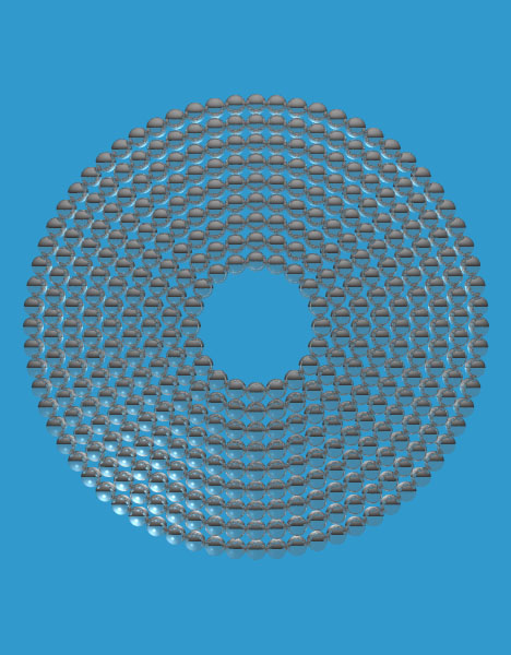

Okay, this note may get a little complicated so forgive me if I confuse you.
I have written a macro that makes stacks of rings of spheres as seen in the
attached image.  The macro adjusts the radius of the spheres in a ring
dependant on the radius of the ring because I wanted to make sure that all
spheres are tangential (touching each other at a tangent).

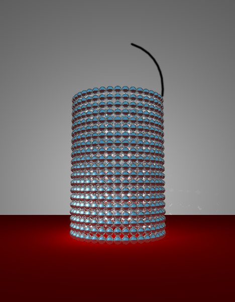

Now, what I would like to do is at the top of the "cylinder of spheres" is
start to make the rings, but so that every stack of it fits the profile i
have drawn in.  Figuring out what the radius of the ring should be and the y
value of the ring is very difficult for me--especially since the sphere's
radius changes as the ring's radius gets smaller.  I have attempted to
figure this out and in the second attached image you can see my initial
approach.

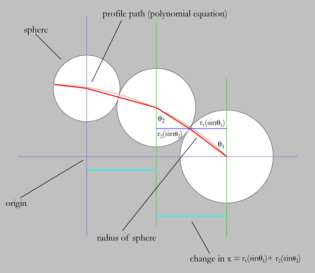

Initially I have thought to define a "path" for the profile by a polynomial
equation.  I would then input an x-coordinate value into the function with
the equation and I would get a y-coordinate as an output.  The problem is
that when you actually go and make this a macro, how can I determine the
change in the x value so it will give me the correct y value and STILL have
the sphere be tangential?   In other words how do I determine the
x-coordinate to input into the function that gives me the appropriate y
value?  Well I imagined that the change in x could be (as shown in the
diagram):
radius1*(sin theta1) + radius2(sin theta2)
I have figured out how to determine the radius for each sphere of any ring
size, but I simply can not figure out how to determine the "thetas" of which
to use for my equation.  Am I way off?  Is there an easier way to do this?

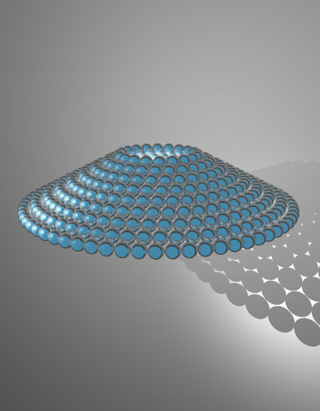

While muddling around, I have come up with this.  You can start see the
effect I am after, but this is truly a linear inclination.  I am looking to
acheive a curved inclination all the while my spheres remain tangential.  I
just can't get enough of this stuff.

From: Mike Williams
Subject: Re: Path with sphere attached. . .
Date: 22 Oct 2001 01:26:57
Message: <5ogF3FAU0607EwQ5@econym.demon.co.uk>
>approach.
>diagram):
>F. Audet has put up his Apple code which does something similar, and I have
>looked at it, but I am trying to understand how I can figure the math so
>that I can become more adept at making what I want.  Thanks for your time
>and help I appreciate it a great deal since it has helped me realize the
>images I see in my head :)
I think it gets rather messy, but here are a few pointers:-
Firstly, note that the green lines in your diagram are parallel, so
theta1 and theta2 are equal. So
1.      x = (r1 + r2)*sin theta
Now consider the ratio of r2 to r1. Because there are the same number of
spheres in each ring, the size of the spheres decreases by the same
ratio as the radius of the ring. Call the radius of the first ring "R",
then
2.      r2/r1 = (R-x)/R
The polynomial path that you are trying to follow provides the
relationship between y and x
3.      y = p(x)
And we can see that
4.      tan theta = x/y
The values of r1 and R are known, so we now have a system of four
simultaneous equations involving four unknowns (x, y, r2, theta).
Reducing these gives (if my algebra is correct)
5.      x = (r1 + (R - x)/(R * r1)) * sin(atan(x/p(x))
That's a horribly messy equation, but the only unknown in there is x, so
it should be soluble. The method of solution may well depend on the
nature of p(x). Good luck!

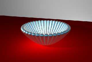

Thank you Mike.  I have been messing around and thinking about you tips.  I
think I'm almost there :)
Take a look
Arie
Download 'sphereBowl.jpg' (24 KB)
Preview of image 'sphereBowl.jpg'
> then
> 2.      r2/r1 = (R-x)/R
> 3.      y = p(x)
> And we can see that
> 4.      tan theta = x/y
> Once you've calculated x, obtain y from #3, r2 from #2, and theta (not
> that you need it) from #4.
> Mike Williams
> Gentleman of Leisure
>Hi Mike,
>I have been looking at your equations and am confused on equation number
>How can you define x with x in the right side of the equation?
That's the problem. That's what you get if you reduce the simultaneous
equations. I can't do any better it without knowing p(x).
Does it help if I rearrange it like this?
5a.      x - (r1 + (R - x)/(R * r1)) * sin(atan(x/p(x)) = 0
Even if someone tells me what p(x) is, it's still going to be horrible
to solve for x. I'd be inclined to use some sort of numerical method to
obtain an approximation.
Mike Williams

Subject: Re: Path with sphere attached. . . [MORE PROGRESS]
Date: 25 Oct 2001 03:03:21
Message: <3BD7BAB6.19FFFC0D@pobox.com>
> see the effect I am after, but this is truly a linear inclination.
> I am looking to acheive a curved inclination all the while my
> spheres remain tangential.  I just can't get enough of this stuff.
Hooked, eh?
If you want to keep the spheres one size (or roughly so),
you'll have to abandon the equal spacing of the green lines.
	r0 = radius of the spheres of the previous tier
	R0 = radius of the circle containing their centers
	n0 = how many are in that tier
	p(R) = your profile curve
	P(R) = its first derivative
In the next tier, as a first approximation,
	r1 = r0
	R1 = R0 - 2*r0 / sqrt(1+(P(R0))^2)	// i hope; i'm tired!
	n1 = round(n0*R1/R0)
This won't be an exact fit, but there are techniques for improving it
(which, unfortunately, are beyond my intelligence at this hour).
What is your desired profile curve, by the way?
For a different look, I might try adapting what others have called a
"Fibonacci spiral" (really the Fermat spiral with golden sector
sampling).
Anton Sherwood
