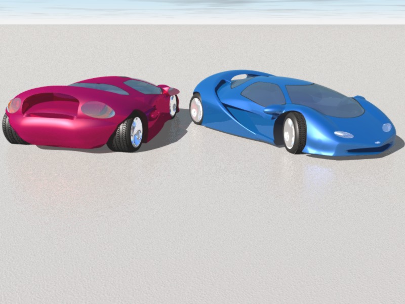

Fixed the mirror. The mystery CSG that kept me busy for hours on end, trying to
find where it came from was actually just the inner part of the wheel well
reflecting the tyre and outside! Fixed it by changing the colour to a matt
black. The blue texture is getting better, but it's still not exactly what I
want. Still got to do the panels and doors I've been promising. I think I'll use
negative blobs, so that the edges won't be too sharp. And then there's the
interior...
Does anyone have any suggestions on how to do the number-plate?
I find myself only seeing certain mistakes when I do the large final renders. I
wish there was a way to do real-time modelling renders. I've tried +q1 with
simple textures but it's still very slow. Any ideas?
- Nekar

Nekar Xenos wrote:
> This is the color I'm trying to get on my car.
Apart from a different color you will also need some environment for the
reflections.  Adding an image map around (with no_image) is a convenient
way for this (although some real environment would not hurt either.
Nice work so far BTW.

I think the easiest way for a license plate may be a heightfield. *looks
through links* I think someone has a tutorial about making flat-type objects
with hfs. Hmmm...
Dan D.

Given it's lack of importance, and the fact you'll not likely have a close-up
shot of it, then you might be able to use a thin slice of a superellipsoid cube
(for round corners) and use the image you might make for a height-field as a
bump-map instead.

To me, a heightfield is the best choise here. Have you ever seen what some
people (Jaime Vives Piqueres) can do with heightfields? They're fast,
efficient and, why not, quite precise. I'm quite sure one could make a whole
scene just with heightfields!
Jonathan.

Well, it maybe fine for the number-plates. In the past I've tried doing shiny
round objects with heightfields, but it had a course matt finish, even with
hi-res bitmaps and the best settings to my knowledge. Maybe you can tell me how
to do smooth round objects with heightfields? I remember the first thing I
thought of when I heard of height-fields was doing a face.
- Nekar

Blurring the h-f image in your favourite image-processing package should
help you here. The quality much depends on its resolution. And don't forget
*smooth on* in the h-f block!
Jonathan.
shiny
with
me how
> - Nekar
From: Nekar Xenos
Subject: Re: Car WIP 4
Date: 4 Oct 2001 02:07:42
Message: <3bbbfcae@news.povray.org>
"JRG" <jrg### [at] hotmailcom> wrote in message news:3bbb5824$1@news.povray.org...
That's just it. I a very high res image and I used smooth on. It just doesn't
seem to work correctly with reflections. Maybe I should try the guitar again in
3.5...
I think I'll just use CSG for the number-plates. I want to be able to specify
different number-plates for different cars without having to make a new image in
another application each time. We have flat number-plates here in South Africa
now, so it'll be SA number-plates...
- Nekar
