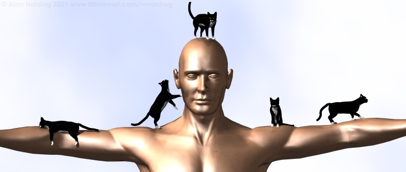

Don't really know how to finish this one off.  Any suggestions?  (I know how
to use Poser models now!)
strip?  I know v3.5 now has a parametric isosurface function that I could
use, but it's ssslllooowww at the moment and the strip I require needs to
have a bit of thickness to it - like a strip of road, rather than a strip of
paper.  Thanks.
Alan.

From: Txemi Jendrix
Subject: Re: Quintet (33kbu)
Date: 24 Sep 2001 16:53:54
Message: <3baf9d62$1@news.povray.org>
news:3baf9aa6@news.povray.org...
how
Different background and add some dirt
(perhaps a night scene with some lamposts and some buildings in the rear.
Chris Colefax
http://www.geocities.com/SiliconValley/Lakes/1434/
have macros and include files to help you with that).
of
> paper.  Thanks.
http://www.f-lohmueller.de/pov_tut/povlup3e.htm
A great place to learn povray with a lot of examples and source (a must).
Hope this helps.
Txemi Jendrix
http://www.geocities.com/txemijendrix

From: C J
Date: 24 Sep 2001 17:53:40
Message: <3bafab64$1@news.povray.org>
Skin your man with carpet!

From: Trevor Quayle
Date: 25 Sep 2001 08:16:07
Message: <3bb07587$1@news.povray.org>
Very nice image.  (very Gilles Trans-esque)  For a mobius, with some work,
you may be able to create one with a macro and meshes.
-tgq

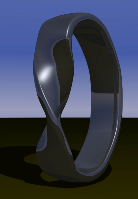

From: Trevor Quayle
Date: 25 Sep 2001 14:37:44
Message: <3bb0cef8$1@news.povray.org>
I have started writing a mobius mesh2 macro which you can try out.  I will
post version 1 in p.t.s-f for you.  At present, it has no thickness an does
not have smoothing normals added.
Please give it a try and let me know what you think and if you have any
suggestions or questions
-tgq
From: Jamie Davison
Date: 25 Sep 2001 16:39:07
Message: <MPG.161ae97f47131602989a21@news.povray.org>
On Mon, 24 Sep 2001 21:44:40 +0100, Alan Holding wrote...
> paper.  Thanks.
You can make one out of bezier patches using something like HamaPatch...
It's not too tricky.  I'll have a go and let you nkow if I get a result.
Bye for now,
     Jamie.

From: Jamie Davison
Subject: Re: Quintet (33kbu) - moebius.jpg [1/1]
Date: 25 Sep 2001 17:09:54
Message: <MPG.161b02c273b5350f989a24@news.povray.org>
> > paper.  Thanks.
OK, attached should be an image of a Moebius strip I knocked together in
HamaPatch and Moray.  Hamapatch for the modelling, and Moray for the
scene layout and textures.  OK, so jpeg mangled it a bit, but at least
it's small :)
Let me know if you want the .hmp file for it. (assuming that you're a)
using Windows, and b) have downloaded HamaPatch)
Bye for now,
     Jamie.
