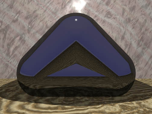

Patience is a virtue they say. Well I tested my patience with this one!
  Again, the dreaded spheres - 323 of them.
  Is there a way to 'compact' the code to do this sort of thing?
  I moved the spheres in increments of .01.
   ~Steve~
Download 'Smooth Triangle.jpg' (108 KB)
Preview of image 'Smooth Triangle.jpg'
From: D  Stark - eSN
Subject: Re: Smooth Triangle. (107kbs)
Date: 13 Sep 2001 15:40:05
Message: <3BA10A00.7BA6A2C@esupportnow.com>
You did it...by hand?!
Povray has macros and loops structures. I've not used them yet (I'm
still trying to keep track of a few dozen primitives), but that's what
they're there for.
Derek Stark
From: 25ct
Date: 13 Sep 2001 16:07:42
Message: <3ba1120e@news.povray.org>
"D. Stark - eSN" <dms### [at] esupportnowcom> wrote in message
news:3BA### [at] esupportnowcom...
one!
    Well, 'cut and pasting', but yes it's one long code! :)
> they're there for.
    Ah, that's what they're for. Thanks. I haven't a clue how to use them
though, can anyone explain?
  ~Steve~
> Derek Stark
From: Trevor Quayle
Date: 13 Sep 2001 17:04:16
Message: <3ba11f50$1@news.povray.org>
try loops and macros
i.e.:
#macro SphereLine (startpt,endpt,rad,nsegments)
    union{
      #local i=0;
      #local seglen=(endpt-startpt)/nsegments;
      #while (i<=nsegments)
          sphere{0 rad translate startpt+seglen*i}
          #local i=i+1;
      #end
#end
use like:
object{SphereLine(<-5,0,-5>,<2,1,2>,0.25,100) texture{MyTexture}}
creates a line from pt1 to pt2 using 100 evenly spaced spheres of radius
0.25
-tgq

From: Jamie Davison
Date: 13 Sep 2001 17:20:23
Message: <MPG.160b343c90c149ee989a05@news.povray.org>
On Thu, 13 Sep 2001 20:33:58 +0100, 25ct wrote...
Assuming you're using POV3.5b1, I would assume you could use a linear
Sphere sweep...
Bye for now,
     Jamie.

From: Jari Juslin
Date: 13 Sep 2001 20:30:02
Message: <3BA14F7C.C5A86966@iki.fi>
> Sphere sweep...
I'm not sure by looking at that image, but it the edges of the triangle
are not curved, also three cylinders and two spheres would do it. Or if
the vertices are curved, clipped tori instead of cylinders.

From: 25ct
Date: 14 Sep 2001 15:46:08
Message: <3ba25e80@news.povray.org>
"Jamie Davison" <jam### [at] ntlworldcom> wrote in message
news:MPG.160c6051bb9384c6989a07@news.povray.org...
> > > Sphere sweep...
> That was going to be my next suggestion, but I had to log off as someone
> else wanted to use the phone line, and by the time the line was
> available, I was asleep...
     Well yeah, I'd already thought of cylinders and 3 spheres, but I can't
move cylinders! Eek!  I find them really hard to move.... I don't know what
it is, am I missing something? Can anyone give me a way of moving these
easily??
     What do you do?
   ~Steve~  (PS. I would do something like I have done anyway, simply to see
what the image would look like).
> Bye for now,
>      Jamie.

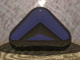

From: Jamie Davison
Subject: Re: Smooth Triangle. (107kbs) - round_triangle.jpg [1/1]
Date: 14 Sep 2001 16:41:00
Message: <MPG.160c7c5afaaff88e989a09@news.povray.org>
> easily??
>      What do you do?
I use Moray :)
I've attached a quick example of a CSG rounded triangle I put together in
about five minutes in Moray.  It consists of three Torii, three
Cylinders, six Cubes, and six CSG's - three differences, and three
unions.
Bye for now,
     Jamie.
Download 'round_triangle.jpg' (39 KB)
Preview of image 'round_triangle.jpg'
From: 25ct
Date: 14 Sep 2001 17:55:02
Message: <3ba27cb6@news.povray.org>
news:MPG.160c7c5afaaff88e989a09@news.povray.org...
someone
can't
what
> > easily??
> >      What do you do?
> I use Moray :)
> unions.
     Thanks Jamie, that's the sort of thing I intended to do in the first
place, but with glass. It didn't quite come out that way though. Great image
for 5 minutes. I haven't got Moray at the moment, but with some of the
others suggestions, I'll give something else a go. Thanks for your time,
it's helped me.
   ~Steve~

From: PeterC
Date: 15 Sep 2001 17:11:03
Message: <3ba3ad97.2556724@localhost>
>   ~Steve~
Why not use 3 spheres and three cylinders?
From: 25ct
Date: 16 Sep 2001 06:58:26
Message: <3ba485d2@news.povray.org>
news:MPG.160dcd2950340b68989a0a@news.povray.org...
> If you want the source that Moray spat out for this, then feel free to
> ask.
     Could you? You can mail it if you want. I'd appreciate it.
    ~Steve~
> Bye for now,
>      Jamie.
From: 25ct
Date: 16 Sep 2001 06:58:27
Message: <3ba485d3@news.povray.org>
<PeterC@nym.alias.net> wrote in message news:3ba3ad97.2556724@localhost...
> >   ~Steve~
   I just wanted to see what it looked like the way I did it, and I find
cylinders hard to move, but I'm trying.  :o)
  ~Steve~
From: Anton Sherwood
Date: 25 Nov 2001 04:47:44
Message: <3C00BFFA.1F005DBF@pobox.com>
> but I can't move cylinders! Eek!  I find them really hard to move....
> I don't know what it is, am I missing something? Can anyone give me
> a way of moving these easily??
Why would you need to move them?
	union {
	  sphere   { P0,     R }
	  cylinder { P0, P1, R }
	  sphere   { P1,     R }
	  cylinder { P1, P2, R }
	  sphere   { P2,     R }
	  cylinder { P2, P0, R }
Anton Sherwood  --  http://www.ogre.nu/ (online again, Nov.19)
From: Mahalis
Date: 25 Nov 2001 13:11:36
Message: <3c013458$1@news.povray.org>
I think what 25ct means 'to position them in an equilateral triangle'. That
can be done fairly easily with the vrotate() function.
"Anton Sherwood" <bro### [at] poboxcom> wrote in message
news:3C00BFFA.1F005DBF@pobox.com...
