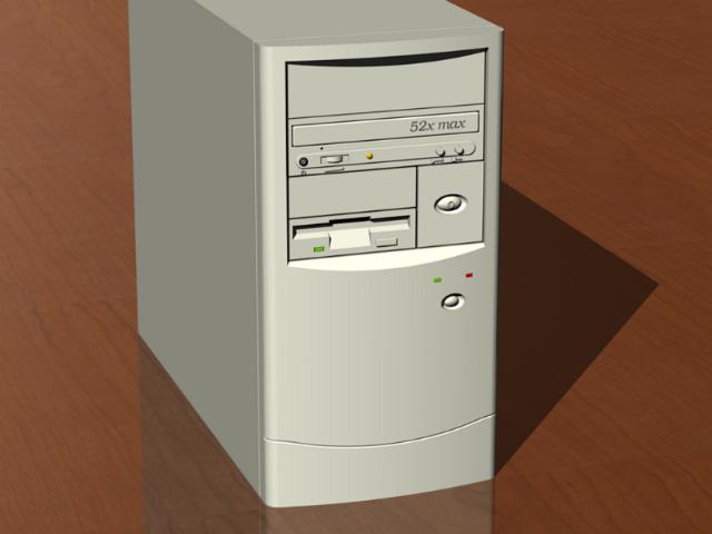

How do I make this shadow look smoother or blurred, not straight?
Download 'pcfinal640.jpg' (21 KB)
Preview of image 'pcfinal640.jpg'

RTFM. Look up "area_light".

Tony was just referring you to the POV-Ray Scene Help.  RTFM = read the fine
manual (unless you want the vulgar definition).
light_source {0,1
area_light x*3,y*3,3,3 jitter adaptive 1
translate -100*z
rotate <45,45,0>
This would create soft-edged shadows from the area light facing directly
toward <0,0,0>.
This light comes from a square on the z plane which is then moved and
rotated into place to keep the plane facing the origin.
jitter prevents shadow banding and adaptive helps smooth it.
Reading the help file tells the basics, using the features helps to
understand it  :-)
Bob H.
