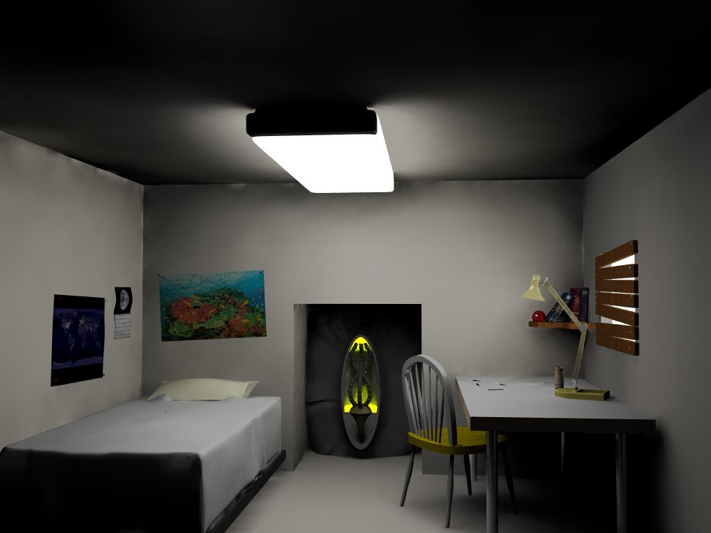

I've replaced that awful 'garbage can' in my last image with an H.R.
Gigeresque alien foetus like thing that I modeled some time ago. I have also
spruced up the apartment a little with more objects, it no longer looks so
much like an institution. By introducing the bright outdoor light that comes
through the slits in the boarded up window I have greatly increased the
number of artefacts, so I will probably need to do another render with
higher settings. Here are the radiosity settings I'm currently using:
pretrace_start 0.01
pretrace_end   0.005
recursion_limit 1
error_bound 0.6
nearest_count 10
count 1000
I could try increasing error_bound but then I would loose the little detail
that I already have in the shadows. Or I could increase the count, what is
the max for count anyway?
Download 'bedroom2 2.JPG' (62 KB)
Preview of image 'bedroom2 2.JPG'

Oh yeah this is pure radiosity in this image, no lights of any kind.
I can tell from the shadows.
Since you have no "real" lights, you'll get much more realistic lighting
results in this image by increasing recursion to 2. You may get more
artifacts than you're willing to put up with, though.
Max count is 1600 IIRC.
-Xplo

Looks pretty nice. The lighting on most of the objects look very realistic. I'd
suggest that those radiosity artefacts are less visible on more complex forms,
but show up really bad on the perfectly flat walls, so maybe you could just put
more detail in the room to hide the artefacts? I confess I don't know much about
good radiosity settings :)
Tek
> pretrace_start 0.01
> pretrace_end   0.005
> recursion_limit 1
> error_bound 0.6
> nearest_count 10
> count 1000
You should probably decrease 'adc_bailout', the suggested value is
'0.01 / brightest ambient object'
Subject: Re: Apartment rad (take 2)
Is there any reason for this limitation BTW?
Not that *I* know of. I remember being pretty pissed when I found it.. I
was working on my own "light a room with only radiosity" project and I
just couldn't get rid of the artifacts.
-Xplo
> > pretrace_start 0.01
> > pretrace_end   0.005
> > recursion_limit 1
> > error_bound 0.6
> > nearest_count 10
> > count 1000
Assuming he's using MegaPOV, I would actually suggest *increasing* it to
1. This is counterintuitive, but in my tests it seemed to give a small
speed boost without significantly affecting the image, whereas other
values had no useful effect.
-Xplo
I remember i once managed to reduce artefacts by decreasing it, not sure
if it works the same in this situation of course.
Thanks, I'll play with the adc_bailout a bit and see what I get.
