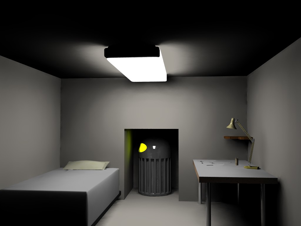

The thing in the alcove at the back is supposed to be some sort of
futuristic machine, but it ended up looking more like a garbage can. I'm
going to play around with some more designs for it. One REALLY annoying
problem I had with this image is that Pov-Ray kept stalling at about line
621 of the 1024x768 render. I had to reposition the camera and rerender this
scene over 20 times before I got it to render without stalling. Has anyone
encountered this kind of problem before? I noticed that if I took the
pretrace_end above 0.01 it didn't stall on the radiosity prepasses but it
still stalled on the final render, the only way I could solve this is if I
moved the camera around. Too bad the desk lamp is small in this scene
because I actually put tones of detail into it, perhaps I'll render a
close-up of it latter, if I can fix this stalling issue.
    Maybe if you made something that looks bigger than the hole in the wall,
like it takes up most of the wall but only needs access to the room through
the hole....? Maybe something with nasty pinchers that come out when you
sleep...
    Oh Great! Now -I- won't be able to get to sleep...
I noticed stalled renders some times too, but it mostly occured if the
render was already slow so you do not really notice it's stalled ;-)
Anyway it never was persistent, slight changes always helped.
It looks good, but the sizes seem somewhat wrong, as you mentioned the
table lamp is too small, at the same time, the main light is very large of
course. Finally a 'garbage can' half the height of the room? :-)

Geez, what is this, 1984?  Looks like a pretty gloomy (and cramped)
apartment.  Oh well, the rad ain't bad.
> apartment.
Actually that is the felling I was going for.
Hmm.. well this render is not slow to begin with and the stall is really a
stall, I have to do a ctrl+alt+del to get pov to quit.
I noticed the proportion problem too. I've now replace the garbage can thing
with a totally different object, and it seems to help that a bit, along with
a few other objects.
wall,
through
> the hole....?
Good idea, in fact I've already have a rhino model in "storage" that might
work nicely here.

Thomas Lake wrote:
> Has anyone
There is a problem with Megapov stalling when using radiosity on meshes with
(erroneous) 0-length normals. Does it stall on a Rhino object ? If this is the
case, replacing the <0,0,0> normal with something else should fix it.
G.
with
the
> G.
Hmm no it doesn't stall on a Rhino model, though I do have two large Rhino
meshes in the scene. But they are closer to the top of the image, it stalls
at the bottom of the image, just below the bed. Thanks for the note though,
I had no idea Megapov had this problem, is this a problem with Megapov
itself or does it have more to do with Rhino's output?
It's a Megapov problem. In fact many meshes have a couple of 0 normals and
usually it doesn't cause any trouble, but when it does, the symptoms look
exactly like the ones you describe, with Megapov entering an infinite loop in
some very particular circumstances (render size, position etc.).
G.
in
Yeah that does sound a lot like the problem I had here, I was able to render
it fine at 160x120 but at 1024x768 is stalled, I didn't really try anything
in between. I was also able to get the position that it stalled at to move
around by moving the camera. Hope this gets fixed in the next release.
