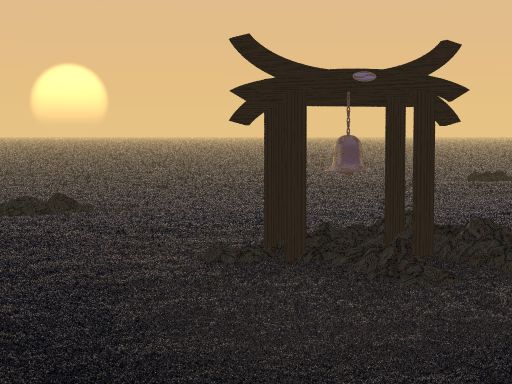

From: Gail Shaw
Subject: Ocean's edge (34kbu)
Date: 28 May 2001 05:20:28
Message: <3b12185c@news.povray.org>
An idea I got after looking at some screenshots of myst 3
The water is heavily based on Christoph's rmf water from
his scene "Water Tunnel". The sun is a clear sphere with
fade_distance and fade_colour with a 5*5 area light
I'm planning to add some thin clouds across the sun.
Anyone got any suggestions on the water. I like it except
that close up it looks like rough concrete covered with
gold leaf. I'm experimenting with hetero mf to see if that
looks any better
Render time 30 hours.
Gail
* gsh### [at] monotixcoza                *   Step into the abyss,           *
* http://www.rucus.ru.ac.za/~gail/   *   and let go.        Babylon 5   *
* The difficult we do immediately, the impossible takes a little longer *
Download 'Oceangate.jpg' (34 KB)
Preview of image 'Oceangate.jpg'
From: Nekar Xenos
Subject: Re: Ocean's edge (34kbu)
Date: 28 May 2001 05:57:25
Message: <3b122105@news.povray.org>
"Gail Shaw" <gsh### [at] monotixcoza> wrote in message
news:3b12185c@news.povray.org...
What does it look like if you invert it?(now where have I heard that one
before?) I don't think it will be correct but it mght look better than it does
at the moment.
That's a lot of patience. Was that running in the background?
/* Nekar Xenos */#local N=<-20,40,100>;#local K=<20,-40,100>;#local R=seed(0);
blob{#while((K-N).x>0)#local X=N;#local N=N+<rand(R),rand(R),1>/3;#local N=(
vlength(N-K)<vlength(X-K)?N:2*X-N);sphere{<N.y,-N.x,N.z>,1,1 scale .02}sphere{N
,1,1 scale.02}sphere{<-N.x-40,N.y,N.z>1,1 scale.01}sphere{<N.x+40,-N.y,N.z>1,1
scale.01 }#end pigment{rgbt 1}interior{media{emission <2,4,5>*5}}hollow}
From: Gail Shaw
Date: 28 May 2001 06:04:09
Message: <3b122299@news.povray.org>
does
> at the moment.
Worth a try.
Started it running before I left home in the mornings, stopped when I got
home. Took 3 days (10.5 hours a day)
It only takes an hour and a half without the area light
Gail
Looks good, i recalled having seen some scene with similar atmosphere from
you and found it in the 'Wilderness' IRTC round.
I was already planning a sunset version of my current scene, but it will
be awfully slow to develop things...
The RMF shows the typical effect of being quite flat between the ridges,
something usually decreasing realism a lot IMO. I tried to avoid this by
making it stronger.
I think that would look very good.
> looks any better
That would be interesting to see, i never tried heteroMF for water.  For
the water's color I think it would be quite important to make the sky less
uniform, during sunset, it should be much darker and more blue on the
opposite side and that would be visible in the reflections.
Sounds awfully slow for without radiosity.

Christoph Hormann <chr### [at] gmxde> wrote in message
news:3B123A2B.2639948C@gmx.de...
Yup, lake and mountains, done with vue d'espirit. I love sunsets
I'll have a go tonight with heteroMF and no area light and I'll post the
results tomorrow.
> For
It's currently varying from orange to light blue. Will tweak that.
Guess arealights and multifractals don't work well together.
Gail
Date: 28 May 2001 09:54:08
Message: <3B1258CC.407F1BEE@gmx.de>
Then removing the area light would probably help a lot, i don't see much
area light shadows here anyway (or is there an additional fill light).
From: Gail Shaw
Date: 28 May 2001 10:34:48
Message: <3b126208@news.povray.org>
news:3B1258CC.407F1BEE@gmx.de...
No fill light. Without area the rock on the left has a very sharp shadow
and looked really wrong. I might have overdone the area light however.
Gail
From: j charter
Date: 28 May 2001 20:57:02
Message: <3B1322A2.93D67C5@aol.com>
Love the idea and  composition.  Colors are lovely.  Yes the water and rock
textures need some honing. Do you know what is causing the banding in the
lower part of the sun?  I am having problems wtth similar banding in my
current scene and I want it outta there.
/jc
From:
Date: 28 May 2001 21:03:38
Message: <3b12f56a$1@news.povray.org>
j charter a écrit dans le message <3B1### [at] aolcom>...
maybe its the fog (or media) you used to blur the horizon line? If so, you
could put it lower.
Louis

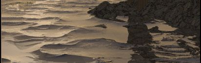

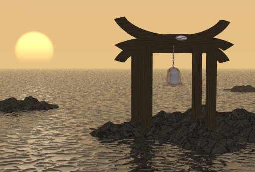

Firstly I tried with heteroMF. I don't think much needs
saying except that it looks terrible.
HeteroMF settings were
 function{"heteroMF",<0.07, 2.2, 7, 0.6, 0.5>}
The second picture is a partial rendering
with ridgedMF, using the settings that
Marc-Hendrik Bremer posted
That has promice, if I could only get the ridges closer
together
RMF settings were
function {"ridgedmf", <0.1, 3.0, 7, 0.7, 0.7>}
Both images use the same material for the water.
Comments?
Gail
I'm not sure if heteroMF is suited for water at all, but how did you come
to these values.  Have you tried some different settings?
In the picture it also seems to have a very fine structure, maybe some
larger horizontal scaling would help too.
> together
> RMF settings were
These are the same values i use very often (also used in my water
tutorial) I recently also tried:
function{"ridgedMF",<0.07, 2.2, 7, 0.6, 0.9>}
news:3B13DFA4.42ADA6DE@gmx.de...
They were tha same values I used for rmf except the last one. That
I guessed. Problem is I don't understand what the parameters do. I've
read the mega helf several times, but it doesn't really help.
I'll try some other values when I get time. That pic took 4 and a half hours
(Over twice what RMF took)
Thanks, I'll give that a try. If I change the water material to a
solid pigment it might render fast enough for some experimentation.
