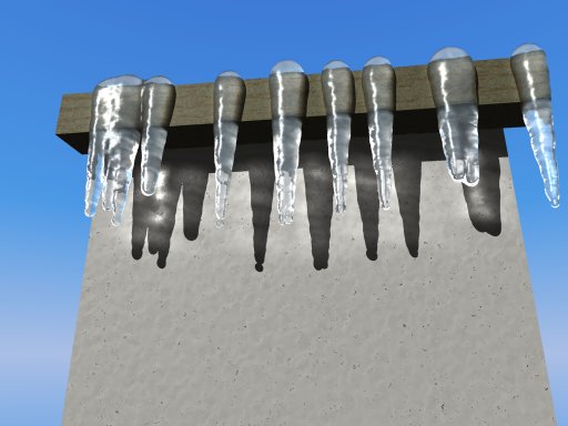

Here's what I ended up with for now and anyone should be able to figure it
out enough, the pov script containing macro in this scene is posted at
p.t.s-f.
Thought I better get it put there before I went too far with it and messed
things up.
Bob H.
http://webpages.charter.net/omniverse/omniverse.htm
Download 'iciclesmacro.jpg' (30 KB)
Preview of image 'iciclesmacro.jpg'

It somehow does not look very 'cold', maybe a lower roughness would be
good.  Thanks for the code.

Some of the tips look a bit rounded.  Are they melting or really small
icicles?  I remember icicles being more pointed like those in the middle of
the picture.  Are these drops of water on the tips?  The caustics look great.
Sometimes, we have one that reaches a length of about seven feet long before
falling.
Brendan

Thanx for the code, Bob ...
looks like a warm spring day when they are beginning to melt
and become less translucent and on their way to opaque.
I still think the pointy ones look closer but . . . I will mess with
your code and see what happens.
Tnx again,
Y
of
great.
You're joking right?  You think I'd put water droplets in there too?  :-)
Just pretend they are maybe melting or freezing.  A media change makes a
huge difference in how they look but I finally left it as is for anyone else
to modify that part.
The shapes change dramatically for different parameters.
I took the regular 'caustics' keyword out, figuring it competed with the
photon mapping.
before
> falling.
I didn't specify it unit-wise but inch=unit would probably fit.  It's not
apparent what length you might actually get I guess, since if 10 is used for
"size" then a 3 for "length" you wouldn't get a maximum of 13 units, and not
7 units, but something like a range from 9.875 to 7.625 units.  What's more
is with it being a blob the threshold value changes it drastically overall.
#while (C>In+(Il+(IRl*(6-Iv))))  // a real mess for sure
Where In is the zero ending point, Il is 0 to 2 (random), IRl is 0.125 to 1
(also random), and Iv the Length variable (intended to be 0 to 5).  The C is
of course the beginning size (related to both length and girth).
Confusing, isn't it?  I had trouble getting a random number to be used so
it's worse than would have otherwise been.  It's still my typical chaotic
scripting besides.
Hopefully this explains things a bit anyhow.
Bob H.
Welcome to it.  I had it looking glassy once and so went with a more glossed
over appearance; it might be better to lower the specular number, esp. since
phong is used too.  I thoroughly expect everyone will make changes.
Bob H.
