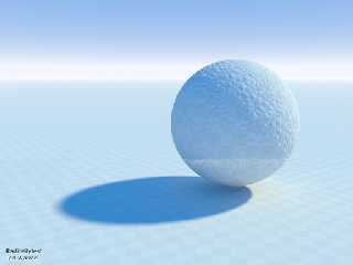

OK ...
I tried "normals on" and its so beatiful now ...
It took 'bout 2 hours with a crash between ...
So maybe the lower half is not correct with radio....
I can't see any artifacts, but I can't give my word ..
background{rgb 1}camera{location<1,5,-2>look_at 0}#macro
m(a,b,i)#local d=(b-a)
/8;#local
e=vcross(d,y);#if(i)m(a-e,a+e+2*d,i-1)m(a+e,a+2*d-e,i-1)m(a+3*d-e,a+e
+3*d,i-1)m(a+3*d-e,a+5*d-e,i-1)m(a+6*d-e,a+e+6*d,i-1)m(a+8*d-e,a+e+8*d
,i-1)#else
cylinder{a,b,vlength(d)/3 pigment{rgb 0}}#end#end m(-4*x,2*x,4) // Jan
Walzer
Download 'radiosity_test.png' (121 KB)
Preview of image 'radiosity_test.png'

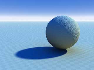

From: Tony[B]
Subject: Re: Radiosity2-Now with "ambient Normals"
Date: 20 Mar 2001 13:24:43
Message: <3ab7a06b@news.povray.org>
Here's my version, with my rad settings, a sky_sphere and a corrected sphere
texture.
Download 'janzrad.jpg' (18 KB)
Preview of image 'janzrad.jpg'

From: Jan Walzer
Date: 20 Mar 2001 14:21:06
Message: <3ab7ada2@news.povray.org>
Your settings are ?
... did you change the finish of the texture, or only the Rad-Settings
seems quite dark for me ... but so far .. thanx ..

From: Jan Walzer
Date: 20 Mar 2001 14:26:40
Message: <3ab7aef0@news.povray.org>
Hehe ... I asked this myself ...
The Heaven is blue ...
so the most ambient is blue ...
The sun is yellow ...
so where the sun hits the sphere, there is the ambient and the sun
(blue + yellow) that gives white ...
The shadow of the sphere, that is not lit by the sun is blue, because
of the ambient ...
below the sphere there is no ambient, but the sun brightens some parts
so it gets yellow ...
You understand ?
Date: 20 Mar 2001 14:57:14
Message: <3AB7B618.4249554A@gmx.de>
> of the ambient ...
> You understand ?
Because the sphere and floor themselves are white,  the yellow light
leades to yellow color where the sky's effect is not that strong.
From: Tony[B]
Date: 20 Mar 2001 20:52:17
Message: <3ab80951@news.povray.org>
> Your settings are ?
global_settings
 assumed_gamma 1
 ini_option "+QR"
 radiosity
  pretrace_start 0.32 pretrace_end 0.08
  count 300 nearest_count 4
  error_bound 0.01 recursion_limit 1
  low_error_factor 0.5 gray_threshold 0
  minimum_reuse 0 brightness 1
  max_sample 1 adc_bailout 0.01/2 normal on
> texture, or only the Rad-Settings ?
I only changed the rad-settings and the pigment of the sphere.
That can be fixed by using a higher brightness or gray_threshold. I didn't
mean to imitate your settings, just show you that I had fixed "reflection"
the problem.

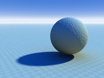

From: Kari Kivisalo
Date: 21 Mar 2001 05:33:31
Message: <3AB88380.89C707E7@kivisalo.net>
Ken wrote:
> No, I don't. I have never seen any situation in real life that this
> would represent.
How can you compare then?
I have seen several photometric images of physical setups and
corresponding rad simulations in IEEE and other publications
which clearly show the validity of radiosity. There are differences
in implementations, like noise in the ray based radiosity, but the
basic concept is solid.
The problem with all radiosity implementations is that there are too
many cryptic parameters to tweak so users in general use non optimal
setup which ruins the simulation. There is an EU project ARCADE which
tries to automate the parameter tweak phase among other things so that
you don't have to be "Certified Radiosity Technician" to produce good
results. http://www-imagis.imag.fr/ARCADE/
This particular scene is a poor choice for meaasuring how realistic
the simulation is for two reasons. The "sky" emits the same amount of
"energy" as the "sun". Nobody has ever seen this situation so it's a
bit difficult to compare. The scene is also uniform in all directions.
There is something funny going on with background{} and radiosity.
I rendered the same scene enclosed in a sphere and the anomaly at
the bottom of the sphere disappeared.
http://hammer.prohosting.com/~kkivisal/sphere.jpg
______________________________________________________________________
Kari Kivisalo                                  http://www.kivisalo.net

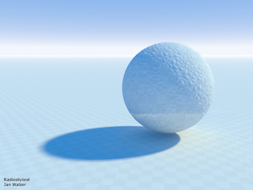

From: Jan Walzer
Date: 21 Mar 2001 07:03:26
Message: <3ab8988e@news.povray.org>
I don't think the problem was due to the background{} ...
If you turn off the normals in radiosity, you will get a similar (or
the same) result ...
the "ambient-normals" of the sphere just scramble the reflections, so
you can't recognize them ...
/8;#local
,i-1)#else
Walzer
of
directions.
This was rendered with normal on.

From: Nekar Xenos
Date: 22 Mar 2001 10:38:27
Message: <3aba1c73@news.povray.org>
It's because the sky is simulated. The light that illuminates sky comes from
the sun. So the blue intensity in the sky should never be higher than the
blue intensity of the sun e.g. sun: rgb ( 1.0, 0.9, 0.5 )  might have a sky
of rgb ( 0.1, 0.3, 0.5 ) and not rgb ( 0.1, 0.3, 1.0 ).  (I don't know what
the settings are in the pic)
I think absorbing media and scattering media might make a more 'real' sky.
BTW, has anyone tried making sky with media before?

"Jan Walzer" <jan### [at] lzernet> wrote in message
news:3ab7aef0@news.povray.org...
> of the ambient ...
> You understand ?

From: Chris Huff
Date: 24 Mar 2001 11:10:02
Message: <chrishuff-D8933E.11034024032001@news.povray.org>
In article <3aba1c73@news.povray.org>, "Nekar Xenos"
It has been done by several people. I've had fairly good results
producing a sunset by using scattering media in several "shells" and a
large sphere for the land. However, MegaPOV's sampling method 2 or 3 is
almost absolutely necessary for this.
Christopher James Huff
