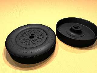

My younger son's Cub Scout Pinewood Derby is coming up and I thought it
would be fun to model the car before we build it.  So far I've done the
wheel and have started on the axle.  The image below was modeled in Moray
3.3, uses MegaPov 0.6, antialiasing, radiousity (I think), and reflection.
It took about 4hrs 15min to render on a AMD Athlon 1.2Ghz.  DUDE!  Isn't
that an unrealistically long time for an image like this?  It has ALOT of
CSG, but the render time surprised me.  I've heard bounding mentioned here
before but don't really have a good understanding of how to use it.  Anyone
have any suggestions about how to decrease the render time, or about
improvements on the wheel?  Does MegaPov need a command line switch to
actually turn on radiousity?
Thanks,
Cris Williams
Download 'pwd wheel.jpg' (144 KB)
Preview of image 'pwd wheel.jpg'

It's not that astonishing IMO, since you are using several light sources,
reflection, complex objects, ...
Maybe try turning off those things one after the other and check the
render time.
BTW, the wood texture looks a bit strange with the concentric rings
(normal?)
Yes, you have to add '+qr' to turn it on in addition to the radiosity{}
block.

The wood textured plane is just something I picked at random to slide under
the wheels at this point.  But your right, I could have picked a less
distracting texture.  Another question about radiousity - since I'm using
Moray, the Pov code doesn't have the "#version unofficial MegaPOV 0.6;" line
in it.  Will the radiousity be Pov-style or MegaPov-style without it?  At
this point I'm not using any MegaPov-specific features (but I do want
MegaPov radiosity).
Cris Williams

Megapov docu, section: Enabling MegaPov Features:
"Backwards compatibility is not available for radiosity."
meaning that it always uses megapov radiosity.
Anyway using old style radiosity settings will not give any reasonable
results so you will probably not be able to avoid editing the files
manually.

I can't help you to explain the long render time, but I think the
texture is great! Will you publish it??
Regards,  Sander

I would say that's not totally outrageous for your render time.  You have
some pretty complex CSG going on there.  I'm guessing that you've subtracted
a torus from your text to get the curved effect on the surface of the wheel.
If this is correct, then that's an even more complicated calculation.  Also,

"Cris Williams" <wor### [at] netscapenet> wrote in message
news:3a9494ea@news.povray.org...
Anyone
> Thanks,
> Cris Williams
From: Cris Williams
Subject: Re: Pinewood Derby Phase I (143 KB)
Date: 22 Feb 2001 16:22:17
Message: <3a958309@news.povray.org>
Well, it comes down to this  - you gentlemen know exactly how each of the
finish components interact and thus approach the task of creating textures
methodically and scientifically.  I, on the other hand, have only a vague
understanding of what I'm doing, and just sit and wiggle the slider knobs
until I arrive at something acceptably close to the desired appearance. :-)
I am pretty happy with what I ended up, though, despite my hit-and-miss
approach.  I prefer to think of textures as half art and half voodoo.  If
you know what you're going to end up with before you start, then it takes
all the fun away!
Cris Williams

Actually, I merged the text and a torus to curve the text.  It seemed more
efficient than subtracting a torus from a cylinder (or rectangle), and then
subtracting the result from the text.  I'm using an AA setting of 0.3.
I'm not sure what you are saying about the CSG's.  Which is faster,
difference or merge?
Cris Williams

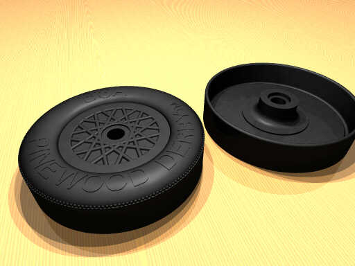

Sorry couldn't resist.
This scene took 8m 18s at a 750MHz Athlon.
The picture doesn't exactly look like yours, but I think the important
parts are done.
Rendert with 512x384 Pixel and a antialiasing of 0.3
Stefan

So tell me!  How was this done?  (Um, and why?)  :-)
Cris Williams

Hi,
I've attached my scene at the first posting.
But I think that you used merge instead of union, which I think is a
little bit faster.
Stefan

Oh, yea - I missed the source the first time around.  Thank you!  After
comparing yours to mine I came to the conclusion that we weren't doing
anything differently enough to account for such a big render time
difference, that is until I looked at the lighting.  Area lights kill!  Of
course, I was using area lighting to the extreme, and when I changed them to
point lights my scene rendered 15 TIMES FASTER!  Oh well, live and learn.
I'll probably still use area lights for my final renders, but it's nice to
know that I don't have to wait 5 hours for an intermediate render.  Thanks
for your help!
Cris Williams
