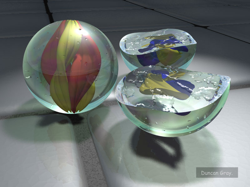

My IRTC anim entry that have been doing my head in this week, so inspired by
David Fontaine's 'Orange Wedge' and Tor Olav Kristensen 'Bonds' and 'Other
Bonds'  I decided to take the weekend off animating, and render myself some
new marbles to replace those I'm loosing.
I'm trying to give the surface of the marble a well-used look, with varying
degrees of success. The marble on the left I like, but it's not quite
right - dunno why. The one on the right - though it looks wonderfully old,
doesn't look like it should be in one piece anymore. I'm trying to get
something between these two - cracks rather than dents, but not so badly
cracked that the whole surface is covered.
Any suggestions on how to improve the look ? Would I do better to create
myself some solid cracks, and CSG these out of the surface rather than
trying to do it with a normal ?
(N.B. Current normals (for 1 untit radius spheres) are:
Left_marble=normal {  crackle 1 poly_wave 3 normal_map {
        [ 0 crackle 0 poly_wave 3 ]
        [ .3 crackle 0 poly_wave 3 ]
        [ .3 crackle -1 poly_wave 3 ]
        [ 1 crackle -1 poly_wave 3 ]
      } scale .05  }
Right_marble=normal { crackle 1 normal_map {
        [ 0 crackle .5 ]
        [ .1 crackle .5 ]
        [ .1 crackle 0 ]
        [ 1 crackle 0 ]
      } scale .1 }
Render time 1hr 12mins on a PII 450 using POV-Ray 3.1g.
Duncan Gray
(warning: may contain traces of nut)
Download 'marbles.jpg' (21 KB)
Preview of image 'marbles.jpg'

I'd say the on the left looks excellent, and I wouldn't think a glass marble
would crack without shattering completely. Then again, I never played with
marbles much.
Well done.
Dan D.
marble
> marbles much.
I've used the wrong term really, my mistake. Crack does imply some depth to
the damage, and if a marble were found in this state, then it would surely
become two fractions of a marble next time it were dropped.
Perhaps scratched would perhaps better describe the effect I'm searching
for. Does anyone out there have access to any well used marbles; can you
check should I be going for scratched and chipped, or just chipped ?
I'm thinking also that I've got the coloured bit all wrong as well. Should
be more ribbon-like, less solid.
Think I best head for the toy shop this week and remind myself what they
look like !
Thanks for your thoughts.
Duncan Gray

The marbles found in aerosol paint cans look just like the one on the
right.
Yes.

I think the left one is much better. Glass is pretty resistant to deformation,
at a certain level of stress it'll just break.
From what I remember of my marbles, back before I lost 'em, the colored part is
much more two-dimensional. What I would do; imagine spinning a disc to make a
sphere, but instead of tracing out infinite copies of the disc, trace out some
number like three. Then take this whole thing and twist it around the same axis
you spun the disc around, so you get a multiple helix thing, with edges along a
sphere or ellipsoid.

These look very nice but the swirly coloured patterns (I'm trying to use the
correct terminology here) don't look like any marbles that I used in my
youth. The patterns that I remember were more like leaves with two or three
twisted slightly.
Chips and scratches were very common, given that concrete and ashphalt were
the kinds of surfaces played on. The one on the right looks too severe, the
one on the left is better but probably needs more. I don't ever remember a
marble breaking so they must have been very resistant to cracking.

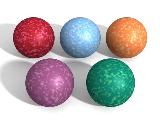

Side note on marbles: I have 5 ceramic marbles that were excavated from the
1996 Olympic games site Atlanta, Georgia, USA where a marble factory existed
going back to the 1800's.   Maybe I should render them.
Having said that I did try to.  See attachment please.
Bob H.

The one on the right looks closest to a used marble.
From what I vaguely remember is that the marbles have the
green-glass-tint-look(absorbing media). When they're used a lot they get
tiny white chips resulting in a dirty-white or ash look. I also remember
marbles getting quite large chips in them, sometimes preventing from rolling
straight.
For the coloured swirls inside I'd suggest using then same index of
refraction as the glass to remove the 'bubble' look. Maybe something with a
bozo transparency might do the trick to get that blended look....
Nekar
deformation,
Funny you should say that, I fiddled about with the one on the right that it
has now broken in half.
I guess the picture is now called " Red wins by K-O "
part is
make a
some
axis
along a
Ah, so my memory wasn't lieing to me - the colours are more ribbon-like than
solid. At the moment I'm doing it by spinning three negative blobs about a
positive blob, then duplicating this shape, shorted but fatter and flipped
on it's axis of rotation. That way the colour on the top and bottom
inter-twines the color in the centre.
it might not be too much work to correct this (fatal last words).
Thanks V. much, I'll go back and play some more.
Duncan Gray

Ah, actually this effect was quite intentional, I thought they did have air
trapped in there alongside the swirls. I've done it by making the swirls
slightly reflective as opposed to adjusting the IOR, but it'll be easy to
remove.
Once I've got some ribbon-type swirls, I'll try rendering without. On this
swirl-model it looks a bit flat without the white highlights inside the
marble.
Duncan Gray

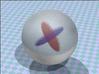

Hi
I consider your question very interesting. Even at work I found myself
trying to remember how used marble looked like. I make some tests and
bellow is the result. I think I came more or less close to what I
remember. Maybe it doesn't feet your needs,  but if you are interested I
can post the code.
Alberto.
Download 'mrbl.jpg' (50 KB)
Preview of image 'mrbl.jpg'

From: Duncan Gray
Subject: Chipped Marbles update (68k)
Date: 23 Feb 2001 15:42:34
Message: <3a96cb3a@news.povray.org>
Thank you everyone for your comments and suggestions.
I'm fairly happy now with the surface or the marble (the chipped normal),
and though the swirly bits are still not quite right, they are much closer,
and I think I now have an algorythm will work, it's just a matter of tuning
the parameters a bit more. The colour of the marble has also been changed
slightly to give a greenish hue (thanks to those who suggested this, it does
I think improve the look)
Problem now is with the shadows which are being cast by the marble, looking
at the shadow of the broken marble nearest the camera - the JPEG-type effect
around the dark shadow I am happy with - this is caused by the area light,
and can be lessened up by increasing the number of elements in the area
light source (currently 5x5) and by adding the jitter keyword.
The bit which is concerning me is within the shadow of the semi-transparent
part of the marble, the colours are not blending well - it gives me the
impression of an image which has either been heavily compressed when
converting into JPG or an image which has been enlarged and smoothed,
neither of which are the case.
the light source is as follows:
light_source
  lamp1_pos
  color 1
  area_light <3,0,0>,<0,0,3>,5,5
    adaptive 1
  spotlight
    radius 3
    falloff 6
    point_at lamp1_tgt
Can anyone help me out with this little problem ? Am I doing something wrong
with this light source - I'm not sure if you are meant to combine area_light
and spot_light in a single light source, but I couldn't find anything to say
I cannot.
The tiles have a normal on them, though it is fairly subtle. they are
slightly reflective also, might these factors be contributing to the effect
Thanks in advance for your suggestions.
Duncan Gray

Subject: Re: Chipped Marbles update (68k)
Date: 23 Feb 2001 17:04:48
Message: <3A96DE1D.316FA2F2@faricy.net>
It looks pretty good. I'm not sure how marbles would fracture but i'm not gonna
get up roght now and go find out... the texturing is good and I see you fixed
the spirals :)
From: Rick [Kitty5]
Date: 23 Feb 2001 17:54:23
Message: <3a96ea1f@news.povray.org>
very nice, dunno if marbles do break cleanly in half - never really tried to
break one :)
POV-Ray News & Resources - http://povray.co.uk
Kitty5 WebDesign - http://kitty5.com
Hi-Impact web site design & database driven e-commerce
PGP Public Key

From: Duncan Gray
Date: 23 Feb 2001 19:55:18
Message: <3a970676@news.povray.org>
> not gonna get up roght now and go find out... the texturing is good and
> I see you fixed the spirals :)
Thank you.
The nature of the break is guess-work - I have never seen a marble break in
two, but I am assuming it would break something like sheet glass - on the
whole smoothly, but with rough jaggy patches.
Spirals are not finished with yet, but I think are a big improvement on my
initial attempt.
I think I've just solved my shadow problem as well - it's not the shadow;
it's the reflection in the tile.  Doh !
Thanks again.
Duncan Gray

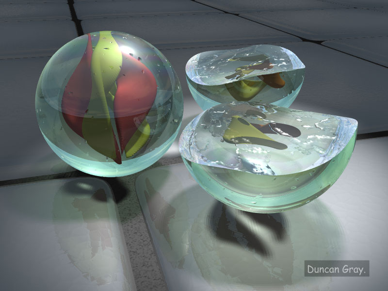

From: Duncan Gray
Subject: Finished Chipped Marbles. (70K)
Date: 25 Feb 2001 19:29:35
Message: <3a99a36f@news.povray.org>
Finally I have the image to a point where I am happy to call it finished.
It has taken a while to render all the variants, but versions are now
available at 800x600, 1024x768 and 1152x864 for those who wanted them. I
have made available ZIP files containing the POV-Ray generated TGA files in
case you'd rather view the image without JPG compression artifacts. I have
ZIPed them, but they are still rather large.
Rather than post it all to the server, I have made them available on my own
web-site for download and just posted the 800x600 JPG version, the source is
also there for anyone who might like to investigate it.
<www.eclipse.co.uk/duncang/download/marb800.zip> 800x600 tga (725k)
<www.eclipse.co.uk/duncang/download/marb1024.zip> 1024x768 tga (1107k)
<www.eclipse.co.uk/duncang/download/marb1152.zip> 1152x864 tga (1335k)
<www.eclipse.co.uk/duncang/download/marb800.jpg> 800x600 jpg (70k)
<www.eclipse.co.uk/duncang/download/marb1024.jpg> 1024x768 jpg (102k)
<www.eclipse.co.uk/duncang/download/marb1152.jpg> 1152x864 jpg (122k)
<www.eclipse.co.uk/duncang/download/marb_src.zip> source code (4k)
Thanks for your suggestions and comments over the last week or so, I hope
like the final image is to your liking.
Duncan Gray
Download 'marb800.jpg' (70 KB)
Preview of image 'marb800.jpg'
From: Richard Morton
Subject: Re: Finished Chipped Marbles. (70K)
Date: 26 Feb 2001 07:03:04
Message: <3a9a45f8@news.povray.org>
Very nice. Much more like the marbles of my misspent youth. Just a couple of
minor comments :
1) In the marbles that I have seen (as recently as last weekend), the
different coloured leaves are joined in the middle edge - this may well vary
across manufacturers.
2) The coloured leaves are too close to the top of the glass. This may just
be something to do with viewing angle but I would expect more of a gap.
"Duncan Gray" <dun### [at] eclipsecouk> wrote in message
news:3a99a36f@news.povray.org...
From: Duncan Gray
Date: 26 Feb 2001 19:36:28
Message: <3a9af68c@news.povray.org>
vary
just
Cheers.
During development, I did have the leaves meeting in the middle. I tried it
both ways and ended up using this version - for no particular reason. I got
tied up last wekend and didn't manage to go marble shopping so this image
has been built largely on suggestions from group, some pictures downloaded
from a marble museum, and a fading 20 year old memory of what a marble looks
like !
With respect to the swirly bits finishing too close to the top of the
marble, The marble has been tilted backwards (so that the swirly bits
receive some lighting from the main light-source). This does make the swirly
bits appear to touch the top of the marble, the refraction of the glass (IOR
1.2) also exaggerates the effect. I'll fix this at some time, but I think I
better get hold of a couple of marbles myself first to refresh my memory.
I hope you'll excuse me if I don't implement your suggestions
immediately -though I am sure you are correct in your observations
(especially with such recent marble experience). The image was meant to be a
couple of days light relief from my IRTC Anim entry and has managed to take
over a week now. I will re-visit the image at some point in the future but
for the moment I must resume my Anim or it won't be finished on time.
I just wanted to get the image to something I considered 'acceptably
complete' for myself, and the couple of people that requested it as a
wallpaper image (hence the links to lots of different sized versions).
Thanks again, and honest, one day I will correct the points you have raised.
Duncan Gray
