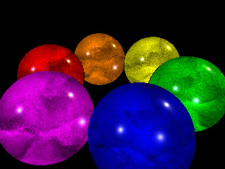

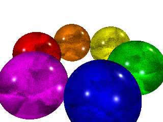

I added a facing gradient with rgb 0 on the back side, now it works.
Download 'spheres.jpg' (38 KB) Download 'spheres2.jpg' (41 KB)
Preview of image 'spheres.jpg'
Preview of image 'spheres2.jpg'

"Ryan Constantine" <rcc### [at] ucdavisedu> wrote in message
news:3A64CAC3.894329D5@ucdavis.edu...
> i don't recall anyone trying that before.  clever.  will it work on
> objects with irregular shapes?
Not really, but then if it's csg you could just apply the gradient to each
object I guess.
> is there a way to orient the gradient so it is always away from the camera
> without rotating the actual object?
That's what I did, just declare camera_position and object_position vectors,
and it faces the gradient towards the camera.

Actually, I added absorption, looked real nice, until I changed the
background to black again.  With the facing gradient, it will look the same
either way, even if it has an irregular background.

Two problems with this method: you can't see the spheres when behind
other spheres, and there is a black fringe around the spheres.
If you use MegaPOV, you might be able to fix the "fringe" problem using
interior_texture...just make the ordinary texture clear, and the
interior texture opaque black, so you can see into the spheres but not
out of them. This would also automatically work with any camera angle
and with light sources, with no extra work. And it would certainly be
easier than messing with gradient texture maps... It would also work
with any object, not just spheres.
It doesn't fix the problem that the spheres become opaque, though...but
maybe that is what you want. (If the spheres are really supposed to be
transparent, their color *should* be affected by the background...but
you have an interesting effect here of opaque objects that look
transparent.)

Well that makes it alot easier.  No need for trigonometry after all I guess.
The "fringe" problem was actually because I didn't rotate them exactly
towards the camera, just approximately.  I changed that later, so it doesn't
show up.

Well, the interior_texture method still has the advantage of working
with reflections and shadows, anyway...
