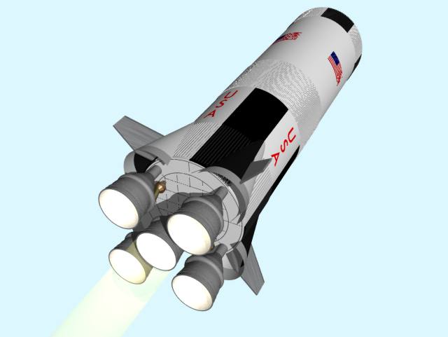

Here is the first stage of a Saturn V I am modeling. I want to get the flame
better than this, but I am not familiar with media. What it needs to be
essentially is a cylinder about 600 feet long and about 12 feet in diameter
that is at the core very hot and white-yellow, but fades to transparent at
the outer radius, then also fades to zero radius at the 600 foot "tail" end.
Somebody must have done this already. Any suggestions?
Jon
Download 'SaturnV.jpg' (20 KB)
Preview of image 'SaturnV.jpg'
Subject: Re: Saturn V (~20K)
Date: 18 Dec 2000 19:42:10
Message: <slrn93tblh.2mo.steve@zero-pps.localdomain>
Assuming 1 POV unit per foot:
difference{
           sphere{<0,0,0>,12
                  scale <1,1200,1>
           cylinder{<0,0,0>,<0,600.1,0>, 12.1}
          // Texture/Media stuff goes here.
          } // End of difference.
I think that Bob H did one of these (or something similar):
http://users.aol.com/persistenceofv/all.htm
 12:32am  up 11:52,  2 users,  load average: 1.00, 1.00, 1.00
From: Jon Berndt
Date: 18 Dec 2000 20:36:04
Message: <3a3ebb84@news.povray.org>
> difference{
>            sphere{<0,0,0>,12
>                   scale <1,1200,1>
I can get the CSG object stuff easily. It's the "Texture/Media stuff" that
is new to me - actually just the media stuff. Playing in Moray helps out.
It's a nice image, but the markings and dimensions of the rocket are off. I
am being very precise on measurements and markings and other details.
Jon
From: Bob H
Date: 19 Dec 2000 12:52:20
Message: <3a3fa054@news.povray.org>
"Jon Berndt" <jsb### [at] hal-pcorg> wrote in message news:3a3ebb84@news.povray.org...
You noticed... :-)  I actually never used dimensions based on actual numbers, I
measured a poster-sized photograph I have and followed what looked about right.
It should be fairly close though.
'media' is not very user friendly, everyone knows that.  I had trouble putting
5 media objects together because overlaps would mix in odd ways.
Something like this should be a start anyhow:
camera {location -15*z
        look_at 0
background {rgb .5}
#declare T0=density {rgb 0}
#declare T1=density {wrinkles frequency 1
                     turbulence <1,3,1>*1
                           density_map {
                                [0 rgb <.1,.5,1.25>*0]
                                [.25 rgb <.667,.5,.3667>*.125]
                                [.5 rgb <1,.75,.5>*.5]
                                [.75 rgb <.75,.5,.367>*.25]
                                [1 rgb <1,.8,.5>*.75]
                  } scallop_wave scale .4 }
#declare T2=density {wrinkles frequency 1
                     turbulence <1,3,1>*2
                           density_map {
                                [.25 rgb <.667,.5,.3667>*.25]
                                [.5 rgb <1,.75,.5>*.75]
                                [.75 rgb <.75,.5,.367>*1.25]
                                [1 rgb <1,.8,.5>*1.5]
                  } scallop_wave scale .2 }
sphere { 0, 1  hollow // no_shadow
 pigment { color rgbf 1 }
 interior {
        media { method 2
                intervals 1 samples 2,2
                emission <.9,.75,.5>*.75
                absorption <.25,.33,.5>*.5
                 scattering {4,<.6,.3,.1>*.5 extinction .5}
                  density {cylindrical frequency 1
                     turbulence <1,3,1>*.2
                           density_map {
                                [0 T0]
                                [.5 T1]
                                [.67 T2]
                                [.75 T1]
                                [1 T2]
                  } ramp_wave scale .99 }
                  translate -50*clock*y // motion
       // fade_distance 4 fade_power 1
   scale <1,4,1> // scale change needs inverse density change
(requires MegaPov, as is)
Nice Saturn booster btw.
Bob H.
From: Jon Berndt
Date: 19 Dec 2000 15:14:51
Message: <3a3fc1bb@news.povray.org>
numbers, I
right.
Nobody but a space nerd would notice ;-)
FYI, a lot of good information can be gleaned from www.apollosaturn.com. I
took a truckload of pictures of the Saturn V lying on it's side here at
Johnson Space Center last week, and I am using those photos, as well.
putting
I'll take a stab at it. Anyone aware of a media tutorial?
Thanks. I hope I can find time to finish it.
Jon
