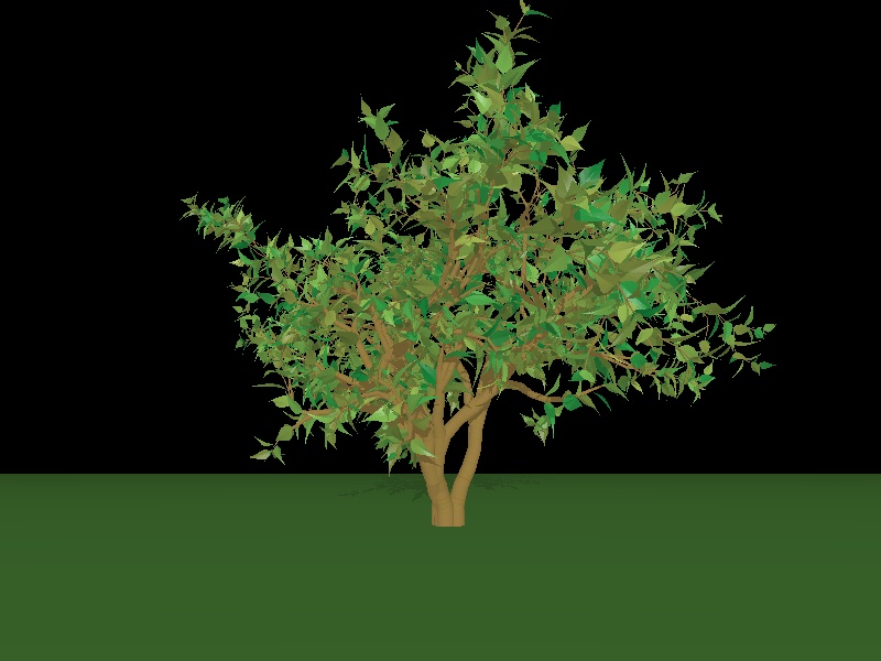

Hi There,
I've been working on some code for making
shrubs and bushes in MegaPov, and I'd sure
appreciate your opinions on this sample. It's
800x600, MegaPov 0.6a, PIII 450, rendered
in 1 min 20 sec.
Thanks, have a great day!
=Bob=
Download 'Shrub.jpg' (115 KB)
Preview of image 'Shrub.jpg'
Subject: Re: Shrubs
Date: 25 Nov 2000 23:19:51
Message: <3A208EEB.B85F8B04@faricy.net>
Hmm... probably better than my attempt :)
From: Thomas Lake
Subject: Re: Shrubs
Date: 26 Nov 2000 00:03:12
Message: <3A209925.998E42E7@home.com>
Hmm that looks very nice!! But if you don't mind here are a few
suggestions, it seems a bit off and I'm not sure I can pin down why,
here are my thoughts. The leaves seem too big for the overall size of
the bush. Also the size of the leaves don't seem to taper off fast
enough as your reach the end of the branches. There also seems to be
something a bit odd about the way it branches, perhaps if you posted a
leafless version someone who noes more about plants than me could tell
you what is wrong in more detail? Anyway that's just my 2 cents.

Subject: Re: Shrubs
Date: 26 Nov 2000 00:07:41
Message: <slrn9216j8.92g.steve@zero-pps.localdomain>
That looks great, the leaves look a bit stiff and
the whole thing looks a bit flat but that's due
to ambient light I think.
Nice work, keep us posted on your progress.

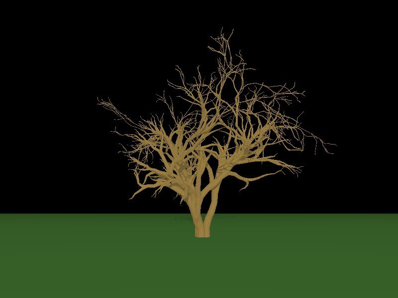

From: =Bob=
Subject: Re: Shrubs
Date: 26 Nov 2000 00:32:30
Message: <3a20a06e@news.povray.org>
Hi Thomas,
Thanks for your help. I'm attaching the "naked" shrub
to this one. I'll post another version with smaller leaves
and ones that taper off smaller at the ends later.
Have a great day!
=Bob=

Download 'ShrubBare.jpg' (60 KB)
Preview of image 'ShrubBare.jpg'

Subject: Re: Shrubs
Date: 26 Nov 2000 04:30:52
Message: <3A20D84C.306E44BA@schunter.etc.tu-bs.de>
looks ok and sounds quite fast, some information on memory requirements
and what and how many objects are used would be great.
From: Mick Hazelgrove
Subject: Re: Shrubs
Date: 26 Nov 2000 05:25:00
Message: <3a20e4fc@news.povray.org>
Makes a great tree! mean that it looks like a big old tree, with enough
small leaves it would be very good.
As a bush it is also very good. I like the original version.
Mick
From: Remco de Korte
Subject: Re: Shrubs
Date: 26 Nov 2000 06:28:47
Message: <3A20F3DA.827C7DC3@onwijs.com>
Looks good to me. Very fast too.
Did you colour the leaves separately?
How much memory did it take?
Remco

From: =Bob=
Subject: Re: Shrubs
Date: 26 Nov 2000 10:37:03
Message: <3a212e1f@news.povray.org>
I mistyped the time, it was 1:02, not 1:20
Scene contains 6495 frame level objects; 1 infinite.
D:\POVRay\scenes\MegaPov\PlantMaker2.pov Statistics, Resolution 800 x 600
Pixels:          480000   Samples:          480000   Smpls/Pxl: 1.00
Rays:            480000   Saved:                 0   Max Level: 1/5
Ray->Shape Intersection          Tests       Succeeded  Percentage
Cone/Cylinder                   261995           29626     11.31
Plane                           674333          154834     22.96
Sphere                           14698            5833     39.69
Bounding Box                   2335069         1357674     58.14
Light Buffer                   8445096         2610534     30.91
Vista Buffer                  10886193         6467074     59.41
Calls to Noise:             192240   Calls to DNoise:          19234
Shadow Ray Tests:           402433   Succeeded:                23321
Smallest Alloc:                 26 bytes   Largest:            51976
Peak memory used:         10489372 bytes
Time For Parse:    0 hours  0 minutes  14.0 seconds (14 seconds)
Time For Trace:    0 hours  0 minutes  48.0 seconds (48 seconds)
    Total Time:    0 hours  1 minutes   2.0 seconds (62 seconds)
Total cache size: 14000
Returned from renderer
POV-Ray finished

From: =Bob=
Subject: Re: Shrubs
Date: 26 Nov 2000 10:38:07
Message: <3a212e5f@news.povray.org>
See my followup to Remco de Korte for the stats.
=Bob=
"Christoph Hormann" <Chr### [at] schunteretctu-bsde> wrote in
message news:3A20D84C.306E44BA@schunter.etc.tu-bs.de...
: looks ok and sounds quite fast, some information on memory requirements
: and what and how many objects are used would be great.
: Christoph
: Christoph Hormann <chr### [at] gmxde>
: Homepage: http://www.schunter.etc.tu-bs.de/~chris/
From: =Bob=
Subject: Re: Shrubs
Date: 26 Nov 2000 10:50:32
Message: <3a213148@news.povray.org>
Hi Remco,
When I posted the stats, I forgot to answer
your specific questions...
The leaves are colored separately, in fact, a
new texture is created for every leaf using a
macro so the pigment and finish are slightly
different on every leaf, which are also made
individually. The leaves are made with a 4x4
bezier_patch.
=Bob=
"Remco de Korte" <rem### [at] onwijscom> wrote in message
news:3A20F3DA.827C7DC3@onwijs.com...
: Looks good to me. Very fast too.
: Did you colour the leaves separately?
: How much memory did it take?
: Remco
[My previous post deleted]
From: =Bob=
Subject: Re: Shrubs
Date: 26 Nov 2000 12:51:24
Message: <3a214d9c@news.povray.org>
Hi Mick,
I'm hoping that I'll be able to use the code to
create both. It seems that shrubs and trees
are similar enough anyway.
What do you think is keeping it from looking
more convincing? I think I've been looking
at it too long :^)
Have a great day!
=Bob=
"Mick Hazelgrove" <mic### [at] mhazelgrovefsnetcouk> wrote in message
news:3a20e4fc@news.povray.org...
: Makes a great tree! mean that it looks like a big old tree, with enough
: small leaves it would be very good.
: As a bush it is also very good. I like the original version.
: Mick
Subject: Re: Shrubs
Date: 26 Nov 2000 13:23:32
Message: <3A215501.AF36F4E8@onwijs.com>
Thank you for the info. It's surprisingly fast. I would have thought having
separate colours would make it slow and use a lot of memory. 10Mb is not too bad
(although it would have been say 5 or 10 years ago).
Are you going to 'publish' this as a macro or inc? Hopefully then it will be not
too hard to work with for someone with weak brains like mine.
Cheers!
Remco

From: =Bob=
Subject: Re: Shrubs
Date: 26 Nov 2000 13:46:28
Message: <3a215a84@news.povray.org>
Hi Remco,
Most certainly, I plan to release it after I get all of the
parameters working well together and can properly
comment the code. I'll be posting a couple more
samples soon for some more feedback. I'm trying
to get some trees out of it too.
Thanks!
=Bob=
