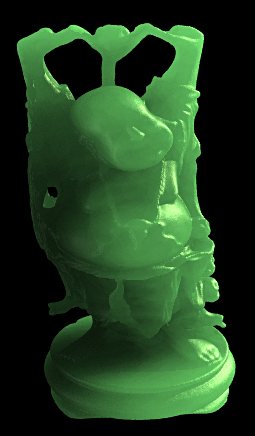

From: Mael
Subject: sss buddha [16kb]
Date: 27 Nov 2003 12:57:07
Message: <3fc63af3@news.povray.org>
Cool effect ! I had to try it on the happy buddha :)
M
Download 'sss_buddha.jpg' (17 KB)
Preview of image 'sss_buddha.jpg'

From: Samuel Benge
Subject: Re: sss buddha [16kb]
Date: 27 Nov 2003 13:40:14
Message: <3FC6450C.1040709@hotmail.com>
This is the mlPOV technique, yes? Whatever you did, it looks really
good! That buddha statue was just itching to be rendered this way!
> M

From: ts
Date: 27 Nov 2003 23:20:01
Message: <web.3fc6cbc7e7c0a33498a934b40@news.povray.org>
>M
indeed.
my first thought was that this could be used to simulate
a translucent jade.
this is way beyond me so i have a couple of questions ...
am i to understand that this particular method of samual's
requires mlpov? i haven't been able to run it with ver 3.5.
and ...
i have been trying to obtain this 'happy buddha'
file but see that it is in "lv" and some other format.
how is it possible to convert these to POV?
or is there somewhere i can find them converted ...
to what ... 'mesh' ?
tia for any leads and help.
ts

From: Mael
Date: 28 Nov 2003 14:29:04
Message: <3fc7a200@news.povray.org>
> Could you post how you applied the SSS to the buddha Mael?
#declare buddha = object { #include "../models/buddha_r2.inc" rotate 120*y
scale <35,35,35> translate -3*y }
object {
  buddha
  pigment{ average
   pigment_map{
    #local V=0;
    #while(V<100)
     [1 projection buddha , lpos1 blur .2,10
      translate<rand(R)-rand(R),rand(R)-rand(R),rand(R)-rand(R)>*1.5
      color_map { [0 rgb <.5,1,.5>][1 rgb 0] }
     #local V=V+1;
    #end
  finish { diffuse .2 ambient .9 specular .5 roughness .05 }
From: Mael
Date: 28 Nov 2003 14:29:21
Message: <3fc7a211$1@news.povray.org>
I downloaded it, a long time ago, from
http://www.cc.gatech.edu/projects/large_models/ and converted the ply format
to a mesh2 (AFAIR the conversion was quite straightforward)
M

From: Mike Williams
Date: 28 Nov 2003 15:56:55
Message: <+db8oDAW$6x$EwKu@econym.demon.co.uk>
Wasn't it Andy Cocker who wrote:
>Hi Mael,
>Thanks for your prompt reply. Unfortunately I'm still having the same problem in
>that the only
>texture showing up on the model is that which is specified in the mesh2
>texture_list:
>texture_list {
>  1,
>  texture { Material0 }
>I don't know how to overide this texture and make it use the SSS. Does your
>Buddha model have
>this texture_list entry?
The texture_list is optional, but if it's not there you have to remove
the texture number from each entry in the face_indices section.
At first glance, you might think that it might be tedious to remove the
texture numbers from the face_indices section, but it may well be
possible to perform Search->ReplaceAll of ">,1," with ">," and then just
edit the last one manually.
Mike Williams
Gentleman of Leisure
From: Andy Cocker
Date: 28 Nov 2003 16:39:39
Message: <3fc7c09b@news.povray.org>
"Mike Williams" <nos### [at] econymdemoncouk> wrote in message
news:+db8oDAW$6x$EwKu@econym.demon.co.uk...
Thanks Mike, that worked. I had already tried removing all UV references along with
the
texture_list section, but was coming up with an error regarding the face_indices.
Using your
tip I got it to work.
Thanks again,
Andy Cocker
