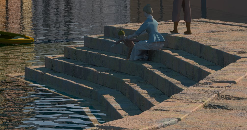

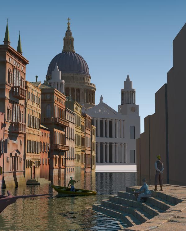

I have worked on the stairs - i'm not yet content with the colors, need to
be more saturated, but i thought i'd post the first version.
The geometry is changeable quite easily, feel free to experiment with the
control points and the sizes.  I'm not quite sure about the scaling, the
stairs are steeper in the original but they would be completely in shadow
then.  I am also not sure about the scaling.  I originally thought we have
1 unit = 1 meter but it seems more 1 unit = 2 meter.
Once we have agreed on a geometry the figures need to be adapted to it.  I
only placed them roughly for the moment.
It looks great even right now!
You are right about colors. Maybe it should not be so... colorful :)
Such detailed cathedral and this stair will need more details on houses.
So we will definitely will need heightfields or isosurfaces for basements :)
Gena.

Message: <3eb6b497@news.povray.org>
Breathtaking!
It's especially the dents that makes it look so good.
How many steps are the stairs going below the water? Is it supposed to
be only one, or is the water to dark to see the rest?

Peter Hertel wrote:
> Breathtaking!
What do you mean with 'dents'?
There is only one.  I am not sure how many it should be, the water is
probably not that deep directly at the steps.

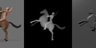

From: Gena Obukhov
Subject: Re: Capriccio - stairs (73+135k)
Date: 7 May 2003 01:31:26
Message: <3EB89868.756C7C8E@mail.com>

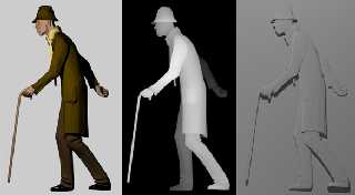

> This is very good idea (though I've never used Poser). I think this way
> you can use copyrighted Poser objects,  right? Just compose the scene
> with human figures, horses etc. use orthographic camera, special
> direct light and make black&white image for heightfield.
Here is the technique which I meant. First image is my original model
created in sPatch. Second image is the same model but with gradient
-z color_map from black to white. The third image is the heightfield
relief created from the second image.
Gena.

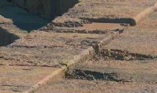

Here is the relief (on the top of portal) which we'd like to mimic:
http://www.milton.com/praha2002/im000163.jpg
Gena.

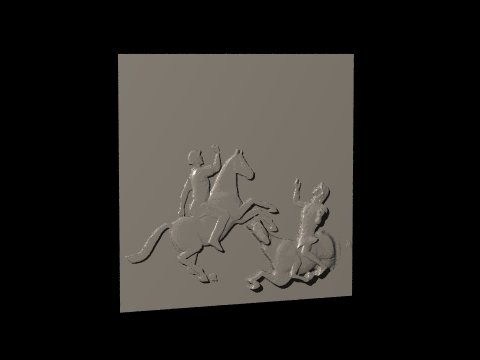

Date: 7 May 2003 11:55:41
Message: <3EB92C7D.A58EA810@gmx.de>

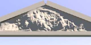

That's probably a good idea.  I made some tests with generating a
heightfield from the photograph on
here is the result.  It surely does not look very good which is of course
partly because the photo is not that good for this purpose.  What helps is
that shading in our case is somewhat similar to the photo although with
more shallow lighting - otherwise you would not even recognize the rough
geometry.
Last updated 28 Feb. 2003 _____./\/^>_*_<^\/\.______

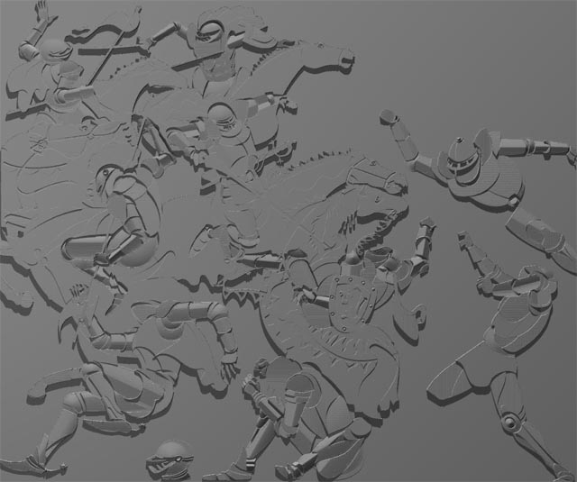

Yeh, we need more detailed photo(s). So if there is anybody who lives
nearby the cathedral could you take some pictures ?  :)
As far as I know Poser has also horse object(s). Could anybody who
has Poser try to make some kind of horseman relief using technique
described in this thread?
Gena.

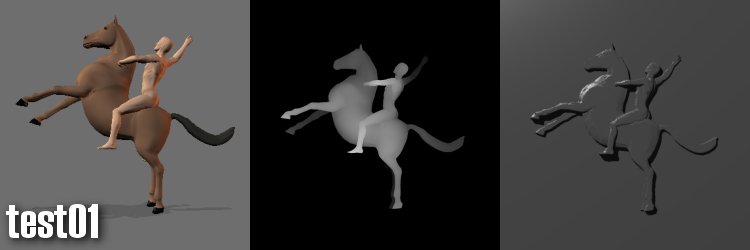

From: Peter Hertel
Date: 8 May 2003 15:06:27
Message: <3ebaaab3@news.povray.org>
> Darren Hewson wrote:
> > Found a nice close up...
So that's what it looks like! :) Thanks a bunch!
> My newsreader broke the first link between "top." and "half.jpg" but
> strangely enough, I got the image anyway, just in even higher
> resolution. The same works for the other image: drop the "half." and
you
> get the image in double res.
Ain't you a tricky one ;) Tak!

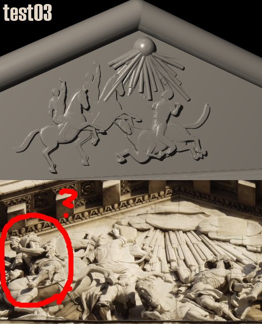

If the final resolution are to be 6000x8000 the triangle will then be
about 1050pixels wide, or? I just need a feeling of how detailed it has
to be.
I've attatched my first test render, and looking at the new reference
pictures I think I can get away with it if I do some helmets in Wings.
And perhaps a sword, and some nice outfits and armor and.. :) Hmm.. The
casual Poser 3 man might look better because he has a t-shirt on.. This
is fun! *running away playing more*
-Peter

From: Ib Rasmussen
Date: 8 May 2003 15:48:36
Message: <3EBAB4FA.7060205@ibras.dk>
> to be.
I get the triangle to be close to 25% of the image width, at its widest,
which is 1500 pixel. I don't have the exact size of the triangle, as it
is going to be the last part, that I model, unfortunately, due to the
way I'm working through the building. The acute angles a going to be
close to 27 deg, though.
Looking very promising.
/Ib
Gena, exactly how did you generate that second image?

From: Gena
Date: 8 May 2003 16:44:03
Message: <3EBAC193.936E4848@mail.com>
Jim Charter wrote:
> Never mind, I see now.
Just a clarification for the other people :) The texture should look
smth. like:
pigment {
    gradient -z
    color_map {
        [0 1 color rgb 0 color rgb 1]
    scale ...
    translate ...
finish{ambient 1}
The main problem is  that scale... translate ... block. You have either
to know minimum and maximum Z coordinate of your object or just
play with it.
Gena.
From: Peter Hertel
Date: 8 May 2003 18:44:15
Message: <3ebaddbf@news.povray.org>
widest,
it
Ok, I'll do some dummy boxes to test with.
Here is another test with the reference picture embedded for comparsion.
Is there need for much more detail? I need to postion the bodies so that
they give more depth. And by the way, you can't open the mouth of the
horse in Poser 3.
If anyone is interested, I did it like this:
Posed a horse and a casual male in Poser.
Exportet to obj, then to pov via PoseRay, fixed the textures.
Used a texture similar to Gena's and rendered a orthographic view or the
model which I saved in resolution 1000x1000 (png).
When I had two such greyscale maps, I used them as height_fields and
positioned them together with the temporary csg sun, then I did another
orthographic shot and saved the last heightfield.
But now a question, what is the man to the far left doing? ("O" marks
him ;-)
Is he bending his hip in some insane position, or is there two people on
the horse? Is he strangeling himself or covering his eyes?
Perhaps I'm too tired..
-Peter

From: Ib Rasmussen
Date: 9 May 2003 02:17:33
Message: <3EBB4862.2040508@ibras.dk>
> him ;-)
He is coverings his eyes. As for the leg, it may be distorted a bit, to
avoid having it stick out of the relief.
/Ib

From: Gena Obukhov
Date: 9 May 2003 03:13:14
Message: <3EBB5344.CD465EBF@mail.com>
Good start.
Usually more details - better ;)
Maybe it's better to have the whole scene and apply that gradient texture
to all objects (?) This way you don't loose heightfield quality. The only
problem can arise here - a lack of memory for the herd of horses :)
Gena.
From: Peter Hertel
Date: 9 May 2003 04:27:31
Message: <3ebb6673$1@news.povray.org>
Yeah, I'll work on that. It looks a bit flat, if I manage to get better
depth in the image it might help as well. Perhaps doing some manual painting
on the image_map will make it look better too.
As I'm only in the early tests I did it this way because it was much
quicker. It's also much easier to tweak the gradient texture when you know
the exact size of the object. But if I save the first height_fields in
resolution 3000x3000, it should be enough, no? That'll take a lot of memory
too, though..
-Peter

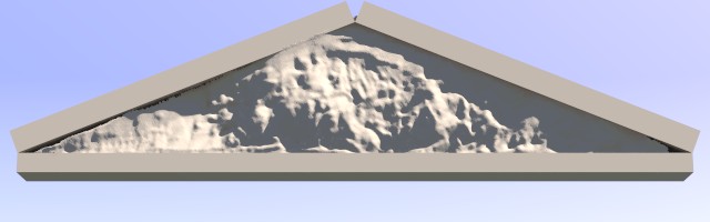

From: Ib Rasmussen
Date: 13 May 2003 16:55:54
Message: <3EC15C3D.4050302@ibras.dk>
The tympanum is now ready for your heightfield. The angles endedup being
only 26 deg, I hope that does not affect your work too much.
/Ib
Download 'teststpaul05.jpg' (67 KB)
Preview of image 'teststpaul05.jpg'
From: Gena
Date: 14 May 2003 12:56:11
Message: <3EC2752F.DDA3EE12@mail.com>
Wow! Very impressive!

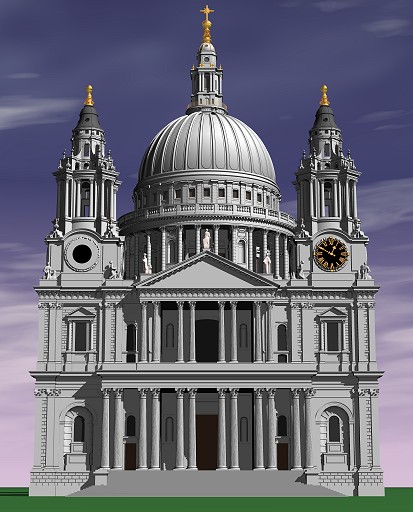

I think it's the best architectual CG object I've ever seen.
Are you still working on it? I'd like to add it to my changes and
render the scene (hopefully this week).
Gena.
Well, thank you, but I hope not. I have done at least two other churches
with a lot more precision and detail :)
I have some minor adjustments to do, and I would like to try and fit it
into the scene as closely to the painting as possible. Have you done any
changes to the camera since your last posted version?
/Ib

Ib:
It really is incredible.  I admire you patience and good eye
for proportion and detail.
Aaron
Yeh, I know. But I like this one more, I don't know why :)
What do you think about textures? I could suggest you some
image maps for dome and walls. I know that you are POV-Ray
purist and don't like any image maps :) but I think image maps
will look more real-life than procedural textures.
> Have you done any
No.
Gena.

From: Peter Hertel
Date: 15 May 2003 13:40:25
Message: <3ec3d109@news.povray.org>
being
Not at all, and that's an incredible model you've created!
Sadly I've not been able to do much work on my part lately, been a busy
week in RL(TM). What I've done is created some objects (helmet, sword,
some cloth) in Wings3D and added them to the figures in Poser, in
addition to repose the things. I've also done what Gena suggested and
included all the figures in the scene, thus only produsing one
height_field. I think I'm also going to do some manual editing to the
image to increase the details in some places.
Download 'hf_final.jpg' (11 KB)
Preview of image 'hf_final.jpg'
From: Gena Obukhov
Date: 16 May 2003 01:06:34
Message: <3EC4700B.8DD782ED@mail.com>
That reminds me my very old picture in traditional media:
http://propro.ru/go/gallery/images/knights.jpg
The following image is my attempt (which lasts two years :)
to do the same on computer. And the second image is a
heightfield created from the first image.
Gena.
Download 'knights1.jpg' (51 KB) Download 'knights2.jpg' (45 KB)

From: Ib Rasmussen
Date: 18 May 2003 10:41:18
Message: <3EC79C1E.8080504@ibras.dk>
Peter Hertel wrote:
> I'd like to use PNG if it's okay, and the filename can be something like
> "cathedral_relief.png" all lowercase. Or use anything you like, it
> wouldn't matter to me.
PNG is fine. It doesn't really matter, as long as we agree.
> What resolution and aspect ratio are you going to use? Are you going to
> use CSG to cut out a triangle of the height_field?
Yes, I'm cutting the hf. Here is the code:
#declare FcdPedimentTympanum=difference {
    object {
       height_field {png "cathedral_relief.png" smooth }
       scale <700, 20, 171>
       rotate <-90, 0, 0>
       translate <-350, 0, 0>
    plane {-y, 0 rotate <0, 0,  26> translate <-350, 0, 0> }
    plane {-y, 0 rotate <0, 0, -26> translate < 350, 0, 0> }
    plane {-z, 0 translate <0, 0, 1000> }
For some reason, I don't quite understand, my dummy hf projected out
very far behind the facade, that's why I cut with the -z-plane.
/Ib
