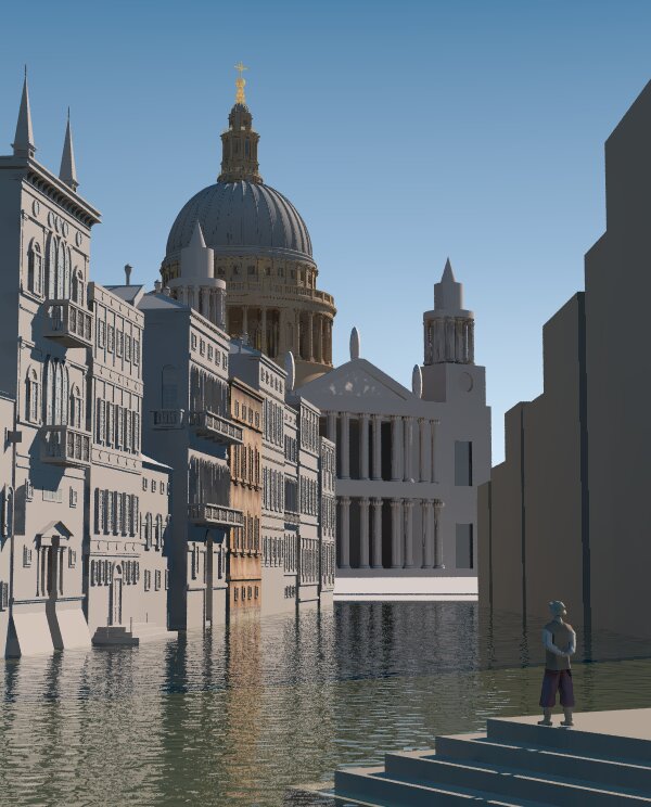

From: Gena Obukhov
Subject: Capriccio v.9
Date: 13 Apr 2003 01:18:31
Message: <3E98F173.23F2BA63@mail.com>
We cancelled fishing today because of bad weather.
So I had some time to work on the image :)
Added the rest buildings to the left side. Modified some
previous buildings.
Made some changes recommended by Christoph Hormann.
Added bindings to the dome recommended by Ib Rasmussen.
Rearranged some objects.
The source is in p.b.s-f.
As a next step I'll paint those buildings. If you have a good
paintbrush or airbrush you can join me :)
Gena.
Download 'capriccio.jpg' (80 KB)
Preview of image 'capriccio.jpg'

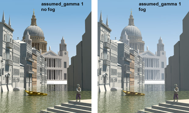

From: Gena Obukhov
Subject: Re: Capriccio v.9
Date: 13 Apr 2003 12:30:13
Message: <3E998EE1.410D85A@mail.com>
Christoph Hormann wrote:
> The most important point - 'assumed_gamma 1' - is still missing.  I
> strongly suggest to add it (or to apply gamma correction afterwards if
> preferred) before working on the textures.
Here is image with assumed_gamma 1
Should we change any other parameter(s)?
It looks too dim for me.
Gena.
Download 'capricio.jpg' (69 KB)
Preview of image 'capricio.jpg'

From: Gena Obukhov
Date: 13 Apr 2003 13:14:52
Message: <3E99995B.CDE624D0@mail.com>
Ken wrote:
> For me it's much brighter now.
Yep. When I said 'dim' I meant that there is too high grey
component in all colors. It makes colors a bit dull.
Maybe we have to reduce brightness of the light source.
Gena.
Date: 13 Apr 2003 15:13:58
Message: <3E99B6F5.BC7638F6@gmx.de>
That's precisely what i am talking about all the time.  The textures and
lighting need to be adapted to produce the intended results.  Changing one
thing (like the gamma correction) will result in a large mess.
The version with the water i posted contains lighting and some provisonal
textures for usage with assumed_gamma 1.  Most important things probably
are:
- reducing radiosity brightness (to 1.0, lower could even be better)
- make the sky darker
- change the finishes (scratch any ambient if there is, i have the
impression it is not 0 but maybe it's just the fog)
- change the colors of the objects if necessary
Last updated 28 Feb. 2003 _____./\/^>_*_<^\/\.______

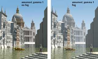

I removed 'ambient' from all textures (except cathedral facade),
reduced radiosity brightness to 0.6, reduced 'diffuse' to 0.6 and
reduced sky brightness.
You can see the result below. Let's decide which value for
assumed_gamma we should use.
IMHO we should use something from the middle 1.4-1.6 even
though such value is not right from theoretical point of view :)
Gena.
Download 'gamma1.jpg' (80 KB) Download 'gamma2.jpg' (84 KB)

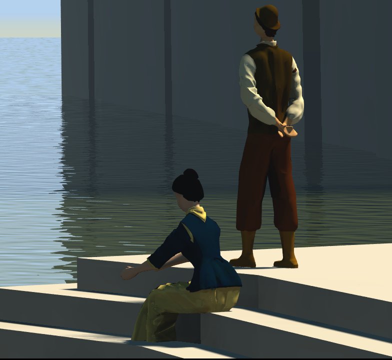

From: Jim Charter
Subject: Re: Capriccio v.9 update on figures
Date: 13 Apr 2003 22:37:28
Message: <3e9a1ee8@news.povray.org>
Download 'v9.jpg' (57 KB)
Preview of image 'v9.jpg'

From: Gena Obukhov
Date: 14 Apr 2003 03:22:02
Message: <3E9A5FE8.A1874BD2@mail.com>
Great models! Especially for completely hand-made models.
We have a family already :)
There are some visible artefacts but I think you are
aware of it.
Keep on good job Jim :)
Gena.

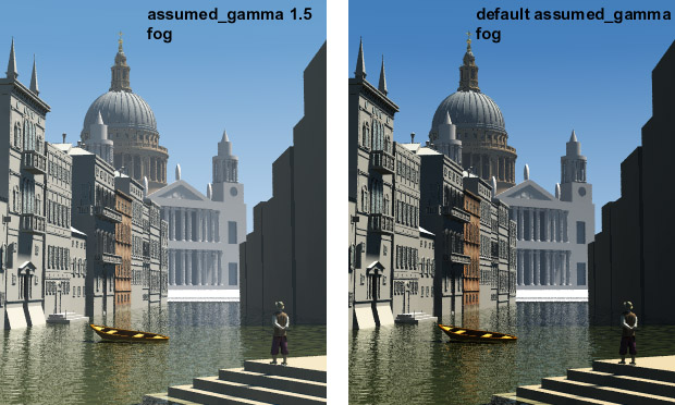

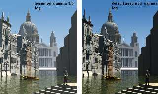

What was the monitor_gamma used for creating these images? Unless
everyone viewing them has monitors of that gamma value they are useless
for comparison. Surely an assumed_gamma value should be chosen such that
when someone renders the scene on their computer with the monitor_gamma
set for their monitor, a ray calculated to have a color of <0.5, 0.5,
0.5> is displayed as a grey perceived to have 50% of the monitor's full
intensity. That value is 1.
