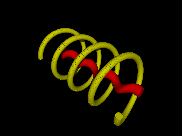

Hi,
  I was wondering if any of you knew how to make the following red
isosurface into something that look more like the yellow cylinder CSG?
ie. scaling the sinusoidal shape of the isosurface, but keeping the
small radius it has.
Here's my code for the iso:
#declare a = 100;
#declare b = 25;
isosurface {
  function { a*x*x + a*y*y  + b*x*cos(z*2*pi) + b*y*sin(z*2*pi) }
Thanks,
  Simon

From: Mark Weyer
Subject: Re: Thightening an iso?
Date: 16 Dec 2002 06:38:42
Message: <3DFDBDAE.DA9E4B5B@frege.mathematik.uni-freiburg.de>
I assume you want to have a coil. Here is mine:
#macro pre_coil (l,r2,r1,steepness)
  #local rmax=(r1)+(r2);
  #local dmax=rmax*sqrt(2);
  #local omeg=(steepness)/(r2);
  #local pre_plane_stretch=1/(1+omeg*omeg);
  #local plane_stretch=sqrt(pre_plane_stretch);
  #local sqrsum=function(a,b) {a*a+b*b}
  #local sqrsum_=function(a,b,c) {a*a+b*b+c*c}
  #local coil_aux1=function(a_,b,c)
    {atanf(c*cos(a_)+b*sin(a_),b*cos(a_)-c*sin(a_))}
  #local coil_aux2=function(r,phi) {sqrsum(r-(r2),plane_stretch*r*phi)}
  isosurface {
    function {coil_aux2(sqrt(sqrsum(y,z)),coil_aux1(omeg*x,y,z))}
    contained_by {box {<0,-rmax,-rmax> <l,rmax,rmax>}}
    threshold (r1)*(r1)
    max_gradient 2*max(r2,sqrt(sqrsum_(
      (dmax-(r2)+pi*pi*pre_plane_stretch*dmax),
      (pi*pre_plane_stretch*dmax)
      (pi*omeg*pre_plane_stretch*dmax*dmax))))
    all_intersections
#end
is wraps around the line from <0,0,0> to <l,0,0>.
r1 and r2 are like the small and large radius of a torus.
steepness is the ratio of swirling to moving:
0 gives a straight cylinder, 1 gives an angle of 45 degrees,
-1 also, but in the other direction.
The usual screw will have positive steepness.
Comments welcome.
  Mark

From: Simon Lemieux
Date: 16 Dec 2002 17:18:03
Message: <3DFE51DC.E3C8F1B@no_spam.com>
Geez...  Maybe you could explain to me how to modify my isosurface.
My problem is that I don't actually want a coil, I want much more, but
as a start, a coil would be fine!
Is it possible to have my isosurface make a "round" shape on the z axis
between (-x), (x), (-y) and (y), given a sinusoidal function that I
would define myself like this:
#macro myFunc(xy, z)
  #if(xy == 0)
    d*cos(z)
  #else
    d*sin(z)
  #end
#end
(not sure if syntax is alright, but that's what my function would
basically look like)
Thanks Mark,
  Simon
From: Mark Weyer
Date: 17 Dec 2002 04:51:22
Message: <3DFEF608.2F5B61A6@frege.mathematik.uni-freiburg.de>
>   #if(xy == 0)
>     d*cos(z)
>   #else
>     d*sin(z)
>   #end
> #end
I still do not quite understand, what you want.
I assume at least that it could be described by
some 2-dimensional shape that is rotated around
the z-axis as it moves along the same. In that
case you need to describe the 2D shape by some
2D isosurface (isoperimeter, that is). Lets say
that is described by f(x,y)=c. Then the 3D-shape
is described by
  f(x*cos(w*z)+y*sin(w*z),y*cos(w*z)-x*sin(w*z))=c
which gives an isosurface all right. Now what I
need to know is: What is your 2D-shape? In your
scene it is defined by
  a*(x^2+y^2)+b*x=c
or, equivalently,
  (x+b/2a)^2+y^2=c/a+(b/2a)^2
Now this is a circle with center (-b/2a,0) and
radius sqrt(c/a+(b/2a)^2). Maybe you would be
more happy with an ellipse? To define one with
radii rx in x-direction, ry in y-direction and
center (cx,cy) take
  f(x,y)=((x-cx)/rx)^2+((y-cy)/ry)^2
and threshold 1. I do not know the scale in your
scene, but maybe you would like to try
  w=1/3, cx=2, cy=0, rx=3, ry=1
  Mark
From: Simon Lemieux
Date: 17 Dec 2002 20:20:02
Message: <3DFFCE01.FA9D64CB@no_spam.com>
I'm sorry if I don't explain myself correctly...
That's it...
> In that
> is described by
>   a*(x^2+y^2)+b*x=c
> or, equivalently,
> center (cx,cy) take
The circle is the shape I'm looking for, probably an elipse would make a
better result but it would have to rotate onto its center to make the
scene look right.  The circle is good!
So grabbing what you showed me, I guess this might give the results I'm
looking for...
#declare R = 0.1;
#declare Circle = function { pow(((x)/R),2)+pow(((y)/R), 2) }
isosurface {
  function { Circle(x*cos(w*z)+y*sin(w*z),y*cos(w*z)-x*sin(w*z)) }
Though, this gives me error in MegaPov, so I wasn't able to see the
results, I believe I missed something somewhere. It tells me that
instead of the first pow in the Circle function, it was looking for a
float factor.  What should I do?
Thanks,
  Simon
From: Mark Weyer
Date: 19 Dec 2002 08:39:13
Message: <3E01CE73.A753C45D@frege.mathematik.uni-freiburg.de>
> looking for...
> #declare R = 0.1;
> isosurface {
OK. Some comments:
- Add (x,y) after function in the definition of Circle.
- declare w somewhere. It determines how fast the shape turns.
  Try 1 and adjust as needed.
- Your shape is a circle with the origin as center. As you turn this
  around the origin, nothing changes. Perhaps you want to move the
  center somewhere else. That's what cx and cy were for. To make it
  clear: This is the center _prior_ to turning. In fact the ,,real''
  center will move along a spiral.
Yours,
  Mark
From: Mark Weyer
Date: 19 Dec 2002 08:42:58
Message: <3E01CF55.163390BB@frege.mathematik.uni-freiburg.de>
Oh, and don't forget threshold 1 and a high enough
max_gradient. I did not see anything before I used
maxgradient 10000. But that was experimental.
  Mark
