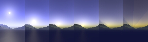

Here is some test output from an ongoing project of mine to come up with
a flexible atmosphere model which would provide blue skies, hazy skies,
red sunsets, yellow sunsets, etc, etc. ... all in one package. I based
my breakdown of the atmosphere on the Terragen model; specifically, a
"simple haze" (or fog) component, a blue scattering media component and
a "reddening" (or blue absorption) component. The whole technique is
still not really stable yet, so sorry but no source at this time.
The following images show the sun at elevations of 30, 15, 8, 6, 2 and 0
degrees above the horizon with the only variable being the sun
elevation. This is actually a bit of an exception since a noon sky and
an evening sky often want specific components tweaked (e.g. light
intensity, scattering color etc.) for the best effect. Actually, you
have to do this in Terragen too.
I'm pretty sure the sharpness of the "rays" in the last couple of images
are sampling artifacts - I just haven't been able to locate the
offending statement.
While I'm happy so far with the results, my big question is
incorporating clouds (media or pigment) and how they will be treated by
the atmosphere.
Render time for this series was approx. 15 minutes on a 90 MHz pentium.
Not too slow, but not very fast either.
Any comment or criticism on this series of postage stamps is welcome.
Abe
Download 'media_sunset.jpg' (39 KB)
Preview of image 'media_sunset.jpg'

Very interesting!
"Abe" <bul### [at] taconicnet> a écrit dans le message de news:
3D7A4E47.5F24F970@taconic.net...
Great!
Uncreasing intervals won't help?
> the atmosphere.
Pigment on stacked planes?
Don't you mean an 900Mhz?
> Abe

Have you tried increasing intervals and or samples - even with method 3 I find
changing intervals can have a profound effect.
Mick
Certinly, but there are several media statements and in the interest of
speed, I don't want to increase samples indescriminantly.
Take your pick. The concern is how well they will fade into the atmosphere
(as the terrain does).
I wish. :)
From: Abe
Subject: Re: sun setting in media atmosphere
Date: 7 Sep 2002 20:30:04
Message: <web.3d7a97b245a2d2e06895cad0@news.povray.org>
Mick Hazelgrove wrote:
>Nice work
>Mick
Thanks.
I know I might need to increase samples/intervals, but there are several
media statements and I have not yet determined which is the offending one
I just don't want to do it across the board.
Increasing the sampling on the obvious (to me) media statements - i.e.
scattering - only made for minor improvement. I'm beginning to think,
however, that the primary culprit is the point light throwing hard shadows.
Abe

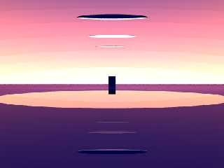

Hi All,
The included image is one I've been developing independantly, but with
simular goals.  Spesifically using media to create atmospheric sunsets.
As you can see I have simular striping and increasing sample sizes (even to
being absurdly large) has not helped.
> the atmosphere.
My plan is to replace the spheres with a dence white or off white scattering
media,  I'm still working on how to deturmine density and distribution
How many different media are you using?  In the image below I have 2 with
different color values.
Keep me up to date, I'm interested in what you discover about clouds.
JFMILLER

From: hughes, b
Date: 8 Sep 2002 02:18:35
Message: <3d7aebbb$1@news.povray.org>
90MHz Pentium CPU, huh? You have patience. Most of my home budget goes
toward the computer, second only to life's other neccessities :-)
It isn't multiple media containers as well, is it? That could certainly
make the media mangle, especially when different sample counts are used
I believe. But this just looks as if the samples are too low.
The atmospheric effect is working nicely anyhow.
