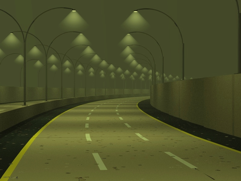

Something inspired by a stretch of state route 17 (aka I86) in New York state. I
travel this road on return trips to my home in Vermont after visiting my 2 kids
in Pennsylvania. It is very early in the morning when I pass and I am usually in
a funk. Comments?
Bill P.

From: Slime
Subject: Re: A current WIP 88k
Date: 6 Sep 2002 17:14:12
Message: <3d791aa4$1@news.povray.org>
Are there really that many street lights?
Try reducing the amount of light in their cones and/or increase the fog. You
have too much emmision and too little absorption; it looks unrealistic.
 - Slime

From: Xplo Eristotle
Date: 6 Sep 2002 17:22:18
Message: <3d791c8a@news.povray.org>
> a funk. Comments?
Perspective seems a tad high to me.. are you driving a truck?
Do the lights really look like that? Something about them seems wrong to
me.. like their interaction with the media is too bright or something.
Other than that, there's something that bugs me about the scene.. maybe
the modeling is too primitive. Textures look fairly convincing. It might
be interesting if you could make the scene look more like it might from
inside a vehicle.. part of a dashboard, some reflection on the inside of
a windshield, things like that. Oh, and of course the front of the
vehicle sticking out...
-Xplo

From: William F  Pokorny
Date: 7 Sep 2002 03:22:50
Message: <3D79A949.FCF3CBB4@attglobal.net>
Yes, there are a bunch. It is a section of road recently rebuilt. The lights are
high (or low) pressure sodium. However, these lights are pretty much
mono-chromatic and I just haven't been able to get the right look in a render.
I used mercury vapor in the image. They render better - and I like the name.
This section of road is incredibly bright. Imagine the brightest service area
you stopped at on a dark night and then add some more light....
Thanks. I agree.
Bill P.
Date: 7 Sep 2002 03:38:41
Message: <3D79AD01.5601EEBD@attglobal.net>
Well done! I laughed when I read this! Yes, the height is set for a truck though I do
not drive a truck but a Saturn VUE -  a small SUV. I confess to raising the camera
position to see more of the road. I have thought about completely different
perspectives too. Perhaps that of an owl flying overhead?
I agree, and I think Slime hit the biggest reason why.
I find myself in a similar place with this image and I too have thought about
sticking the viewer inside a vehicle. I just don't know if it is right for the
feeling I want to convey....   I will continue to think about it.
Thanks.
Date: 7 Sep 2002 13:52:24
Message: <3d7a3cd8@news.povray.org>
I'm not sure exactly what you want to convey, but based on the image and
your previous post, I'm guessing that you're going for something kind of
somber and contemplative, which is think is doable with the right
lighting. I don't really know how to express the scene in my mind, though.
-Xplo
Date: 7 Sep 2002 13:59:43
Message: <3d7a3e8f@news.povray.org>
 > The lights are
Are those the bright yellow ones that seem to destroy most of the colors
viewed under them, like you were looking through a yellow filter or
something? If so, you might consider using Photoshop (if you have it) to
post-process the image.. might be easier than trying to get the right
look inside POV-Ray (with all the associated test renders).
-Xplo
Date: 8 Sep 2002 11:14:29
Message: <3D7B6955.E64B36D4@attglobal.net>
Xplo,
Yes, they emit almost all energy at 589nm, if I remember.   I had
thought some about using a post render filter though I do not have Photoshop.
I tried to 'pre-process' the pigments in all my textures, but so far at least
I have not gotten it right.   Have others gotten this kind of thing to
work?
If I write the filter myslef, I am pretty sure I need to figure out the
minimum intensity of color I can keep in the RGB ratios which best match the
wavelength of the real color? Am I off track?
Bill P.
> -Xplo
Date: 8 Sep 2002 13:59:59
Message: <3d7b901f@news.povray.org>
I hate to tell you this, but I really have no idea ^^;
What you need here is some kind of yellow filter that lets yellow pass
through unaltered but mostly blocks other colors of light, and I'm not
really sure how you would simulate this in POV-Ray post-processing.
Depending on how well POV-Ray simulates light frequencies (something
which might make a good POV 4 feature request, as it would replace the
presently-hacky photon dispersion, allow for more realistic light
scattering in atmosphere, allow for more controllable irridescence, and
so on, but I digress) you could try making all the lights strongly
yellowish and see if you get the proper effect.. but I suspect you won't.
-Xplo
