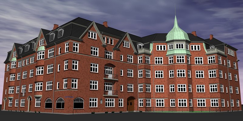

Just thought I would show you what I'm working on at the moment.
The building is only intended as background for a church model, so it is
not done with the same level of details, as I usually do, but at this
distance I think it is passable.
Now I only need to do one more building of the same size, and I'm ready
to put the scene together. OK, I also need some streets and sidewalks.
And some trees - perhaps a couple of cars - some streetsigns, maybe...
/Ib
Download 'bygning4.jpg' (94 KB)
Preview of image 'bygning4.jpg'
From: Aaron Gillies
Subject: Re: Building
Date: 31 Aug 2002 20:10:01
Message: <3d715ad9$2@news.povray.org>
Wow ...
Very cool.  How about adding some discoloration to the metal
on the roof?  If it's weathered enough to turn green,
you would think that it would have acquired a little bit of
a warmer patina.
It looks really neat.  Don't know what else to say ...
Aaron

From: Ib Rasmussen
Date: 1 Sep 2002 04:43:58
Message: <3D71D334.7010506@ibras.dk>
> a warmer patina.
Actually, the colour of the cobber on the real building,
that I am modelling it from, is very uniform. The cobber part
under the top row of windows has a bit more variation, but frankly,
since it is only going to be used as a backdrop for another building,
I don't want to use too much time on details.
Nothing more is needed :)
/Ib

From:
Date: 1 Sep 2002 17:09:59
Message: <3d728227$1@news.povray.org>
I don't know if this is my monitor playing tricks on me, but the bricks seem
to form strange semicircular shapes and they flow in odd patterns... It's
probably all positioned perfectly, but to me the wall-texture appears warped
in odd ways...
but else it looks truely wonderful, certainly for some background thingy
From: Ib Rasmussen
Date: 2 Sep 2002 05:12:03
Message: <3D732B4A.6020606@ibras.dk>
> in odd ways...
The brick pattern creates a moiré artifact, that I'm not able to get rid
off. I have tried a number of different anti-alias settings but nothing
helped. Higher resolution helps, as you can see in the attached detail
image, but I didn't want to post a 2400x1200 image in the news group.
Thank you.
If you'd like to see more pretty moiré patterns in brick textures, I
have a sneak preview page at
http://www.ibras.ishoejby.dk/sktmarkus/stmarkus.htm
/Ib

From: Norbert Kern
Date: 2 Sep 2002 10:20:04
Message: <web.3d737379a0d743fed02f1080@news.povray.org>
There were some threads dealing with such antialiasing problems.
For me, Kari Kivisalo presented a convincing solution.
In http://news.povray.org/povray.newusers/23381/ you can find the according
discussion.
Beside, I´m really admiring your architecture models.
Perhaps there will be a time, when you will share the source code with us.
Norbert

From: Ib Rasmussen
Date: 2 Sep 2002 11:18:54
Message: <3D738144.9020104@ibras.dk>
Yes, his technique does seem to give better results, than I was able to
get with antialiasing alone.
Well, there is not much to be learned from my source. It is just
thousands of lines of unions and differences of boxes, spheres, planes,
cylinders, torii and the occasional cone. But if you insists, I am
willing to post the code for this model. It is 4100+ lines of code, with
very few comments (and those there are, is in Danish :)
/Ib
From: Ib Rasmussen
Date: 2 Sep 2002 11:23:45
Message: <3D738268.6060501@ibras.dk>
> It looks a little bit artificial more like a model
> than the real thing, but if I remember correctly, that's what you're after.
Yes, I do like the hyperrealistic (if that's a word) perfection, that
only raytracing can produce. If I wanted photorealism, I could use my
camera, since most of the buildings, I model, exists.
/Ib
From: Norbert Kern
Date: 2 Sep 2002 15:35:06
Message: <web.3d73bbc3a0d743fa183f11c0@news.povray.org>
Ib Rasmussen wrote:
>... But if you insists, I am
>/Ib
Hi Ib,
if that is all I have to do, I do insist. ;-)
I always like rendering pov code, because with very good models I
intuitively can imagine a realistic scene.
By example I always render all IRTC source code. It is my way to learn
Pov-Ray.
Norbert
From: Ib Rasmussen
Date: 2 Sep 2002 16:13:45
Message: <3D73C65F.7030306@ibras.dk>
>>... But if you insists, I am willing to post the code for this model.
OK, you will find it in p.b.s-f. There is a couple of pre-defined camera
positions you can try.
Oh, and I just remembered: it is set up for a 3:2 format. If you'd
rather use 4:3 change the imageratio vector in the .pov-file.
And please note that the glass texture is, eh.. experimental.
/Ib
