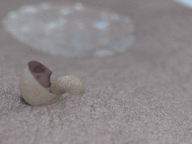

Here is the image exhibiting the unexpected (but not unwelcome) focal
blur effect. Normally, I would expect a circular region of clarity with
blurring around it. In this case, there is a horizontal swath of "in
focus" area, with the blurring above and below:
Download 'oddblur.jpg' (44 KB)
Preview of image 'oddblur.jpg'

The plane of focus is always parallel to the "camera-plane" (unless you
sheared the camera). So you will never have a circular "spot" of focus,
but always something linear / planar.
Ingo

You have a "line" of focus because this represents the locus of equidistant
objects (surfaces?) from the camera when you have a plane slanting away from
you.
If instead you had say  a uniform field of particles (say an isosurface of
f_noise3d), then you would be right to expect a circular area to be in
focus, as these would be equidistant from camera.

Quite acceptable if there were a plane tilting away from me. The object covered
with sand particles (440k, count 'em) is an <ahem> f_noise3d isosurface   ; }
Dave

No. The area in focus should be the space near the surface of a sphere
around the camera, with a radius of the distance between the camera location
and the focal point. That is, all points that have the same distance from
the camera as the focal point does should be in focus.
The docs may be misleading here.

Well, that makes sense then, and reinforces my original idea that the cause of
my particular odd blurring was that my look_at and my focal_point were two
different vectors. If they are the same, this imaginary "sphere" around the
camera will intersect at one point, i.e. where look_at/focal_point coincide. If
they are different, there should be an arc shaped ring between the f_p, and the
l_a, which is exactly what I experienced.

Hmm? No, the look_at point has *absolutely nothing* to do with focal blur.
If you have a focal point 2 units away from the camera, and a look_at point
2000 units away from the camera, then everything 2 units away from the
camera will be in focus.
The arc is caused by the intersection of the surface of the sphere with the
surface of the plane.
