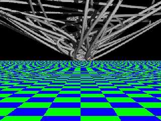

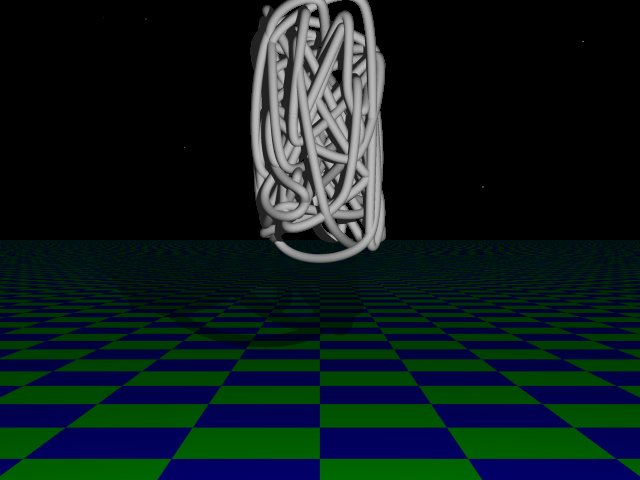

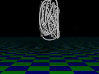

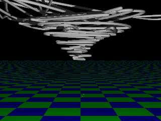

Observe figure 1.  Randomly-filled-with-sphere_sweep
cylinder.  Good.
Observe figure 2.  Randomly-filled-along-xy-axes,-
but-the-z-axis-isn't-random.
I want figure 2 filled with the randomness of figure
1.
How do I do that?
Tim Cook
Version: 3.12
Download 'junk2.jpg' (39 KB) Download 'junk.jpg' (55 KB)
Preview of image 'junk2.jpg'
Preview of image 'junk.jpg'

From: Timothy R  Cook
Subject: Re: I'll ask for help here, too
Date: 14 Aug 2002 13:52:22
Message: <3D5A98D1.8030606@scifi-fantasy.com>
Bill DeWitt wrote:
>     It probably really is, but to get to the bottom in the diminishing space
> available, while still varying in xy, it can't look like it is very much.
> You may need more z in your randomness rather than more randomness in your
> z.

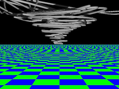

Er...huh?  The Z isn't random.  How do I know?
observe figure 1, which uses following:
sphere_sweep{
#declare points=100;
cubic_spline points,
#declare Seed=seed(10000);
#declare N=1;
#while(N<=points)
#declare Theta=rand(Seed)*360;
#declare Z=(N/100)+1.2;
#declare R=(rand(Seed)*0.25)+((Z-1.2)*(Z-1.2)*2);
#declare X=R*cos(Theta);
#declare Y=R*sin(Theta);
<X, Y, Z> 0.02
#declare N=N+1;
#end
texture{ pigment{ color rgb <1.0, 1.0, 1.0> } }

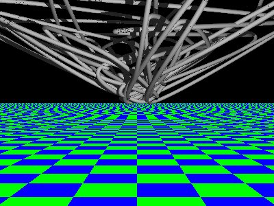

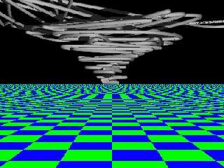

observe figure 2, which uses following:
sphere_sweep{
#declare N=1;
#while(N<=points)
#declare Z=rand(Seed)+1.2;
<X, Y, Z> 0.02
#declare N=N+1;
#end
I want the jumbled-upness of figure 2 in the shape of
figure 1.  figure 2 has the random points, but they're
selected in such a way that parts of the sphere_sweep
are drawin outside the curve.
Tim Cook
Version: 3.12
Download 'junk3.jpg' (43 KB) Download 'junk4.jpg' (50 KB)
Preview of image 'junk3.jpg'
Preview of image 'junk4.jpg'

If R_env= envelope you want to keep it in, then
the envelope depends on where Z is so
R_env = f(Z)
It looks like you described it as something like
R_env= (Z+1.2)^2
I would find Z first and then use it to find the envelope and then
find X and Y
Z=rand(Seed)
R_env = (Z+1.2)^2
R=R_env*rand(Seed)
X=R*cos(Theta)
Y=R*sin(Theta)
This is independant of your while loop (N variable)
There may be rare occurances where your line points may be within your
boundries, but the path of the line might cross back and forth.
Tony
