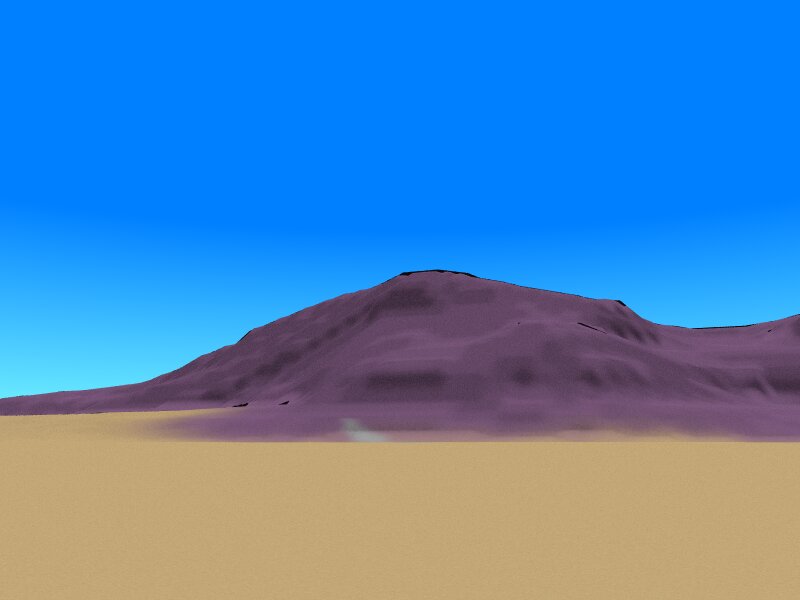

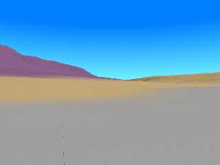

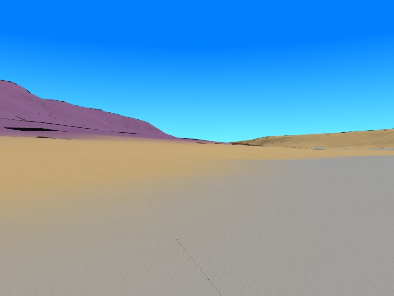

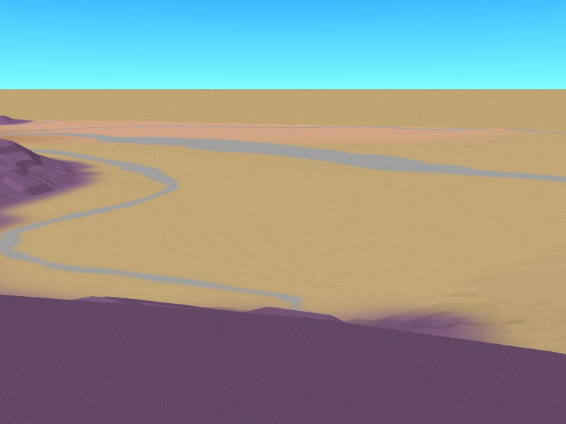

Hi tracers!
Finally, after 15 weeks of cumbersome 16bit HF pixeling (425,000 pixels
placed manually!), I got together the first small slice of southern
Kandahar province, covering an area of 10.795 by 25.4 kms.
Then after battling with a texture bitmap at a 10 times higher
resolution (4,250 by 10,000 pixels) which even under Linux brought my
system to the verge of crashing (while editing with the GIMP, I had to
use several layers), I started to render the first views of the scenery.
There is also the question whether smooth pigment/texture transition on
a HF can be done procedurally rather than with such huge bitmaps, but at
the moment, this is not the main problem.

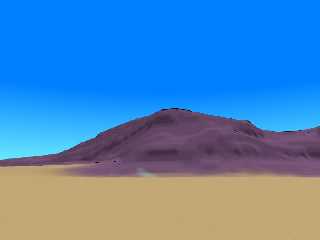

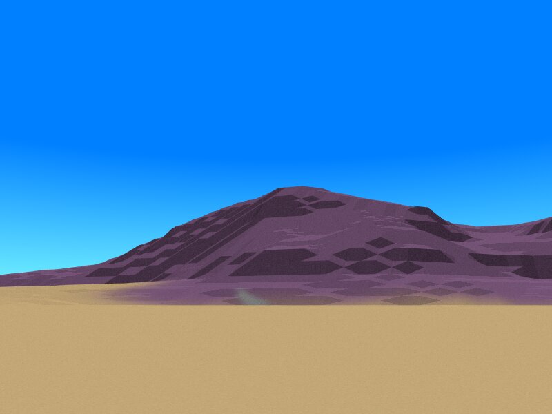

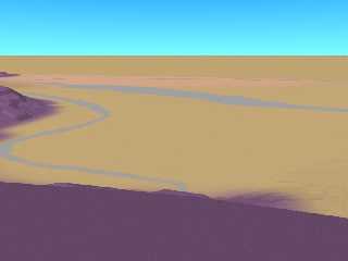

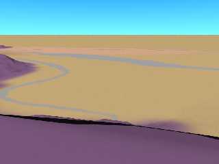

Instead, as you see in the images attached here, whenever I used
"smooth" with the HF, strange shadows appeared where no shadows should
be at all... without "smooth" they disappear (see images with a 'b' in
their filename).
Is there a way to avoid this - or is it just a bug with which I've to
learn to live?

From: Mick Hazelgrove
Subject: Re: Return to PoVghanistan - smooth HF bug in 3.5? (6 x JPG 800 x 600, 180 KB)
Date: 10 Aug 2002 11:56:01
Message: <3d553791@news.povray.org>
Hi Jorg
If you use a normal on the HF the dark shapes will generally dissapear.
Mick
From: Marc-Hendrik Bremer
Date: 10 Aug 2002 12:01:22
Message: <3d5538d2@news.povray.org>
"Jörg 'Yadgar' Bleimann" <yad### [at] tiscalinetde> schrieb im Newsbeitrag
news:3D553C59.7D7659C6@tiscalinet.de...
> their filename).
This seems to be the known bug with smooth heightfields. Try
"double_illuminate" with the Hf, this should remove the black spots. If this
does not work, you may want to try to make an Isosurface out of your
image_map. This might be to slow (depends on the necessary max_gradient),
but IIRC there are no such problems wih isosurfaces. Interpolate the
image_map by "interpolate 4" (I think method 2 does not work well in this
context). This should remove those black-spot-artefactlines, too.
In it's current state, your afganistan does not look at all as pre-war, to
the opposite it looks like same nukeular-war :-) BTW, are you sure you got
the scale right? I can't imagine any reasonabele scaled buildings and people
in conjunction with those hills/mountains.
I hope, you'll achieve what you are trying!
Marc-Hendrik

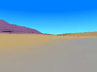

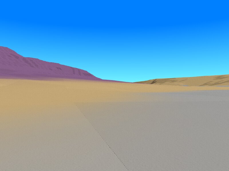

From: Jörg 'Yadgar' Bleimann
Date: 10 Aug 2002 13:53:39
Message: <3D5561E0.F372B6EA@tiscalinet.de>
High!

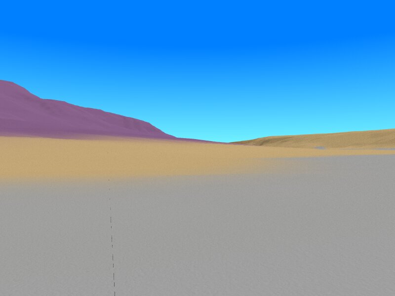

This worked perfectly, but there is still something unfixed - in the foreground
of the attached image, the light grey surface of the dry river bed looks
perforated!

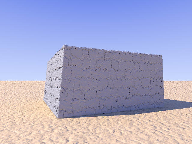

Before finishing for today, one last practical question: how do I get the
typical irregular structure of adobe walls? Of course I could use some turbulent
normal (which pattern?), but I unfortunately suffer from the ambition to do
everything as accurate as possible, so you might suggest using an isosurface...
Date: 10 Aug 2002 14:14:25
Message: <3d555801@news.povray.org>
news:3D5561E0.F372B6EA@tiscalinet.de...
> High!
foreground
> perforated!
I noticed that, too. *Maybee* try to shift your look_at point just al little
bit, if look_at and the position of the camera are in a strait line, there
are some odd artefacts IIRC.
turbulent
do
isosurface...
Hm, I don't know for sure, what an adobe wall looks like (my dictionary
translates adobe with "Luftziegel"). Perhaps have al look at the
Irregular_Bricks_Ptrn in textures.inc. It's probably a good idea to choose
the used object (and method - normal or isosurf) by calculating the distance
to the camera. The mentiones pattern f.e. will work quite well as normal or
as function in an isosurface, that makes it easy to switch between both
methods.

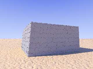

If the walls are roughcasted the granite pattern will do quite a good job
IMHO.
Date: 10 Aug 2002 20:25:02
Message: <3D55BDA6.8D1B0BE9@tiscalinet.de>
High!
No, the camera viewing direction isn't parallel to any axis, it faces
south-southwest and slightly upward!
Yes, "luftgetrocknete Lehmziegel" (sun-dried mud bricks)...
  methods.
I've tried this, but it looked very different from my notions of Afghan mud
walls - they are partly made of bricks, but
somehow the bricks are almost undiscernable, perhaps bricks and mortar look very
similar, or there is a kind of rough plaster
over them. Another type of mud wall is just formed amorphous mud, no bricks at

First try, far from perfect, but maybe a start. There should probably be
another displacment function (as Brick_Fun), to get the 'in brick cracks'.
Speaking of the third image you provided:
My problem is, that I don't understand how they build those walls. Are those
"features" the actual bricks (quite big ones) or is it some kind of plaster?
Is the more "traditional" brick wall in the upper right not jet roughcasted,
or are there simply differend kinds of walls?
Anyway here is the isosurface code for the above images (wrap it with some
scene from the insert-menu):
#include "textures.inc"
#include "functions.inc"
#include "rad_def.inc"
#declare Brick_Fun= function {pattern{ Irregular_Bricks_Ptrn  (0.08,3,1,0.4)
turbulence 0.4 scale 0.15}}
// function against the straight upper edge of the "building"
#declare YDispl=
function{select(y-1.4,0,f_noise3d(x*7.5,y,z*7.5)/7+f_noise3d(x*2,y,z*2)/5)}
isosurface {
    function { f_rounded_box(x-y/10,y+YDispl(x,y,z),z-y/10, 0.05, 3, 1.6, 3)
                   -Brick_Fun(x,y/3,z)*0.025
    contained_by { box {<-3.5,-1.6,-3.5>,<3.5,1.7,3.5>} }  // container
shape
    max_gradient 5                      // POV finds something like 82 -
increase if you notice artefacts!
    pigment{ rgb 0.9}
    normal{granite  scale 0.5}
    translate <0,1.6,0>
    rotate y*-25
Hope that helps a bit and let me know if you get stuck somewhere,
Marc-Hendrik
Subject: Re: Examples of Afghan mud architecture (was: Re: Return to PoVghanistan )
Date: 12 Aug 2002 16:48:46
Message: <3D582DFC.4C4E6271@tiscalinet.de>
High!
Hmm... difficult to say, as I myself never have been to Afghanistan and thus had
no opportunity to witness traditional construction work...
Afghanissimo!!! Truly stunning! How long did it take you? I've just begun to
learn about isosurfaces from the 3.5 manual, I'm still lightyears away from
really understanding them...
See you in Khyberspace - http://home.arcor.de/yadgar/khyberspace/index-e.html
Afghanistan Chronicle: http://home.arcor.de/yadgar/index-e.htm
Yadgar
Date: 12 Aug 2002 17:35:57
Message: <3d582a3d@news.povray.org>
news:3D582DFC.4C4E6271@tiscalinet.de...
to
from
Well, it's just a start ...
I took me about 45 minutes, because I tried some differend ideas and wanted
to use radiosity on it (to get a little more practice on it). My children
didn't help either :-). It's really quite basic.
Rendertime is 1 1/2 minute on my Athlon 1800+ without radiosity.
The isosurface tutorial is a good point to start, but it lacks one important
thing - it has no sample images for the build in functions. You might want
to have a look at the excellent tutorial at
http://www.econym.demon.co.uk/isotut/index.htm, it is updated to Pov 3.5
syntax and provides an images for each function and more. Helped me a lot.
Marc-Hendrik
