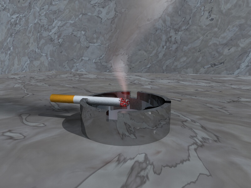

Hi all
This is one of my first attempts to make a kind of cigarette smoke.
It is a 800x600 with AA 0.3 render, with radiosity and 4 (I'll explain)
light sources (the 'sun' is an area_light). It took 4 hours on my XP
2000+ to render.
The smoke itself is a cone filled with a media whose density is a
function of my own. I had lots of pbs with the function, because if I
want a shape that matches most a real cigarette smoke's one, the
function must be very complex, and the render time reachs the sky. And
because of the color too. It seems that if I want blue reflects in the
scattering media, I need to set up his color to something like <1, 1,
0.5>. I understand it for absorption, but what about defuse light in
scattering media ? Am I forgetting someting ? Finally I choose a
scattering media with a very little extinction, and some emission and
absorption.
Not much to say about the ashtray and the cigarette (and no words about
the ugly environment :pp). The cigarette is just two cylinders with
color_maps. The red glowing part (sorry for my bad english) is two mixed
isosurfaces, one filled with a grey pigment, and the other with a red
emitting media. There are three red fading lights around the glowing
part, to make a red glow on the ashtray and on the smoke. This surely
needs to be improved, because of what happens on render time :(
Any comments, suggestions, questions ? Does anyone know how to make
realistic cigarette smoke ?

From: Skip Talbot
Subject: Re: [WIP] cigarette smoke (120ko)
Date: 29 Jul 2002 20:21:10
Message: <3d45dbf6@news.povray.org>
The red glowing part is too red and dull.  It looks like the end of the
cigarette was dipped in blood.  Perhaps a little more orange and much
brighter?

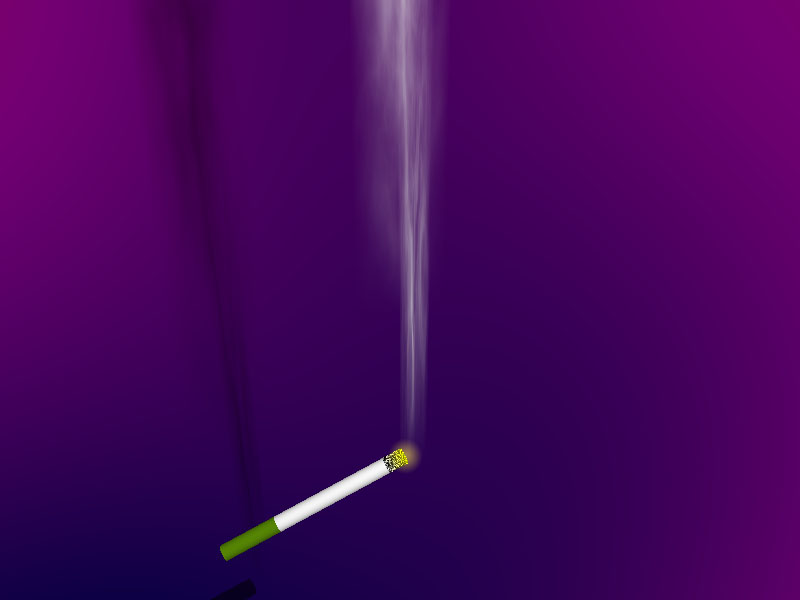

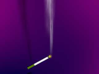

How's this look?  Just the smoke - not the cig.
Download 'smoketest.jpg' (21 KB)
Preview of image 'smoketest.jpg'

From: Massimiliano Cirri
Date: 31 Jul 2002 11:40:06
Message: <3D4804CE.6040508@ing.unifi.it>
Hi, really good modelling of the objects in the scene.
As for the smoke you shouldn't use a cone. It isn't right from a fluid
dynamic point of view.
The smoke should remain laminar for a while, I mean like a stream, then
it makes a kind of transition from laminar to turbulent. Is from this
point on that the smoke expands in a chaotic way.
Anyway really a great image.
Humm, didn't think of that. But the cone is just a container. The trick
is in my density function.
Thanks for the advices. I tried to take care of what everyone said, and
here is where I am right now.
Thanks a lot. But it's just a WIP ;)
Jul### [at] cnedraorg
http://www.cnedra.org
Download 'clope-08.jpg' (61 KB)
