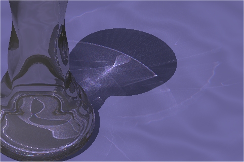

I've been working on my Gerbera-Image and tried
to use the dispersion of photons for a more realistic
look.
When tracing with a spacing of .0001 and using
a dispersion of 1.01, I get something around
40 million photons and the saved file is
over 750MB big.
Nontheless, the effect (though I've enlargened
the radius of a photon not by 5, as mentioned
in the docs, but by 7) is more or less useless.
It takes 2.5 hours to calculate the image, and the
result just isn't worth it.
Here's a close-up.
In case you're saying: "Well, THAT close..."
The image needs to be traced in extreme
sizes, so that I can print it with a very
good Laserprinter with incredible amount
of detail.
I'll be experimenting with three lightsources
(one for red, green and blue) and look if I
can get satisfying results that way.
Any comments, suggestions?

From: RAY
Subject: Re: Dispersion photons... No good...
Date: 21 Apr 2002 00:33:58
Message: <3cc24136@news.povray.org>
> look.
> over 750MB big.
40 Million? 4*10^8?  That's a lot.
> Here's a close-up.
> of detail.
Yes, jitter.

From: Tim Nikias
Date: 21 Apr 2002 06:04:56
Message: <3C99BE52.AF1A5F2B@gmx.de>
Caustics don't give the same look as photons do,
for obvious reasons.
I think I'll just stick to white photons and
leave the photons out. It's also very
probable that you don't observe this
kind of dispersion very much, and then
this tiny detail may be not worth the
parsing time (2.5 hours and doesn't look
good = more time perhaps better?)
Thanks for sharing your experience!

From: Tim Nikias
Date: 21 Apr 2002 06:05:48
Message: <3C99BE86.B70BF1D2@gmx.de>
You mean jittering the photons? I haven't looked
yet, but is that actually possible? I'll be looking at
the docs.

From: RAY
Date: 21 Apr 2002 10:08:28
Message: <3cc2c7dc@news.povray.org>
> the docs
The default amount of jitter is 0.4
[jitter <jitter_amount>]
Is in the 3.5 docs about photon mapping ( 6.10.2.1.) It's a global setting.
__________________
 RAY
