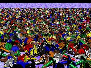

Hi Tracers!
After removing my additional 64 megs  module due to frequent crashes, I
tested the performance with the remaining 256 megs (on an AMD K6-II/380
MHz) by placing randomly 11, 000 of my plastic mouse wheels. Strangely,
there is a concentration of objects near the origin (camera location is
<0, 0.1, -0.4>, looking at <0, 0, 0>), though there are no quadratic
terms containing the random variable...
Rendering time: about 5:30 h, peak memory use: 309 megs
The next step would be a collision detector...
See you in Khyberspace -
http://www.geocities.com/electricafghan/index-e.html
Afghanistan Chronicle: http://www.ndh.net/home/bleimann/
Yadgar
Download 'mousewheel09.jpg' (293 KB)
Preview of image 'mousewheel09.jpg'
