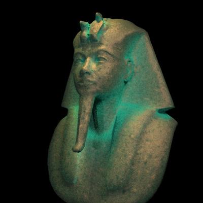

From: Kari Kivisalo
Subject: Patina/grime (40k)
Date: 30 Aug 2001 01:52:26
Message: <3B8DD549.D0A9588E@engineer.com>
Based on the accessibility of a surface location. No height fields
were used :P
_____________
Kari Kivisalo
Download 'patina.jpg' (42 KB)

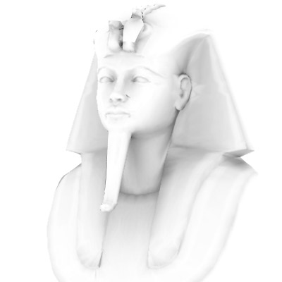

From: Kari Kivisalo
Subject: Re: Patina/grime (40k)
Date: 30 Aug 2001 05:59:16
Message: <3B8E0F26.6DDC17B3@engineer.com>
Couldn't tweak it any better so here it is. I rendered the "Arnold"
grime map from scene camera position using orthographic camera
and aligned in the scene to project from the camera position.
texture{
  image_pattern{sys "grime_map.bmp"}
  texture_map{
    [0.6 Grime]
    [1 Metal]
The problem with using radiosity to simulate accessibility
is that small surface variations on high visibility area get
outweighted by big low visibility areas. Some kind of local
equalization/high-pass operation would make it work better.
_____________
Kari Kivisalo
Download 'grime_map.jpg' (13 KB)
Preview of image 'grime_map.jpg'
Date: 30 Aug 2001 06:52:26
Message: <3B8E1B9A.E2D3E393@gmx.de>
> were used :P
I think Chris Huff was planning some pattern for this working similar to
the visibility pattern i wrote but sampling in various directions.
