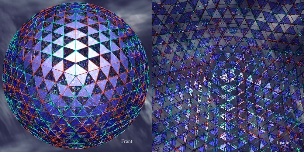

Not finished yet, I think it has potential.  Anyone want my spaghetti
code?
Dan Johnson
http://www.geocities.com/zapob
Download 'geodesic.jpg' (124 KB)
Preview of image 'geodesic.jpg'
From: Bill DeWitt
Subject: Re: WIP Geodesic Take two 124K
Date: 23 Jun 2001 07:36:54
Message: <3b347f56$1@news.povray.org>
I was playing with geodesics last week... what does your setup do?

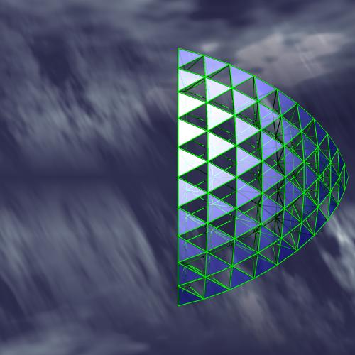

From: Dan Johnson
Date: 23 Jun 2001 08:30:44
Message: <3B348C48.83AA4B8@hotmail.com>
The basic function takes three points two define a spherical triangle.
Then it divides each of the sides evenly by a number you specify, and
stores them in a two dimensional array.
x
x-x
x-x-x
x-x-x-x
x-x-x-x-x
The x's are points in the array, and the lines represent how a function
might access the array to find the points of a triangle or edges.  I use
lots of little functions.  One to find points, one to store them in an
array, one to find edges.  I only generate 1/20 of the sphere, and then
rotate it to complete the job.  It also builds an octahedron -
tetrahedron spaceframe onto the group of triangles.  My translation
functions should be able to handle struts other than cylinders
appropriately, so I am trying to think about what I want to replace them
with.
Dan Johnson
Download 'geo_patch.jpg' (33 KB)
Preview of image 'geo_patch.jpg'
