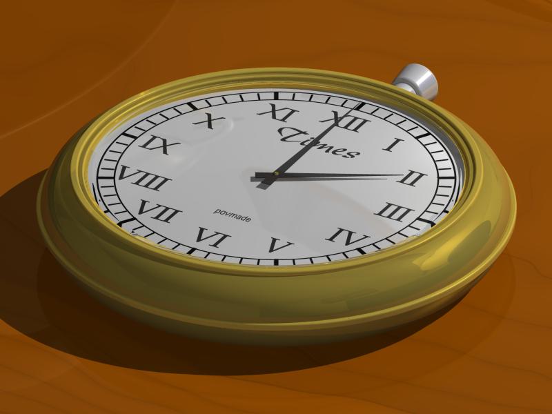

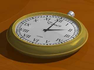

Done entirely within megapov. No images maps were used.
After trying with different normal settings, I decided to get rid of them.
Regards,  Alberto.
Download 'watch.jpeg.jpg' (40 KB)
Preview of image 'watch.jpeg.jpg'
From: Sander
Subject: Re: watch (40 Kb)
Date: 15 Apr 2001 11:56:50
Message: <MPG.1543e346aa97113f98973e@NEWS.POVRAY.ORG>
In article <3AD9B585.67F71E69@usb.ve>, Alberto says...
> Regards,  Alberto.
> [image/jpeg,Unknown Document]
Just MHO: the finishes are a bit dull and the knob to wind the watch
with would be rather difficult to operate - too slippery.
Regards,  Sander
From: Mick Hazelgrove
Date: 15 Apr 2001 16:17:39
Message: <3ada01e3@news.povray.org>
Try changing the background colour to either Blue/puple or even green. It'll
probably make the brass look brighter.
Mick

From: Chris Huff
Date: 15 Apr 2001 16:22:12
Message: <chrishuff-A97BCC.15192015042001@news.povray.org>
> them.
Set the ambient on the metal surfaces to 0, and give them more to
reflect, as well as more reflection and stronger highlights. The brass
texture looks dull, try increasing the reflection value.  Try to make
sure that ambient + diffuse + reflection <= 1 for most cases...
The watch would probably look better on a patterned surface, try putting
it on some wood, with a block of wood behind it. Another thing I often
do when testing metals: use a sky_sphere with a black-white wrinkles
pigment.
Christopher James Huff

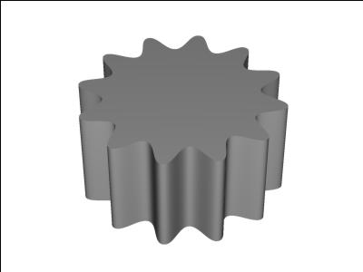

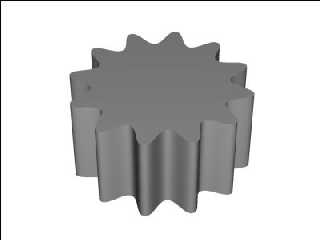

From: Alberto
Date: 15 Apr 2001 19:38:04
Message: <3ADA30A5.C8AEBCAA@usb.ve>
> Regards,  Sander
I agree with you. I'll change the knob, may be using a Bezier prism. I
hope to have a better image next weekend. If that's the case I'll post it.
Alberto.
Download 'knob1.jpeg.jpg' (6 KB)
Preview of image 'knob1.jpeg.jpg'
From: Alberto
Date: 15 Apr 2001 19:38:48
Message: <3ADA30D5.FB86BE8D@usb.ve>
hum... Interesting. I'll give it a tray. Thanks Mick.

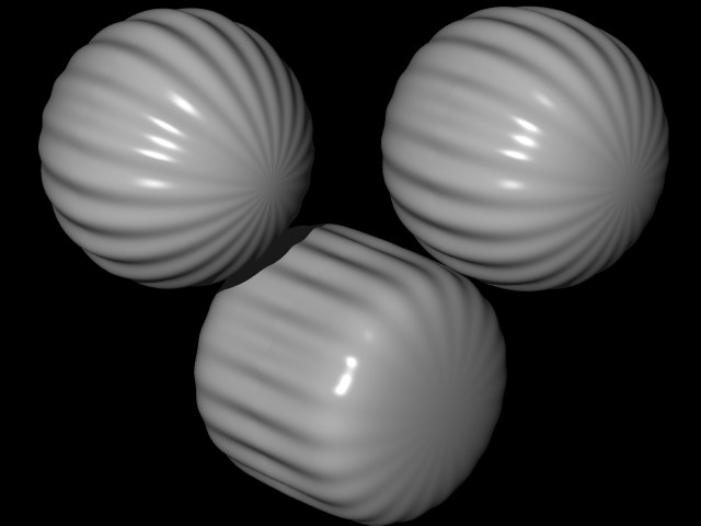

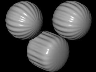

From: Jari Juslin
Date: 15 Apr 2001 20:16:28
Message: <3ADA39D9.1677B1C9@iki.fi>
How about using some isosurface? Your knob reminded me of that in
Isosurface Tutorial (on page
http://www.econym.demon.co.uk/isotut/builtin.htm) and I made few quick
trials. Source and results are below.
#version unofficial MegaPov 0.7;
default {
  texture {
    pigment { rgb <1,0,0> }
camera {
  location  <      16,     16,      10>
  sky       <    0.00000,     0.00000,     1.00000> // Use right
handed-system
  up        <        0.0,         0.0,         1.0> // Where Z is up
  right     <    1.35006,         0.0,         0.0> // Right Vector is
adjusted to compensate for spherical (Moray) vs. planar (POV-Ray) aspect
ratio
  angle         12.00000    // Vertical      24.750
  look_at   <      0,       0,      0>
light_source {
  <75, 50, 50>
  color red 1.0  green 1.0  blue 1.0  // light's color
#declare Theta  = function{"TH"}
isosurface {  // Spherical
  function{ x*x + y*y + z*z + sin(Theta*20)*0.05*(1-abs(y)) }
  method 2
  max_gradient 8
  threshold 1
  sign 1
  contained_by { box{ -1.1, 1.1 } }
  pigment {rgb 1}
  finish { phong 0.5 }
  translate <0.9, -0.9, 0.9>
isosurface { // Quadrical
  function { x*x + (y*y)*0.6 + (y*y*y*y)*0.4 + z*z +
  method 2
  max_gradient 8
  threshold 1
  sign 1
  pigment {rgb 1}
  translate <-0.9, 0.9, 0.9>
isosurface {
  function { x*x + (y*y*y*y*y*y) + z*z + sin(Theta*20)*0.05*(1-abs(y)) }
  method 2
  max_gradient 8
  threshold 1
  sign 1
  pigment {rgb 1}
  translate <0, 0, -0.9>
          /"\                           |    iki.
          \ /     ASCII Ribbon Campaign |    fi/
           X      Against HTML Mail     |    zds
Download 'iso_knob0.jpg' (24 KB)
Preview of image 'iso_knob0.jpg'
From: Alberto
Date: 15 Apr 2001 20:16:40
Message: <3ADA39B5.12818648@usb.ve>
> Chris Huff wrote:
> Set the ambient on the metal surfaces to 0, and ...
I think I've been raytraycing to much these days. I forgot the ambient
and brilliance settings.
Thank you Chris, your comments are of much use.
Alberto.
From: Alberto
Date: 15 Apr 2001 20:39:24
Message: <3ADA3F06.E4F972FA@usb.ve>
> Jari Juslin wrote:
> How about using some isosurface? ...
I think that the last one fits better my needs, but I'm not sure. Thank
you though.
Regards, Alberto.
From: JRG
Date: 16 Apr 2001 08:29:48
Message: <3adae5bc@news.povray.org>
Have a look to the finish settings in my metal textures in the
pov-scene-text-files. They work in most cases. And try brilliance 1.5 or up.
With a bit of work around the textures and the environment (try to add a
skysphere or a box) you'll get a neat image. Did you use radiosity?
jrg.

From: Alberto Mendoza
Date: 17 Apr 2001 13:35:44
Message: <3ADC7EA9.FF7AFDF1@usb.ve>
> pov-scene-text-files...
I downloaded your file.
> ... And try brilliance 1.5 or up...
I set the brilliance to 1.5 and ambient to 0 and I'm on track now.
> ... Did you use radiosity?
No I didn't.
Thank you for your help.
Alberto.
Date: 17 Apr 2001 13:54:39
Message: <3ADC830D.C5D82044@usb.ve>
Andrea Ryan wrote:
> Wow.  A watch face with no image maps seems difficult.  How was it made?  Is
> it made of cylinders, boxes placed with macros and text rotated so it faces
> up?  How about a chain or little dials?  It would be cool to make a
> grandfather clock with a dial that tells the phrases of the Moon.  Maybe it
> could use include files to render a clock set to the current time.  I jump
> between many projects and never get them done! :)
> Brendan
Well, the max_extent command was very handy to place the text. I used
the onion pattern to make the black circles and little boxes for the
hour-minute marks.
I don't think I'll do any more developments with this watch, as I feel
