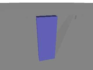

I started a scene for a new radiosity test and I had this strange
result...Where is the problem ? in my scene ? the result is the same
with or without radiosity...
           David
CODE:
#version unofficial MegaPov 0.6;  // MegaPOV 0.6A
global_settings {
  max_trace_level 15
  assumed_gamma 1.0
camera {
  location <-2.5, 10.0, -10.0>
  sky <0.0, 1.0, 0.0>
  look_at <0.0, 5.0, 0.0>
light_source {<-150.0, 50.0, -200.0> color rgb 1.0}
//==================== PROBLEM ============
sphere {
  <0.0, 0.0, 0.0>, 500.0
  pigment {color rgb 1.0}
  finish {ambient 0.5}
  inverse
//================== NO PROBLEM ===========
sky_sphere {pigment {color rgb 1.0}}
// ground
box {
  <-500.0, -0.5, -500.0>, <500.0, 0.0, 500.0>
  pigment {color 0.4}
  finish {ambient 0.0 diffuse 0.5}
// blue box
box {
  <-1.5, 0.0, -0.5>, <1.5, 8.0, 0.5>
  pigment {color rgb <0.25, 0.25, 1.0>}
  finish {ambient 0.0 diffuse 0.6}
Download 'artifact.jpg' (8 KB)
The problem is in:
> // ground
> box {
>   pigment {color 0.4}
Change 'pigment {color 0.4}' to 'pigment {color rgb 0.4}'
'color 0.4' expands to 'color rgbft 0.4' and thereby you get a partly
transparent floor.  The ghost shape appears on the lower level of the
ground box.
> ground box.
Thanks ! I didn't see it ! too bad...
