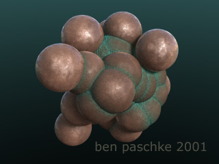

Hello good people,
Here is a test i made today using the proximity_pattern feature of
mpov07. The effect i'm trying to show is the simulation of oxidization
in the cracks of metal object. It could also be used to simulate dirt
and general wear-and-tear on any material.
Sorry for the boring geometry, but it seems to be demonstrating the
texture quite well - i can't wait to slap it on a real model.
The cluster of balls was declared as a union , then included in the
scene and then referenced by the proximity_pattern applied to the
cluster- pretty simple, really; i'm just heaps stoked that it can work
this way! And i'm not sure that i've seen something done with it like
this on p.b.i - please let me know!
It's only disadvantage is that the proximity_pattern is slowish to
render because of the noisy results. Samples here are about 20,  i used
+am2 +R3 and +a0.1, and the image took roughly 22 minutes to render on a
pIII450. I think it maybe an ideal way to assist in making patina image
maps which would be a whole lot faster.
I wonder if this is appropriate for HEDay's patina stuff?
Anyway, it is simple enough to set up yourself, so i won't burden you
with my abominable code.
You've just gotta remember to keep the proximity_pattern reference
object and the textured geometry in the same transformation context, if
that makes sense. I imagine it's the same case with the object_pattern,
too (so that the geometry and the pigment line up in space).
There is a camera rotation animation due tomorrow of this scene, and
i'll try to make it more clear how i actually did this.
ta
benp
and, remember, it's hip to be square.

From: Marc-Hendrik Bremer
Subject: Re: procedural patina (approx 19kbbu)
Date: 8 Mar 2001 07:02:29
Message: <3aa774d5@news.povray.org>
That looks really good!
Unfortunately I don't get how it works. Does it work, because the
proximity_pattern is not 100% accurate, or why? Perhaps you can offer some
very simple pseudo_code to show where you used which texture and such - I
really would like to know how it works!
The slow speed is a pity but I think it is worth it!
Marc-Hendrik
From: Ben Paschke
Date: 8 Mar 2001 18:33:33
Message: <3AA816FC.15061F31@rsp.com.au>
cheers!
..pseudo_code
#declare obj =
object{
//nice geometry ..
#declare dirty_texture{
//texture for the recessed regions
#declare shiny_texture{
//texture for raised regions
//..and then..
object{
obj //?-----include the object
   texture{
      proximity{//these are roughly the settings i used
               obj //?---------reference the same object!!
               .8
               samples 35
               //sample_weighting ?0,0,0>
               sample_bailout 10
               max_density 1
               type 0
               method 1
               sides 2    //needs to be 2 sided testing
      texture_map{
      [0 dirty_texture]     //?------innermost _map location
      [1 shiny_texture]   //?------outermost _map location
Should i not have posted this code here?
Does this make it a bit clearer? The key really is just using the same object
to reference in the proximity_pattern.
Anyway, pretty simple and general. Give it a go!
Now ijust need to test it with other objects! It wouln't be very useful if it
just worked on spheres!
benp
From: Ben Paschke
Date: 8 Mar 2001 18:59:44
Message: <3AA81D21.51EE56D4@rsp.com.au>
I've just had the thought (with all the other df3 discussions going on) that i
could create a patina df3 file from the proximity pattern and use that instead.
That is, if it proves to be any faster at all ...

From: Ben Paschke
Date: 8 Mar 2001 20:27:23
Message: <3AA831AC.827EBB9E@rsp.com.au>
great! that's a promising reply!
the thing with the low resolution of the df3 is probably ok, because it ads
the added luxury of being able to choose how fine you -need- it.
Most of the low res detail from the df3 could be overcome by using more
detailed textures in the pattern.
Another idea i had, a little excessive but would look great for stills, is
using eval_pigment() to place geometric dust and crust in the cracks. I'll
keep that in mind when i have a go at the df3.
Is the main memory hit with df3's just the fact that it's a volume? (ie
x*y*z values) I wonder how you could make a df3 optimised for use only on
surfaces.. There must be so much data going to waste (ie all voxels that
don't coincide with a shaded surafce) ...
BTW, i really like the idea of being able to blur patterns; i appreciate you
efforts! How's it going, anyway?
benp

Extremly nice spheres !
Please post the source.

hey, what about bad people?  j/k.  so i've started playing around with
proximity patterns thanks to you.  i'm getting some promising results.
i was wondering if you'd mind sharing the brown texture you used.  it
seems a lot more 'cloudy' than i've been able to get for an unrelated
project and i could really use a shove in the right direction.  also,
have you had time to test proximity patterns on 'real' objects yet?
this one i'm trying to do is taking forever.  there are about 100 (i
think) objects in my csg. that's not a lot in my opinion, so if it slows
down this much for 100, 1000, or more would kill me.  have you found
whether that has anything to do with render time?  my basic textures are
simple, so i can't imagine them to be the problem.  have you tried any
other variations?  how about messing with the numbers for samples, and
bailout?  how about the other types?  if so, maybe you could post
several small pics comparing the results.
thanks for your help.
