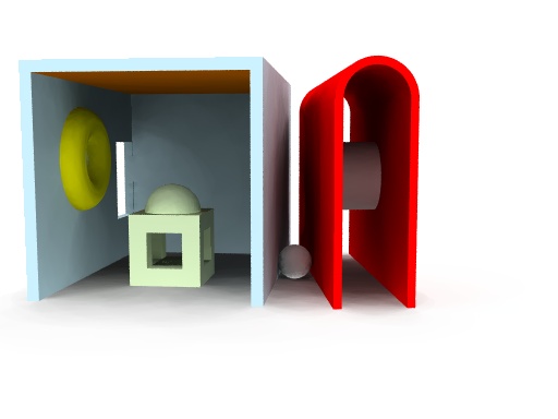

In another thread there was a discussion about whether a higher recursion
level would make the image look better in the "illuminating hemisphere"
scene. It was also questioned, whether it is possible to speed up the
radiosity calculations using the aid of area lights without changing too
much the resulting image.
  Well, I decided to try.

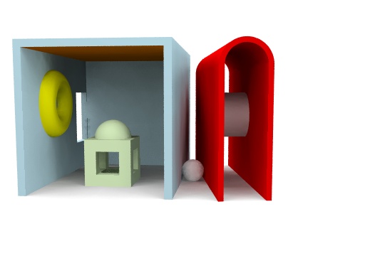

  The first image uses radiosity recursion level 1.
  The second image is the exact same scene file, with the only difference
being the recursion level changed to 2.

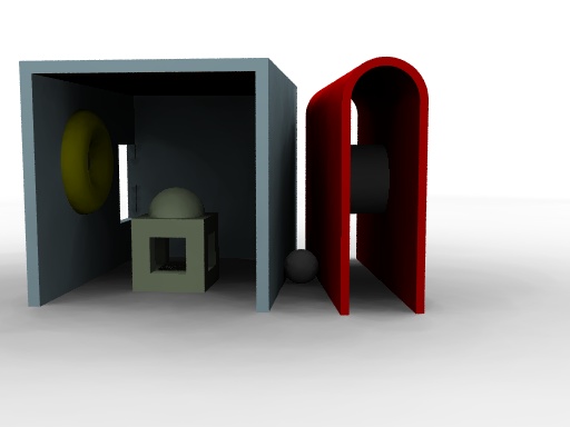

  The second image took about 1 hour and 5 minutes to render. I tried to
help the radiosity with area lights, so I created a hemicube of light
using 5 area lights and then reduced the radiosity quality settings to
speed it up.
  The resulting image is the third one. It took about 40 minutes to render.

Seems to prove at least one thing to me, that light sources are necessary to
get a good render when using radiosity.  The white floor plane however has
lost most of the shadows but that must be from the full coverage of
lighting.
The contribution of illumination from the objects themselves in the 2nd
rendering is rather artificial looking but otherwise shows that a recursion
of 2 really ups the radiosity.  Which leads me to ask, did you do a
recursion of only 1 with the lighting?

  Of course not. The whole idea with the third image was to compare it to
the second one, so it uses recursion level 2 as well. However, I had to
reduce the diffuse value of the objects to get the same brightness, but
that's not a surprise.
  By the way, the shadows around the objects in the recursion level 1 image
may look cool, but I think they don't correspond to reality and are in fact
an artifact caused by the unrealistically low recursion level.
  Of course sometimes an unrealistic effect can look artistically better
than the physically accurate result.

Where does the red on the *inside* of the box come from?
		Jérôme

I also see that in the second and third images, the ceilling looks red.
 11:06pm  up 11 days,  3:24,  2 users,  load average: 1.09, 1.09, 1.05
From: Tony[B]
Subject: Re: "Illuminating hemisphere" scene tests
Date: 2 Sep 2000 11:37:25
Message: <39b11eb5@news.povray.org>
Looks orange to me...

  I didn't use any light at all (in the first two images).
  My goal was to show that:
  1. The recursion level can have a drastical impact in the image if a
higher recursion level is needed to illuminate parts of the scene that
are not directly facing the illuminating object.
  As I undestand it, the second image is brighter than the first one because
the white floor reflects light to the other objects. At recursion level 1
this doesn't happen. Making the floor dimmer would have probably made the
illumination dimmer as well.
  2. When the radiosity calculations make the rendering very slow, you can
actually use area lights to speed up the rendering without any quality
decrease (you may experience even a quality increase since the direct
illumination is better).
  Someone gave the idea that using area lights is of no use since you get
a completely different image. The third image was made to test if this is
true. Well, it isn't.

So why is the floor so dark in the first image, then? If it's getting
its light from some sort of glowing sky or ceiling, which would seem to
be the case, then it should be just as bright as the floor in the second
image (given that light from the objects doesn't seem to have much
influence on the floor).
I'm inclined to think that this is a bug (and Kari's made comments to
that effect, IIRC), but I wonder what one could produce with some
parameter tweaking.
Your conclusion is pretty premature there, Warp. I don't see anything in
this scene that would depend on photons, specular reflections, "simple"
caustics, harsh direct illumination, or scattering media, the first four
