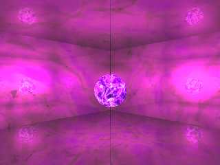

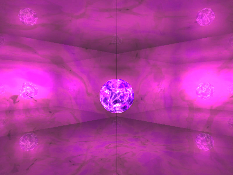

From: Wyldegod
Subject: Re: Black Sphere ???
Date: 23 Sep 2000 06:34:33
Message: <39CC8669.68E6C84B@juno.com>
Thanks for the input, Hugo.
Jack Daniels and I are just plain dumb this early morning.  I forgot the
texture in my declare when I declared it.  It works fine now so let me test
this connection and load the image.  I will keep your info in mind for
future renders as I learn more about the program.

congratulations on successfully posting an image!  welcome.
