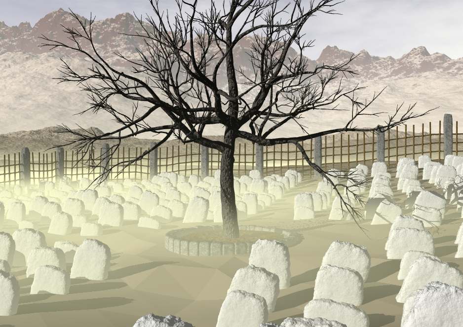

An old graveyard in dry, dead land.
Thanks to Andrew Clinton for his splinetree include.
Disnel

Most of these things you are probably aware of, and some may become
irrelavent as you develop the scene.
1. The fog on the ground is far too strong - particularily for such an arrid
land
2. The stones are too regular, both in the direction they lean, spacing and
overall shape.
3. The graveyard as a whole is a strange mix of abandoned and maintained.
Assuming abandoned, the fence and stone posts need some serious distressing,
as does the stone-border around the tree. Roots should be distorting the
border and the gravestones.
4. When/if you cut back on the ground fog, the ground is going to need some
more detailing.
Subject: Re: Graveyard - first stage (~100kB)
Date: 18 Sep 2000 07:48:07
Message: <39c600f7@news.povray.org>
A variance in stone texture would do good for this, they're all the same
color.  The fog looks like wind-blown dust so if you were to make that
turbulent it would be better.  fog_type 2 has the ability to do that, using
turb_depth, just takes some time to get right I always find.  Using octaves
1 or 2 with it is better than using 3 or 4 because the lower number is less
broken.  The only problem with doing such a thing with fog is that it never
seems to be gradual change.  Media would certainly be most controllable.
Maybe this is already media... looks like ground fog though.
Those people were either really short or were buried standing up.
Ron Parker   http://www2.fwi.com/~parkerr/traces.html

This looks promising.
I think the headstones need to be varied in design. The ground could use more
detail.
I might say make it a nightime scene but I don't wanna question your artistic
preference. :-)
They are in caskets ;-).
OK. You are right ;-).

Thanks for all reminders, I will use them for scene development.
They are the reason, why I posted this image here ;-).
