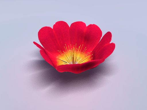

Trying to make it look more brilliance using double_illuminate and
brillance .5, diffuse .9
Download 'flower.jpg' (14 KB)

From: D J  Brown
Subject: Re: Flower
Date: 17 Aug 2000 20:05:24
Message: <399c7dc4@news.povray.org>
Very nice. Would you know where I'd be able to find a flower macro? I'm
looking for a realistic flower to put into my "Kitchen Visualization" and
this is about as realistic as I've seen here. Excellent work.
D.J.

From: Mike
Subject: Re: Flower
Date: 17 Aug 2000 21:17:45
Message: <399C8EB8.D0C91952@aol.com>
I thought about writing a macro to make the flower but figured it
wouldn't be quite the look I wanted since I modelled this from a certain
flower growing in my garden.  It's made up from patches modelled in
Animation Master and uses my uv mapping patch.  I uploaded a windows
binary of it to binaries.programming and the scenes files to
binaries.scene-files.
It's a lot of stuff to download but did it anyway in case you or someone
else would be interested.
-Mike
From: Peter Cracknell
Subject: Re: Flower
Date: 17 Aug 2000 21:19:04
Message: <399c8f08@news.povray.org>
Scaringly realistic, I'm assuming this is textured using image maps, how are
they positioned, planar? As I have problems using image maps on round
surfaces and is it an SPatch type model or clever POV coding?  Good work
Pete

From: Mike
Subject: Re: Flower
Date: 17 Aug 2000 21:39:19
Message: <399C93C7.B355A117@aol.com>
how are
uv mapped.
It's from animation master, similiar to sPatch but with mapping support
and many other features.  Clever POV coding perhaps and lots of POV code
hacking. :)
See my reponse to another post above for more info.
-Mike
From: Thomas Lake
Subject: Re: Flower
Date: 17 Aug 2000 21:39:50
Message: <399C94FC.A1C261DB@home.com>
Wow really good! To bad the JPEG compression hurt it so much. One comment I
have is that the central part of the flower, the stamens or are those pistils,
could never get the 2 strait, they look like they are just thin cylinders.
This hurts the realism a little.

From: Mike
Subject: Re: Flower
Date: 17 Aug 2000 23:06:11
Message: <399CA823.B210F463@aol.com>
Thanks.  I didn't notice how bad the compression was until after I
posted it.  Must be the old problem with lots of shades of red in a
jpeg.
>One comment I have is that the central part of the flower, the stamens
or are those >pistils, could never get the 2 strait, they look like they
The ones with the pollen on them...I don't know either.  You're right.
They are cylinders with spheres on the ends.  Look again at the flower,
the tops should be a little larger and fluffy looking.  I didn't get
around to making the center part yet.
-Mike

From: Fabian BRAU
Subject: Re: Flower
Date: 18 Aug 2000 04:08:58
Message: <399CEF03.CA967334@umh.ac.be>
> how are
> uv mapped.
Yes but you can have different uv mapping : planar, cylindrical,
spherical. Can I know more about it. Which procedure to follow
to get this texture?
Thanks,
Fabian.

From: Mike
Subject: Re: Flower
Date: 18 Aug 2000 05:14:30
Message: <399CFE73.B484F167@aol.com>
Well, by uv mapping I meant that the texture is mapped to the 2D space
of the surface, which in the case of a bicubic patch is typically a unit
square.
The texture as much as it shows with the bad jpeg compression could
pretty easily be achieved with a gradient y pigment.  But to get
specific about what I did here, I wrote a patch for MegaPOV that does uv
mapping for type 2 bicubic patches.  Then I changed the uv mapping code
to calculate a 3x3 homogenous mapping matrix using the 4 corners of a
quadrilateral (the uv vectors) assuming the patch space is a unit square
and having the homogenous coordinate set to 1.  This matrix is used each
time a ray intersects the surface of the patch by tranforming the u and
v location of the patch at the current intersection to texture space (or
maybe the other way around).
Then I updated the pov-ray exporter for Animation Master available at
http://free.prohosting.com/~olana/plugins/plugins.html to write the
texture coordinates in pov format using the new syntax.  To keep things
fast, I write a seperate include file with the textures needed for the
model, otherwise each image would be parsed for each patch and it would
take forever.  The new plugin hasn't been released yet though.  The
problem is that I think I'm near the limit of my ftp space and can't
upload everything there.
It's plausible that this could be done by hand but I wouldn't want to.
Some macros could probably be made to create the uv vectors, or in the
case of sPatch models you could use a find and replace to add uv vectors
that are a unit square, thus allowing for the mapping of a tilable
image.
I uploaded a copy of the windows binary with the new uv mapping and
included a short text file explaining how the uv_vectors relate to the
texture and the patch.  It's in povray.binaries.programming.  You should
be able to render the scene files I uploaded to binaries.scene-files
with it.
As an example, here's what one patch looks like:
bicubic_patch {
type 2
accuracy 0.1
uv_vectors <0.5475359559059143, 0.9598205089569092>,
<0.5189526081085205, 0.960773766040802>, <0.615035891532898,
0.7563253045082092>, <0.7078137397766113, 0.7766876816749573>
<1.239059209823608, -0.01280438248068094, 1.6783527135849>,
<1.065836906433106, 0.1083308532834053, 1.747843623161316>,
<0.8545190691947937, 0.1975981742143631, 1.807306289672852>,
<0.645129919052124, 0.2410857826471329, 1.846774458885193>,
<2.281259059906006, 0.2899681329727173, 2.865853786468506>,
<2.073765516281128, 0.5121513605117798, 2.92615818977356>,
<1.813590884208679, 0.7627856731414795, 2.980928659439087>,
<1.548043966293335, 0.8501358032226563, 3.049945831298828>,
<3.277821063995361, 0.9094398617744446, 4.084438323974609>,
<3.087475061416626, 1.274701952934265, 4.069855690002441>,
<2.652498245239258, 1.616940975189209, 4.161567687988281>,
<2.316552639007568, 1.618627786636353, 4.310638427734375>,
<4.087599754333496, 1.740859031677246, 5.157229423522949>,
<3.848036289215088, 2.162004947662354, 5.15593147277832>,
<3.304417133331299, 2.48495364189148, 5.332837104797363>,
<2.897367477416992, 2.485338926315308, 5.533927917480469>
uv_mapping double_illuminate
texture { Base0 }
normal { Decal0 }
interior { Interior0 }
(now that I look at that, I could probably save space by lowering the
precision)
and here's the textures I used.
#declare Base0 =
 texture {
  pigment {
     image_map {
     tga "petalcolor.tga"
     once
     interpolate 4
   scale <1, -1, 1>
   translate 1*y
     finish {
     ambient 0
     phong .9
     phong_size 40
     brilliance .5
     diffuse .9
     reflection 0
     metallic
#declare Interior0 =   interior { ior 1 }
#declare Decal0 =
   normal {
     bump_map {
     tga "petalbump.tga"
     once
     interpolate 4
     bump_size 2
   scale <1, -1, 1>
   translate 1*y
Probably way more than you wanted to know.  Sadly, this is something
I've spent way too much time on and yet have a hard time explaining it
to anyway.  None of the hash users want to be bothered with POV-Ray
(they all want me to work on the RIB exporter tho none of them know jack
about RIB. grrr).  Then when I mention Hash here it's like everyone
thinks I've been smoking the stuff...still, I've been having a blast
with all these low-tech tools I've cooked up. :-)
> image.
> with it.
> bicubic_patch {
> type 2
> accuracy 0.1
> texture { Base0 }
> normal { Decal0 }
> precision)
> #declare Base0 =
>  texture {
>   pigment {
>      image_map {
>      once
>      interpolate 4
>    scale <1, -1, 1>
>    translate 1*y
>      finish {
>      ambient 0
>      phong .9
>      phong_size 40
>      brilliance .5
>      diffuse .9
>      reflection 0
>      metallic
> #declare Decal0 =
>    normal {
>      bump_map {
>      tga "petalbump.tga"
>      once
>      interpolate 4
>      bump_size 2
>    scale <1, -1, 1>
>    translate 1*y

Right thanks, I think I'm a few (hundred) leagues below this, one day you'll
create a SPatch model and someone will create a nice little app that takes
the file and exports one simple image which you can paint on and UVMap
within Moray (though Moray doesn't currently support non-official stuff).
Until then I'll probably leave UVMapping - I have ago with UVMapper but it
confused the hell out of me!
Pete
Mike <Ama### [at] aolcom> wrote in message news:399CFE73.B484F167@aol.com...
> square.
> image.
> with it.
> bicubic_patch {
> type 2
> accuracy 0.1
> texture { Base0 }
> normal { Decal0 }
> precision)
> #declare Base0 =
>  texture {
>   pigment {
>      image_map {
>      once
>      interpolate 4
>    scale <1, -1, 1>
>    translate 1*y
>      finish {
>      ambient 0
>      phong .9
>      phong_size 40
>      brilliance .5
>      diffuse .9
>      reflection 0
>      metallic
> #declare Decal0 =
>    normal {
>      bump_map {
>      tga "petalbump.tga"
>      once
>      interpolate 4
>      bump_size 2
>    scale <1, -1, 1>
>    translate 1*y

Wow, this is good! It's begging for a real background.
