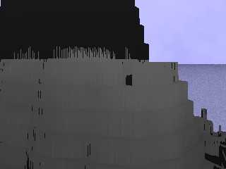

I remember having seen a message regarding this problems already, but
can't seem to find it.
Just look at the image - why can't a make a smooth HF?!!
Download 'nland.jpg' (25 KB)
Preview of image 'nland.jpg'
From: Lewis
Subject: Re: HF problems
Date: 15 Aug 2000 08:14:31
Message: <39994125.E90EA96B@ss.com>
BTW the resolution is not the problem - it's 2000 * 2000...

From: Kari Kivisalo
Date: 15 Aug 2000 08:29:56
Message: <399937DA.8851B5F9@kivisalo.net>
This must be 8bit hf, try 16bit tga.

From: Lewis
Date: 15 Aug 2000 08:46:19
Message: <39994891.DAC8B978@ss.com>
I am having trouble creating the HF as a 16-bit grayscale. It has 256
colors (8 bits) but I can't get more for some reason. How do I ??
Date: 15 Aug 2000 08:54:26
Message: <39993d82$1@news.povray.org>
"Lewis" <tt### [at] sscom> wrote in message news:39994891.DAC8B978@ss.com...
Since you have a 24 bit targa there the thing to do probably is to use it as
a pigment {image_map{}} and do a global_settings {hf_grey_16 on} to get it's
16 bit greyscale.  Only problem might be if it's not already a greyscale
image the conversion of the colors just might go wrong for what you have
intended, but I'm not sure of that.
Anyway, if you're willing to go that route then just use a orthogonal camera
with the same up and right as the image resolution, mapping to a plane of
course.  Also set the file output type to +FT so you don't get a BMP or
something.
Date: 15 Aug 2000 09:01:05
Message: <39993F32.CE2D2889@schunter.etc.tu-bs.de>
As Bob said, you should use "hf_grey_16 on" when generating the heightfield with
Povray. With png output, you have to use +fn16 to get 16 Bit grayscale output.
IIRC the black parts in the heightfield are a known problem, there were some
posts about that in the past:
from p.a-u:
Topic: Height field bug?
Date:  Fri, 28 Apr 2000 23:00:46
from p.b.i:
Topic: height field problem - 2-11K jpegs
Date:  Wed, 31 May 2000 21:33:19

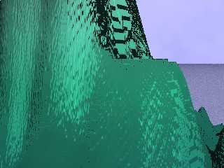

From: Lewis
Subject: NEW HF problems
Date: 15 Aug 2000 09:24:03
Message: <39995164.8BA17532@ss.com>
Thanks, it works.
However, I still can't understand what's the problem with MY source.
Further more, this is what comes out when I try to use that output in
the HF scene:
Download 'nland.jpg' (10 KB)
From: Lewis
Subject: forget it!
Date: 15 Aug 2000 09:30:37
Message: <399952F3.3B89E41B@ss.com>
It was the wrong file. Thanks for all the help.
