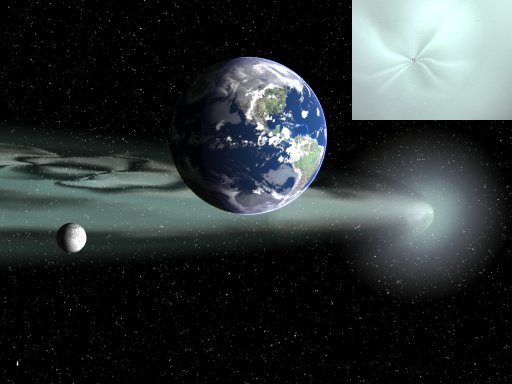

Yes, media... if you haven't already guessed.
Same old story, try as I might it's always a battle to get such a thing
"right" and this is as far as I've gotten with this one.
The inset is the nucleus region.  Of course it's actually there in the wide
view too  :-) just a bit tiny, the ice chunk being about 50 km wide at most.
The comet is about 4 times more distant than the Moon and the camera angle
(or telephoto zoom?) is at set to 5 in order to get a sufficient scaling to
everything.
I think anyone will notice how the star background is enhanced at the coma,
part of my troubles getting absorption, emission, scattering, density all
together.  Take off your eye glasses if you were them and get way back and
it will look fine, possibly   B-}
P.S.  don't tell me I could get a ready-made comet out of the Galaxy
Include.  I wanted to try on my own anyhow.
omniVerse http://users.aol.com/persistenceofv/all.htm
Download 'nearearthcomet.jpg' (33 KB)
Preview of image 'nearearthcomet.jpg'
From: Anton Sherwood
Subject: Re: Near Earth comet try (fail?) [~45KB Jpg]
Date: 13 Aug 2000 14:35:14
Message: <3996EC00.3F38CB4D@pobox.com>
I haven't seen swirls like that in a comet's tail.
By the way, the Moon's surface is much dimmer than that in comparison to
the Earth;
here are two shots that contain both:
http://antwrp.gsfc.nasa.gov/apod/ap950629.html
http://antwrp.gsfc.nasa.gov/apod/ap980904.html
(from the archive of Astronomy Picture of the Day)
Anton Sherwood  --  br0### [at] p0b0xcom  --  http://ogre.nu/
From: Dave Blandston
Date: 13 Aug 2000 15:46:29
Message: <3996fb15@news.povray.org>
"Bob Hughes" <per### [at] aolcom?subject=PoV-News:> wrote in message
news:3996e1bf@news.povray.org...
The comets in the Galaxy Include File don't use media, so you're still
breaking new ground! This looks very good, Bob.
-Dave
Date: 13 Aug 2000 16:15:10
Message: <399701EC.DCC26B3C@schunter.etc.tu-bs.de>
It looks pretty good IMO, i'm just wondering about the turbulence in the tail, i
think gases normally go just strait away from the nucleus.  Maybe the nucleus
could also be a bit brighter in contrast to the tail.
I much like the clouds of your earth, are they image mapped or made with Povray
From: Jetlag
Date: 13 Aug 2000 22:45:55
Message: <39975d63$1@news.povray.org>
I may be wrong, but I don't believe stars should be visible. Either that or
Earth should be completely washed out. If you can find a photograph that
shows otherwise I'd like to see it. Oh and shouldn't the comet have two
tails (unless its headed straight for the sun)?
Btw, nice render.
Date: 14 Aug 2000 01:58:06
Message: <39978a6e@news.povray.org>
"Anton Sherwood" <bro### [at] poboxcom> wrote in message
news:3996EC00.3F38CB4D@pobox.com...
The tail was at first fairly featureless, but I wanted to get a chaotic one
for this.
I was going to put a link to a good example of comets here but didn't find
any really fine photos, Hale-Bopp abounds on the internet apparently, and
most are homegrown pictures, so I gave up.  I believe Comet Halley might be
a good example of a turbulent tail although what I have seen is more
streamer-like.  I should probably do a little more research anyway.  The
coma area might be totally wrong for that matter and should perhaps not be
extending beyond the width of the tail itself at that point.
The real difficulty is getting a unaided eye appearance, all guess-work.
| the Earth;
I know, accept to brighten the Earth up so much in relation to the Moon
looked wrong, or would look wrong to the casual viewer anyhow.  I had a
dimmer Moon too and that's the same circumstance.  So I compromised and went
with unreality (easiest!).
Date: 14 Aug 2000 02:18:20
Message: <39978f2c@news.povray.org>
"Christoph Hormann" <Chr### [at] schunteretctu-bsde> wrote in
message news:399701EC.DCC26B3C@schunter.etc.tu-bs.de...
tail, i
nucleus
I believe you are right about that.  I was going on the idea of bursts of
activity, almost like on/off gases.  Just not so sure yet if that is
correct.  Will have to do more looking around at actual photos.
Povray ?
Cloud image mapped onto a slightly larger sphere than the Earth surface one.
Not a greatly detailed one but it's better than trying to make that at the
same time as dealing with the comet creation.
For planetary maps have a look at this site:
http://www.lancs.ac.uk/postgrad/thomasc1/render/render.htm
Date: 14 Aug 2000 02:29:49
Message: <399791dd@news.povray.org>
"Jetlag" <bga### [at] microsoftcom> wrote in message
news:39975d63$1@news.povray.org...
or
Hi there, glad you liked it despite the shortcomings  :-)
Yes, I know, two tails.  One for dust, other for plasma, I think is how it
goes.  But I was having a tough enough time merging together the inner and
outer coma and tail as it was.  Some comets like Hale-Bopp had a great
separation of the two.  Halley's seems to not have had any from what I saw
while looking at a few photos.
Not really going for a photographic look to begin with actually.  That would
make for a oversaturated coma and very bright tail.  Along with the washed
out Earth, as you said.  Think unreal realism  :-)  Well, whatever...
Maybe I can get it looking better later, maybe not.  This is not the sort of
thing I find easy to try since it's not totally fantasy and not completely
humanly observable.

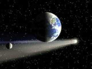

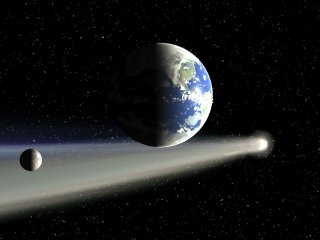

Subject: Re: Near Earth comet 2nd try [~17KB Jpg]
Date: 14 Aug 2000 09:39:23
Message: <3997f68b@news.povray.org>
Here's a changed version.  Added the ion tail and smoothed out the dust
tail, even made the coma smaller.  It can't be perfect I don't think, only
better and better (or worse, depending).
Want to credit Constantine Thomas, Kari Kivisalo, and James Hastings-Trew.
I just now got the Earthpng.zip file at Constantine's site which I
previously posted a reply to Christoph Hormann about.  I believe I had been
using the maps from David Seal's site before: http://maps.jpl.nasa.gov/
Download 'nearearthcomet2.jpg' (13 KB)
Preview of image 'nearearthcomet2.jpg'
Date: 14 Aug 2000 10:46:56
Message: <39980680.C82C85D4@schunter.etc.tu-bs.de>
better i think, just the tail should somehow thin out in the distance.
Now that's nice. Tail looks a bit long relative to the size of the
earth.  Maybe move the commet further from the earth.
Gail
| earth.  Maybe move the comet further from the earth.
Thanks, but it's titled Near Earth Comet   :-)  As I understand it comets
can be quite large objects overall.
I think you and Christoph are right though, it needs some fading out as it
goes toward the far end.  It does at the very end, many times the length you
can see here, but not in a good way.  At the same time I need to get a
curvature for the dust tail too.  Somehow, someway.

Looks better, but shouldn't the tail fade out in back?

news:39982C4B.44338637@faricy.net...
More like this one.  I know it's a tiny image, just still ferreting this
thing out.
Oops:  http://antwrp.gsfc.nasa.gov/apod/ap960319.html

Yeah, I had seen that one after your first reply when looking for comet
pictures to see how I was doing with my ray traced one.  Surprisingly, most
pictures I found were black and white and not too great.
Hey, you want to see a fantastic photograph of a comet though?
http://comets.amsmeteors.org/comets/lcomets/1995o1.html
Spectacular image of Hale-Bopp.  I just now found it.  I was thinking before
that only the dust tail could appear to swirl about from changes in the
ejection of material from the nucleus as it rotated to show a different side
to the sun.  Thought the ion tails of comets were generally straight and
featureless.  Boy was I wrong.
I'll probably try to mimic this Hale-Bopp photo most of all, it's so
visually appealing.  Just need to get a idea of what's in that saturated
white area the time exposure cleared out.  I saw Hale-Bopp through a small
4" scope so I guess it wasn't clumpy but did have some directional features
in the coma area.  I looked at some of those Halley space probe pictures
recently too; very fuzzy stuff.  Maybe I'll just see what happens.
