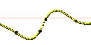

I want a smoothly varying function that goes between the following
points:
    <0.00, -15>,
    <0.25, -125>,
    <0.45, -110>,
    <0.50, -10>,
    <0.75, -25>,
    <1.00, -15>
The function/ spline will serve as a keyframing notation for the joints
in a body, ala < timei , thetai >. Such that if I call out 0.375 for the
x, I should get something not too far from 117.
My own "cosinespline" is inadequate (see 04/14/00 posting) :  not much
better than straight lines.  Chris Colefax's macro has a ton of options
which offer some promise, but it is woefully lacking an adequate
explanation of what he dreamed up. I'm suspecting it cannot even handle
an irregular list like above.
Can anyone help me?
Download 'cossplinevscubic.jpg' (27 KB)
Preview of image 'cossplinevscubic.jpg'

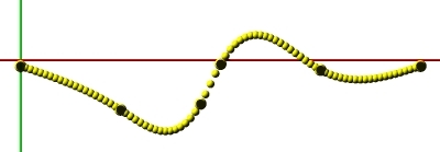

From: Libellule
Subject: Cubic spline mentioned above 18kbbu
Date: 11 Aug 2000 00:25:02
Message: <3993804F.36A34A26@insectes.net>
Using the data in the original post
(Solved externally)
Data points shown with slightly larger spheres than the rest
Download 'cubicspline.jpg' (18 KB)
Preview of image 'cubicspline.jpg'
From: Greg M  Johnson
Subject: Re: Cubic spline mentioned above 18kbbu
Date: 11 Aug 2000 09:23:50
Message: <3993FD39.52D9976@my-dejanews.com>
This is actually supposed to be the rotation of a knee across a walk cycle. In
your solution, which is very similar to mine, the knee would be bending
backwards (theta>>0) during part of the cycle.  If you look at my solution in
the blue curve that I posted, it is devoid of the above error, but so flat it
is not much  better than straight lines.
Subject: Re: Is there a spline solution out there?
Date: 11 Aug 2000 09:28:15
Message: <3993FE3D.6C69C2D@my-dejanews.com>
I think the green and/or red curves are typical of what one sees with the mega
splines.
I think Colefax's spline has lots of neat knobs & levers, but no explanation
in the available tuts.
Date: 11 Aug 2000 14:33:10
Message: <399445AE.EB50AD7F@my-dejanews.com>
Looks brilliant, but:
0) I assume I need a defined array of Points, right?
1) you didn't define Bias anywhere, and this gives me an error.
2) how would I call the points from it??
Jerry Anning wrote:
> On Fri, 11 Aug 2000 09:19:42 -0400, "Greg M. Johnson"
> <gre### [at] my-dejanewscom> wrote:
> >Thanks, but I want it to work WITHIN pov. It's the angle of rotation of a knee in a
> >walk cycle.  This is come kind of "C" code, no?
> Here are the key guts of a Tau spline implementation within pov.  The
> Tau spline is a Catmull-Rom spline with tension and bias parameters.
> This means that:
>  it will pass through the control points
> you can control how much it bends (and how smooth the curve is) with
> tension
> you can control which end of a segment the maximum bend is near with
> bias.
> Incidentally, the cubic interpolation (cerp) and Horner's method
> (horn) macros can create many other spline types with an appropriate
> control matrix.  You should be able to figure out the rest from here.
> If not email and I will send you a full demo as health permits.
> This expects your control points to be in the array Points and  Bias
> and Tens to be (0 to 1) variables already declared.  The other
> variables are either obvious or irrelevant material from the original
> project.
> // begin partial code snippet
> #macro Mxv(In, Mx)
>   <max(In.x, Mx.x), max(In.y, Mx.y), max(In.z, Mx.z)>
> #end
> #macro Mnv(In, Mn)
>   <min(In.x, Mn.x), min(In.y, Mn.y), min(In.z, Mn.z)>
> #end
> #declare Tau = array[4][4]
>     { (Bias - 1) * Tens, 2 - Bias * Tens, (1 - Bias) * Tens - 2, Bias
> * Tens },
>     { 2 * (1 - Bias) * Tens, (3 * Bias - 1) * Tens - 3, 3 - Tens,
> -Bias * Tens },
>     { (Bias - 1) * Tens, (1 - 2 * Bias) * Tens, Bias * Tens, 0 },
>     { 0, 1, 0, 0 }
> #macro Horn(Row, Pt)
>   (T * ( T * (T * Tau[0][Row] + Tau[1][Row]) + Tau[2][Row]) +
> Tau[3][Row]) * Pt
> #end
> #macro Cerp(Pf)
>   Horn(0, Points[Pf - 1]) + Horn(1, Points[Pf]) +
>   Horn(2, Points[Pf + 1]) + Horn(3, Points[Pf + 2])
> #end
> union
>     #declare Iter = 1;
>     #while(Iter < Dim + 2 * Close)
>       #declare Count = max(1, int(Fine * vlength(Points[Iter + 1] -
> Points[Iter])));
>       #declare Incr = 1 / Count;
>       #declare T = 0;
>       #while(T < 1)
>         #declare Start = Mxv(Mnv(Cerp(Iter), <24 * Aspect, 24, 24>),
>                          <-24 * Aspect, -24, 0>);
>         #declare T = T + Incr;
>         #declare End = Mxv(Mnv(Cerp(Iter), <24 * Aspect, 24, 24>),
>         #declare End = ((End.x = Start.x) ? End + <.001, 0, 0> : End);
>         sphere { Start, Width }
>         cylinder { Start, End, Width }
>       #end
>     #end
> // end partial code snippet
> Jerry Anning
> clem "at" dhol "dot" org
Does a knee really bend to 125 degrees in walking?
> In your solution, which is very similar to mine, the knee would be bending
> in the blue curve that I posted, it is devoid of the above error, but so flat
> it is not much  better than straight lines.
Wish you'd said in the first place that you want the spline to stay
below zero.
One way to do that is to square some function that crosses the axis in
the segment where you want tangency.  Thus, for the segment 0.50 < t <
0.75, we take y=square(4*(t-1/2)*(sqrt(25)-sqrt(10))-sqrt(10)).  Then
spline the remaining segments to match the slopes of this parabola.
Of course you could fit a periodic function to
	0.00	sqrt(15)
	0.25	sqrt(125)
	0.45	sqrt(110)
	0.50	sqrt(10)
	0.75	-sqrt(25)
	1.00	-sqrt(15)
	1.25	-sqrt(125)
	1.45	-sqrt(110)
	1.50	-sqrt(10)
	1.75	sqrt(25)
	2.00	sqrt(15)
(where the left column is multiples of pi), square that, and use it at
half frequency.
Anton Sherwood  --  br0### [at] p0b0xcom  --  http://ogre.nu/

1) Yes, you declare and define Points - the array of control points
for the spline, not the points along it - before you call the macros.
2) Likewise, you declare and define Bias and Tens before you create
the Tau matrix.
3) Points, as I said, is the control point array, not an array of
output points.  Calling Cerp(Iter) gives the current output point.
I am a bit more coherent today, so here is a cleaned up  and expanded
version of the above code with some more explanation of the variables
and operation.  Note the additions.  The material I removed in this
version has to do with constraining the curve, adjusting the aspect
ratio of the output, dealing with closed curves and other things
irrelevant to the point.
Iter determines which pair of control points you are running the curve
between at the moment.
T determines how far along you are between those control points at the
moment.
The business with Fine and Count decide how many sphere and cylinder
pairs you will draw between each pair of control points.
If you just want to return points along the curve for later use, strip
off the union in the last section and remove the parts about End, and
the sphere and cylinder declarations.  Start will be a point along the
output curve.
