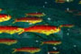

image map are showing the color specified in the background{} statement, as
shown in the image below, instead of the color behind it.  My goal is to
make a section of my image map simply 100% transparent other then by using a
.gif.  Is there something I'm doing wrong or is there some characteristic of
alpha channels that I'm not yet aware of?
-Chris-

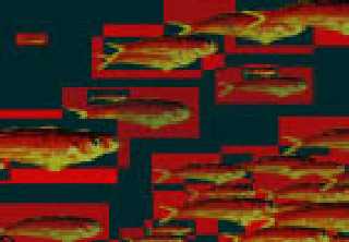

Sorry, this image should help.  In this image I made the background color
red.  Also, there is a blue/green fog.  the transparent sections of the .png
seem to ignore the fog, although where they overlap they show the correct
color of the fog...?
I'm using MP 0.5.  With .gif support gone I'm at a loss at what to do...
Making the background color the same as the fog is only a temporary fix and
still leaves a similar result as below when the map is in front of objects
other then the fog.
-Chris-

I'm guessing you are using infinitely-thin boxes or polygons to make the
fish? If so, POV may think it is "inside" one after hitting it, and
"outside" after hitting another, so the fog is only calculated if an
even number of fish are hit. Try making the fish hollow(so fog is also
calculated "inside" the fish), this might prevent it. Also, make sure
you have a max_trace_level large enough to get past all the fish.

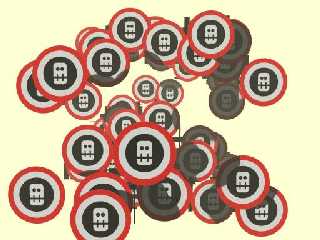

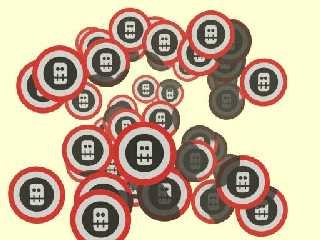

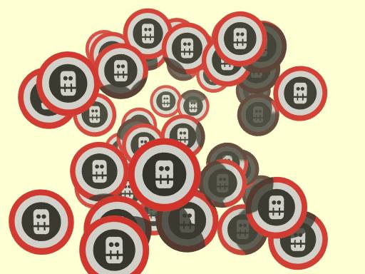

Try putting max_trace_level 50 (or higher) in the global_settings{} block of
your scene.
Attached are some pics which may help.  The first shows a scene without any
max_trace_level, the second with it set at fifty.  Spot the differenence.
The last two show the png image used, and it's mask/alpha channel.
The image was mapped onto a box using the following code:
#local alpha_thing=box {-0.5 0.5
  texture {pigment {image_map {png "robo_head" map_type 0 once}
translate -0.5}}
  scale <1,1,0.0001>
The scene was rendered using MegaPOV0.5a, if that makes a difference.
Hope this helps,
Alan.

Maybe a finite-vs-infinite fog problem? Try putting something behind the
fish, so the background isn't an infinite distance away.
From: Chris S
Subject: Re: Alpha Channel Help
Date: 3 Aug 2000 20:04:16
Message: <398a0880@news.povray.org>
Chris Huff <chr### [at] maccom> wrote in message
news:chrishuff-6B1410.18282603082000@news.povray.org...
> In article <3989f626$1@news.povray.org>, "Chris S."
> <chr### [at] bluelectrodecom> wrote:
> > Thanks, but no change.  I tried using the hollow boxes...no luck.
> > Triangles and polygons still show the same problem...
Already tried, no good.  It actually seems to be showing up properly against
the fog, but incorrectly with foreground images.
-Chris-

I'm not an expert at paint packages, but it looks to me as if your included
image has transparency set for every color within the image. Is this what
you meant to do? I think you would achieve the effect you are after, if you
would set the background of your image as transparent, only.

Well, yeah, that would be the ideal solution...but PS removes any
transparent backgrounds when the file is not saved as a .psd.  As to all my
colors being transparent...if you rendered the file in p.b.s-f the fish part
is showing where the background is "general" not.  The problem I seem to be
having is the background, which I want 100% transparent, is at points
showing up less then 100% creating slightly light boxes appear around the
fish.
I guess I'll live but this problem sure is annoying...

        Have you tried using a 32-bit targa (TGA) file?  I
was working with alpha channels back and forth between
PovRay and PhotoShop and found that PNGs didn't work but
32-bit TGAs did.
        To make and save a TGA with an alpha channel in
PhotoShop is a PITA but it *is* possible and povray reads
the resulting file correctly.
